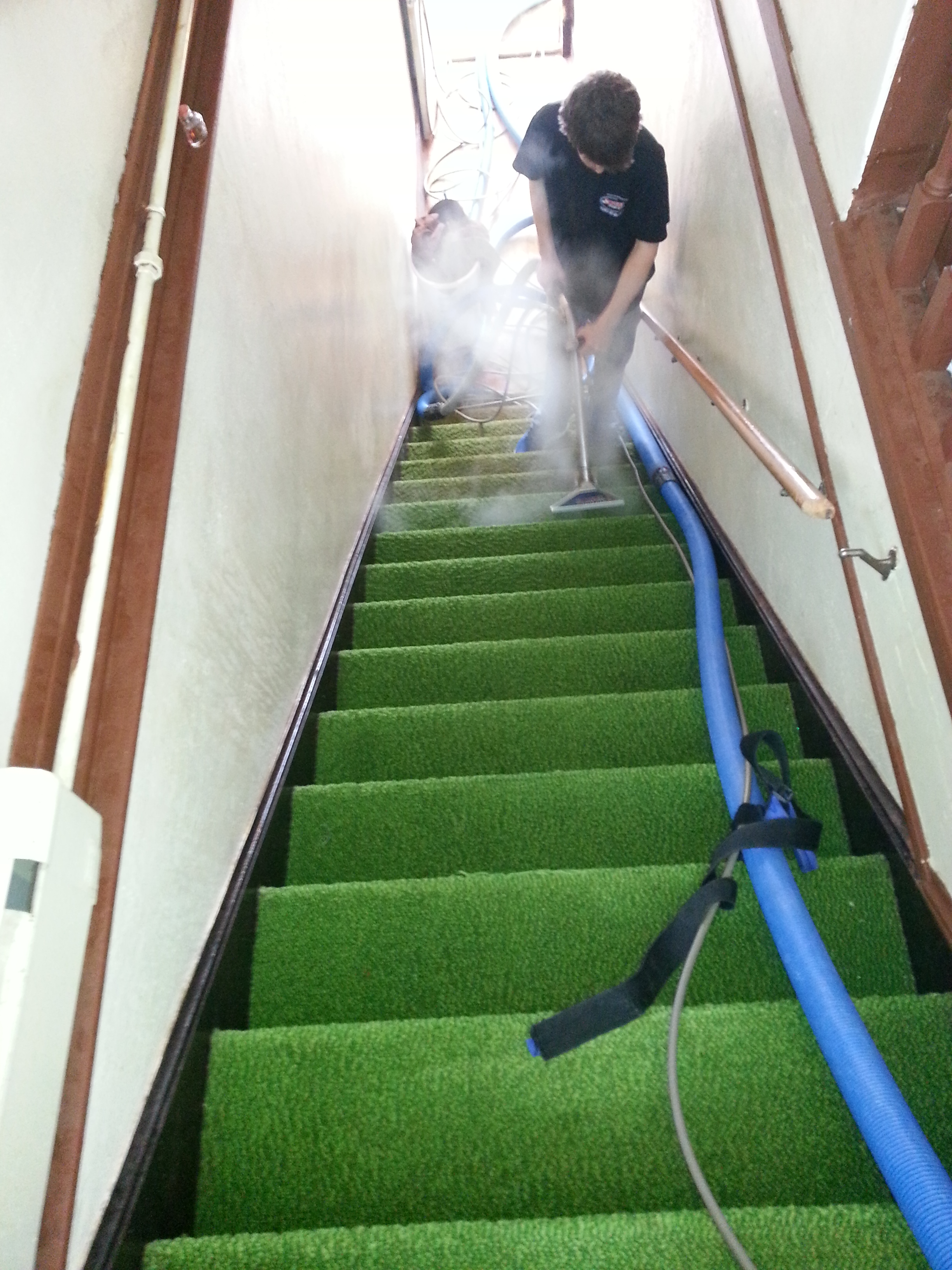

I know everyone has a method to cleaning stairs.
Some use their large wands...
some use small stair tools....
some use their upholstery tools....
I know some of you hate this style wand (and I am not a fan of swivel head wands except for our stair tool)
It seems also the smaller the tool, the more opinions there can be.

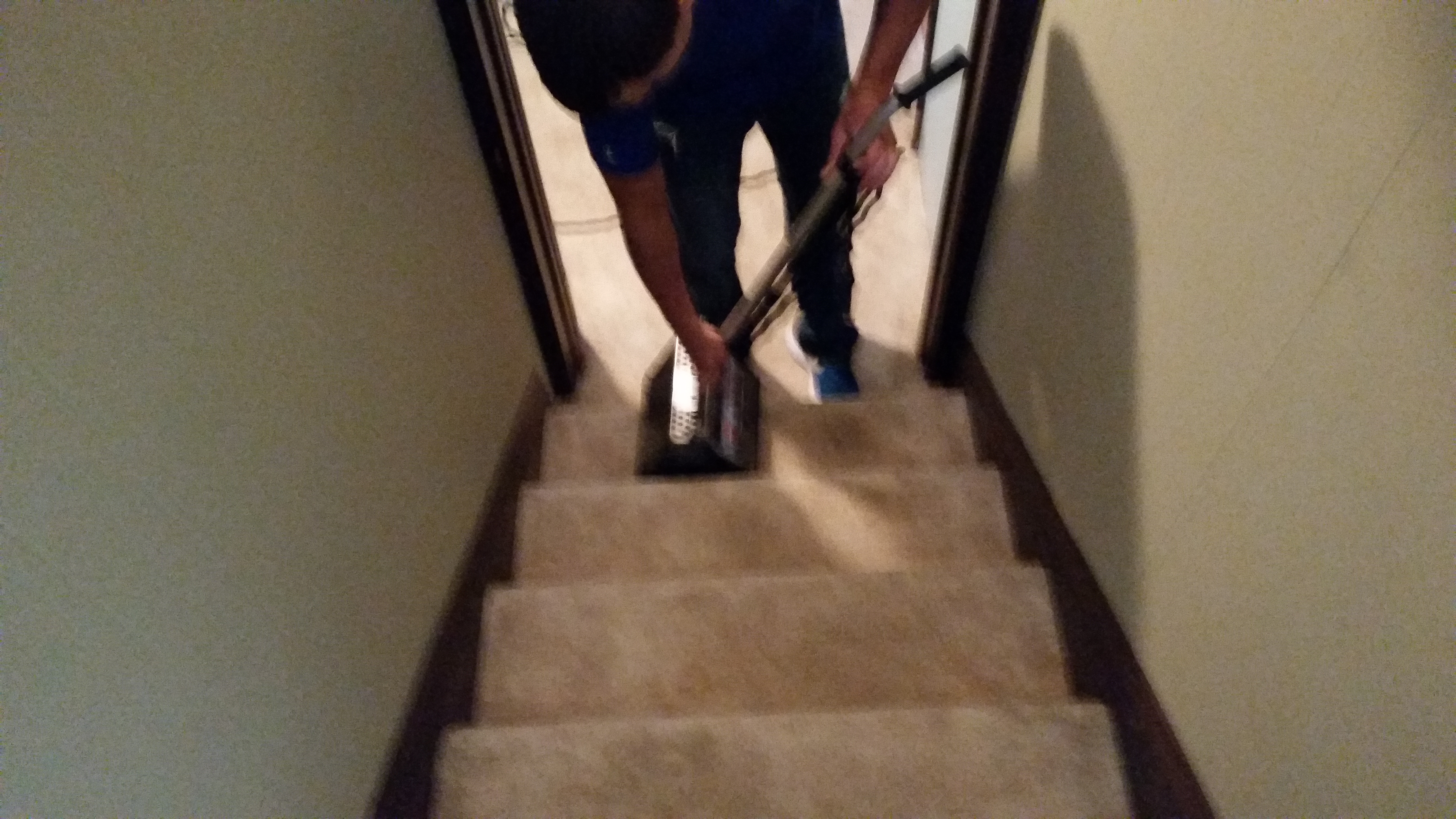

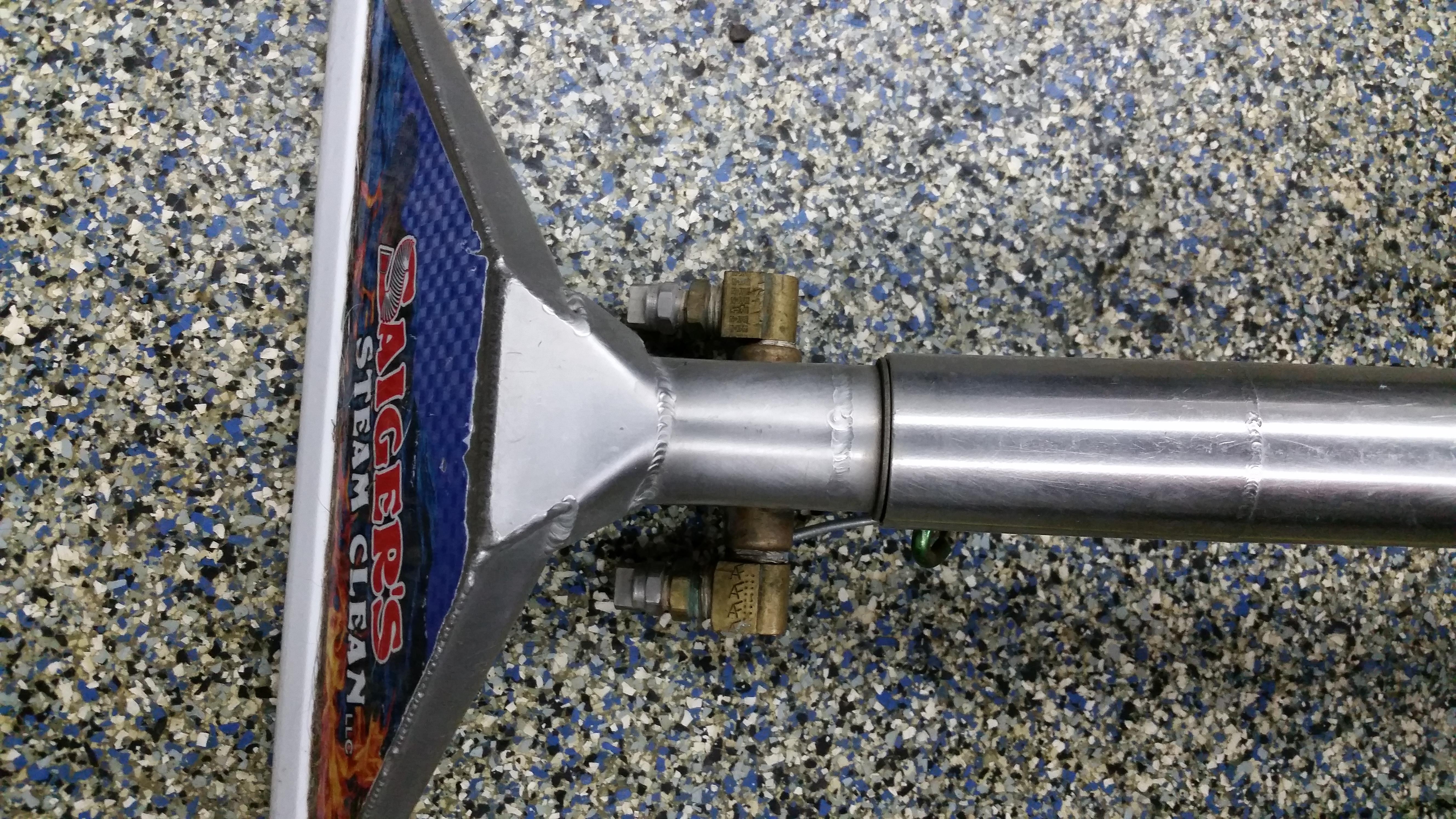

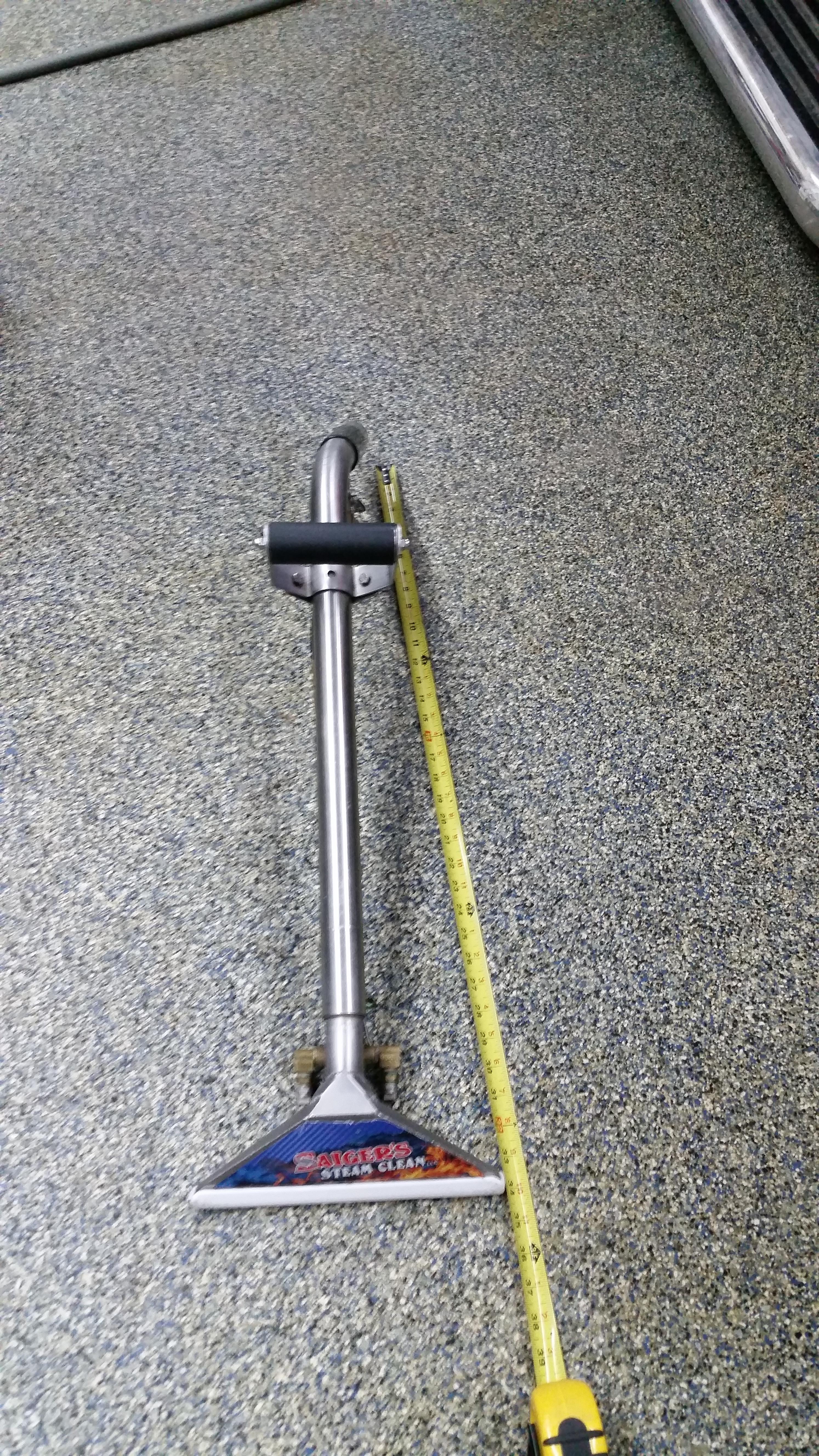

This is the wand we like for our stair cleaning....

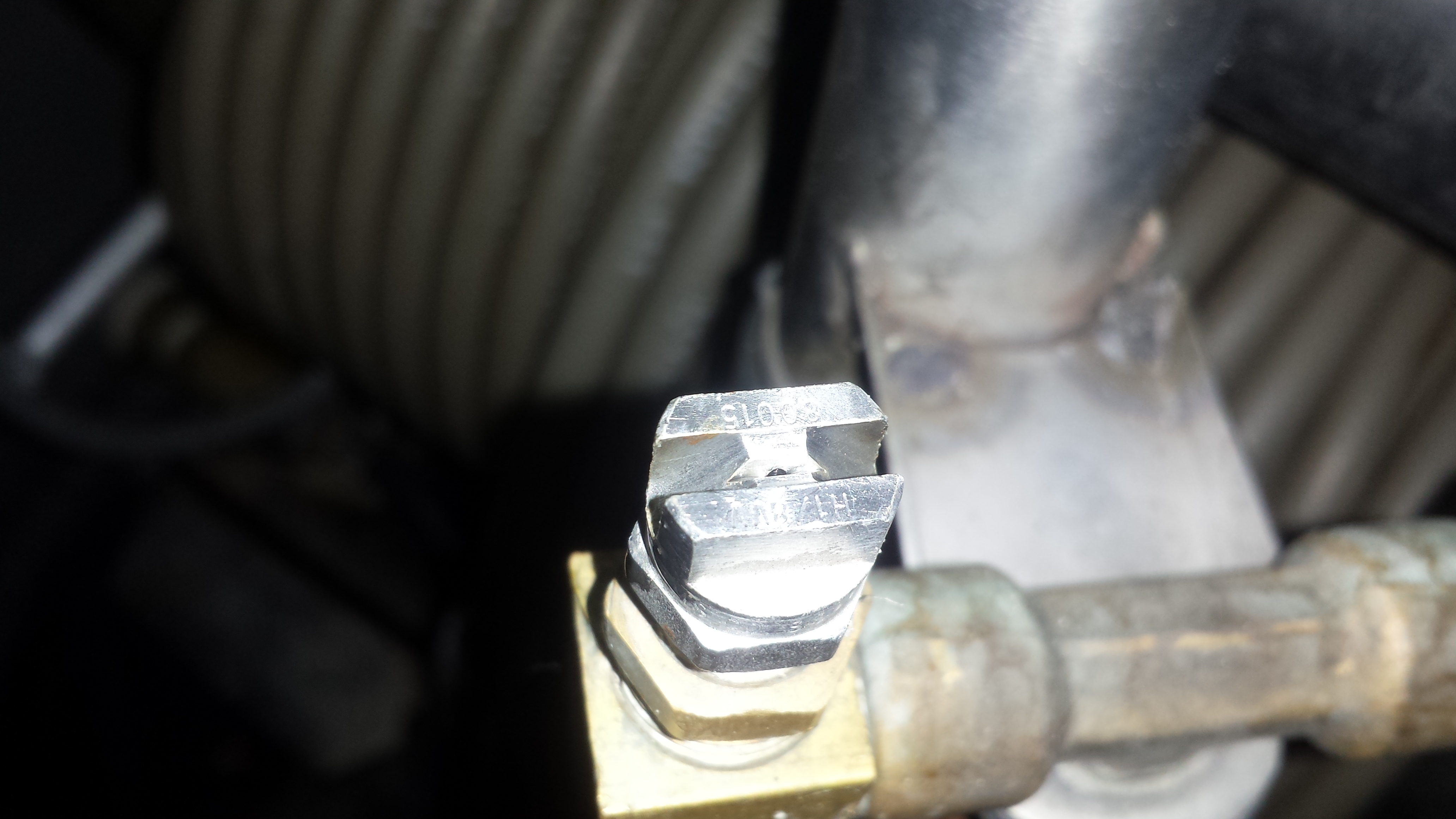

PMF swivel head, Greenglide Hybrid, made into dual jet for more even spray pattern and better flushing. 80015 jets ended up being our sweet spot.

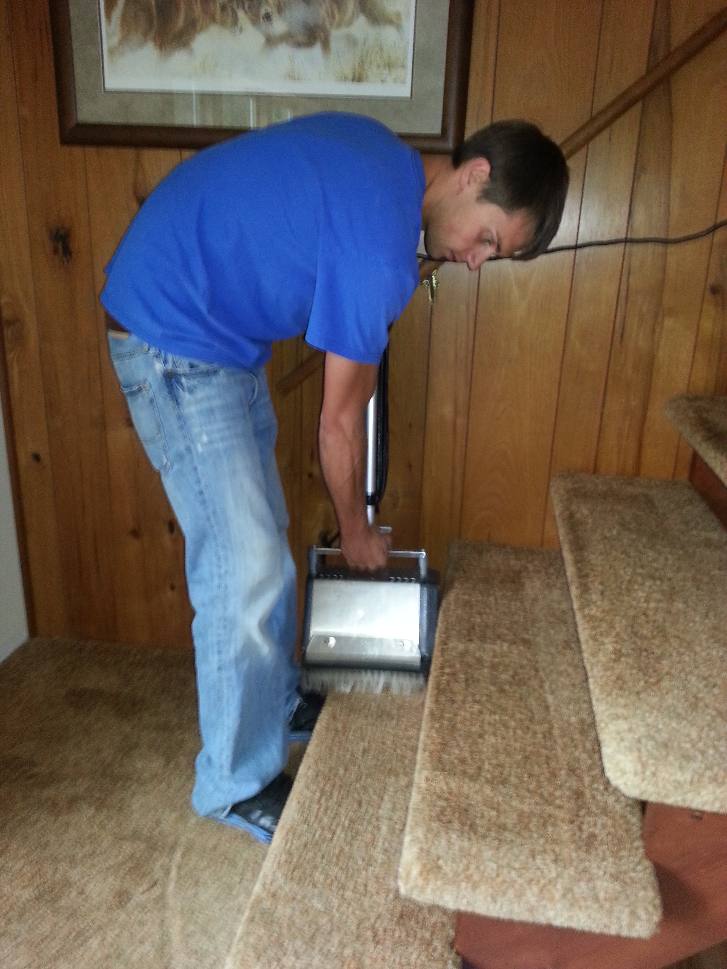

We prespray, use a CRB on the stairs as well as hitting the bullnose....extract, use the hose cuff to clean up the bull nose....
So....someone asked what we use....so I am sharing....That's it :)

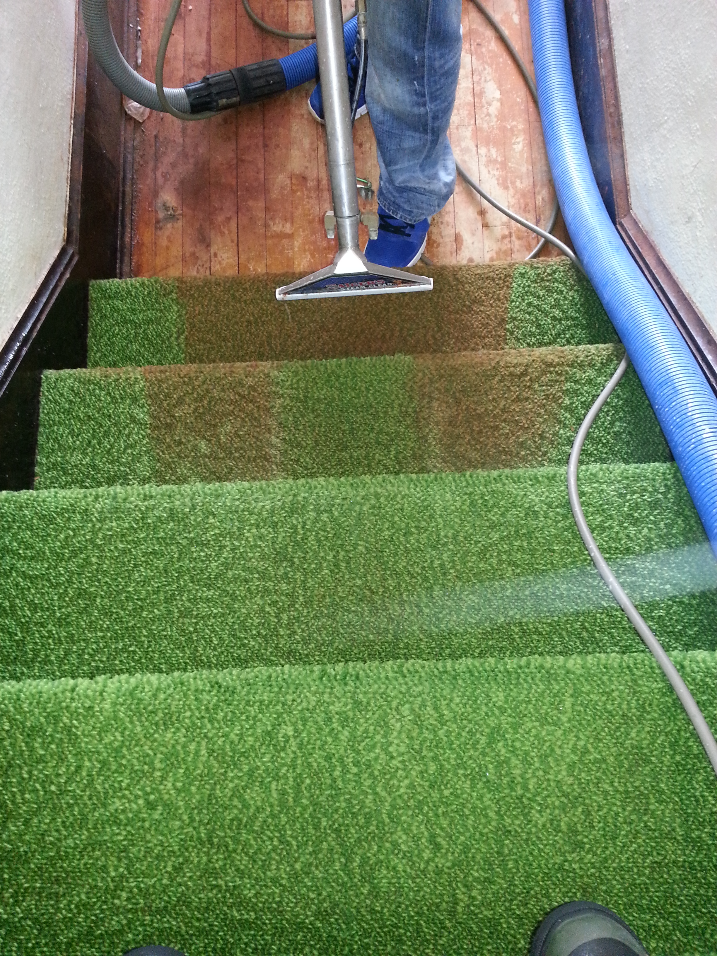

This is Ground In Iron Ore Tailings....not very easy to typically remove....for some :)

John Olsen made one of these up for us too by the way, so if you need one ready made, contact him at Superior Cleaning Supplies!

I use the same wand without the mod or glide and prescrub with crb when needed. Im sure its not the greatest but i like the swivel, very comfortable and can get the bullnose really good. I put a fan on steps right away to improve dry time.

I use the same PMF Mark. Mine doesn't swivel though, and only has 1 jet...oh and no glide.
Great tool though. I've only had mine for a few months but I really like how it cleans the noses of the stairs and is precise with spray.
Light weight too.

"This is Ground In Iron Ore Tailings....not very easy to typically remove....for some :)"
I believe you did those people a dis-service. :eekk:
Now they are stuck with that 70's style carpet for another 40 years! ;)
Great work Mark! :cool:
Reactions: Mark Saiger
11,200
I'm here to please....
Myself and my pocket book more though....LOL

Same tool without swivel. Only 1 jet. Prob the best tool I bought 10yrs ago at startup.
Long time ago I used to use wand in my first life in this business. My shoulders love my economy stair tool today.

That posture scrubbing the stairs will make a young man old pretty fast.
No risers on those stairs but how do you scrub risers?
