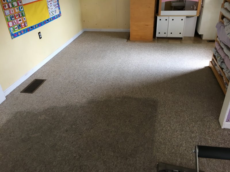

They called me today to tell me that they're gonna replace that carpet, but they want me to come back next week to clean the long hallway leading to that room and another area about the same size that i cleaned about 2 years ago.

" . . he thought it might be iron deposits wicking up from the metal rods rusting from the moisture in the foundation. He suggested that, so I took that route."

Instead of spraying rust remover all over the room, stinking the place up...he felt that the grime release pro would be enough to flush it out. I'm not too happy with how it all went out, so I'm just considering it a lesson learned on putting my foot down reminding the customer that it's time to replace it.
I made the mention of replacing it when I first looked at it, and I knew they wanted to try to clean it, so I let my guard down and said I'd try my best to clean it. I wasted 2 1/2 hours of my day on a Sunday to do this, only to be embarrassed.

I was putting more faith in encapsulating this job. No I didn't have a cimex. But I had all the needed pads and bonnets to do what was needed if it was the way to go.
Even if I fumed up the whole room with Rust remover, I don't think I would've suggested that, just because this carpet is totally neglected from them being too tight $ with their money that they have wayyyyy too much of. I'm not exagerrating on that one either
That is just part of the learning process.
What effect did the oxidizer have ?
Did you try a strong reducing agent (rust remover has some reducing effect) ?

The reducing agent is the only thing I didn't try

Something like chemspec browning treatment, which has a mild reducing agent is always the first thing you should try. Does no harm and often solves the problem immediately. I do corrective cleaning for one of the largest rental machine companies, where people have over wet their carpets and that is the first chemical I apply. Spray it on, agitate lightly, rinse with neutral cleaner and lightly spray before you leave. I rarely pull out peroxide on those jobs. Severe staining may need a second spray.
Mr buff-a-rug ,several posts before this one, suggested a peroxide in the encap, which made me make that decision on the peroxide. I wish I took Mary's smart ass comments seriously. That seems to have had a better chance. I was gambling on the chance it would be mildew from the moisture below.

I oxy encapped it with a grey pad, tried usr after, presprayed with an acid rinse at 4:1, and then just prescrubbed with harvard's grime release, then post bonneted with the oxy encap. And no, I didn't do that all in one spot. I experimented in different areas to see what the best result would be. The Grime Release Pro with scrubbing had the best results. I spoke to Hassan yesterday at TCS's customer day, and he thought it might be iron deposits wicking up from the metal rods rusting from the moisture in the foundation. He suggested that, so I took that route.
Either way, it still looks like crap. And whoever thought encapping would help is too lazy to swing a wand and too cheap to buy a truck mount. I'm not convinced that ecapsulation is worth investing in. I don't care how many pics are posted. Every time I try it, I fail miserably. I'm glad I have a truck mount to clean up after it.
That is a tough one. I'm with Pemberton, I haven't had a ton of success on jobs like those. Most of the time you are just making it better. You gotta give the cimex a chance. I was like you and resisted while the Jon Don guys were chirping at me to buy one. I finally did and......wow!

@Desk Jockey , and whoever else is hardcore VLM... Would a quarterly cimex program prevent this problem from occurring? They've replaced this carpet and I'm thinking about talking to them about it. If you remember,
There's no moisture barrier underneath this concrete, which is the cause of this browning. But this carpet is over 10 years old. That would make me look like an asshole to them if they say yes, on the cimexing and these spots come back on the new carpet.
And how should I price it with a cimex quarterly? What percentage of my normal HWE price should I go by. I know the benefit for the customer is each time a cimex job is done, is the cost of doing the job.
And this is a financial institution. I need to show them something on paper how cimexing will protect their "investment" of all this new carpet in the long run. So is there any brochures or something fancy out there for me to give to them?

It's simply deceptive and it works? Matt. You sometimes can't correct installation problems with cleaning. Plastic chair mats may trap moisture causing browning, cloth mats may transfer preservatives to the carpet causing yellowing. Any mat at all will keep the area underneath cleaner than the surrounding areas and will be evident when furniture is moved. Sometimes, it's a no win situation.
