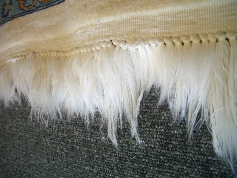

Fringe bleach, not rinsed and not neutralized, is what burns a lot of fringes off of rugs, and oxidizing shampoos such as the old Haitian cotton cleaners are hell on upholstery fabric.

I totally agree about the use of oxidizers. Way over done, alot od damge and the fringes fall out.
