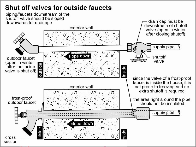

[quote="Fred Boyle":2pzf68wf]Jamie,
If it was the top one in the diagram, then you had to turn on the inside valve to get the water to flow.
In that case, there really is no question that you are responsible for the damage.
If it was the top one and the inside valve was not shut offf by the new onwer or the prior owners during freezing weather. Of course it froze.
Or maybe ever a tenent or an other maintance woeker opened the inside valve.
Even if the inside valve is closed off, The outside valve has to be kept open alowing it to drain.
If you had to open the outside valve It was not manitainded properly by the owners for freezing weather.
So, Did you have to open the inside valve? Was the outside valve left open?[/quote:2pzf68wf]
It was on when I got there. I just pulled up, checked to see if it was on, then hooked up/

Becker said:
I know the faucet well....
They are frost free..
Often when a hose is left connected in cold weather, water will not drain from the neck of the valve. Freeze and break.
It will only leak when turned on.
So, I always.. Year around connect, turn on, kink hose and listen. Often besides hearing you can feel the hose does not back up pressure. A sure sign the neck is leaking.
IMO, if this happened to me, I'd roll over and take blame.
I would feel this was my mistake.
But maybe because I know better.
I come across just 5-10 broken valves a year.
Something else I do, because I don't use on board water.
Often I always use my own hose when connected.
But if I used the clients, I always discounted it after use in the colder months. No matter if it was or was not connected before hand.
When using my own hose, I never reconnect theirs in the cold months.
Sorry it happened to you.
I'd take blame, but not offer blame.
Nicely illustrated.
