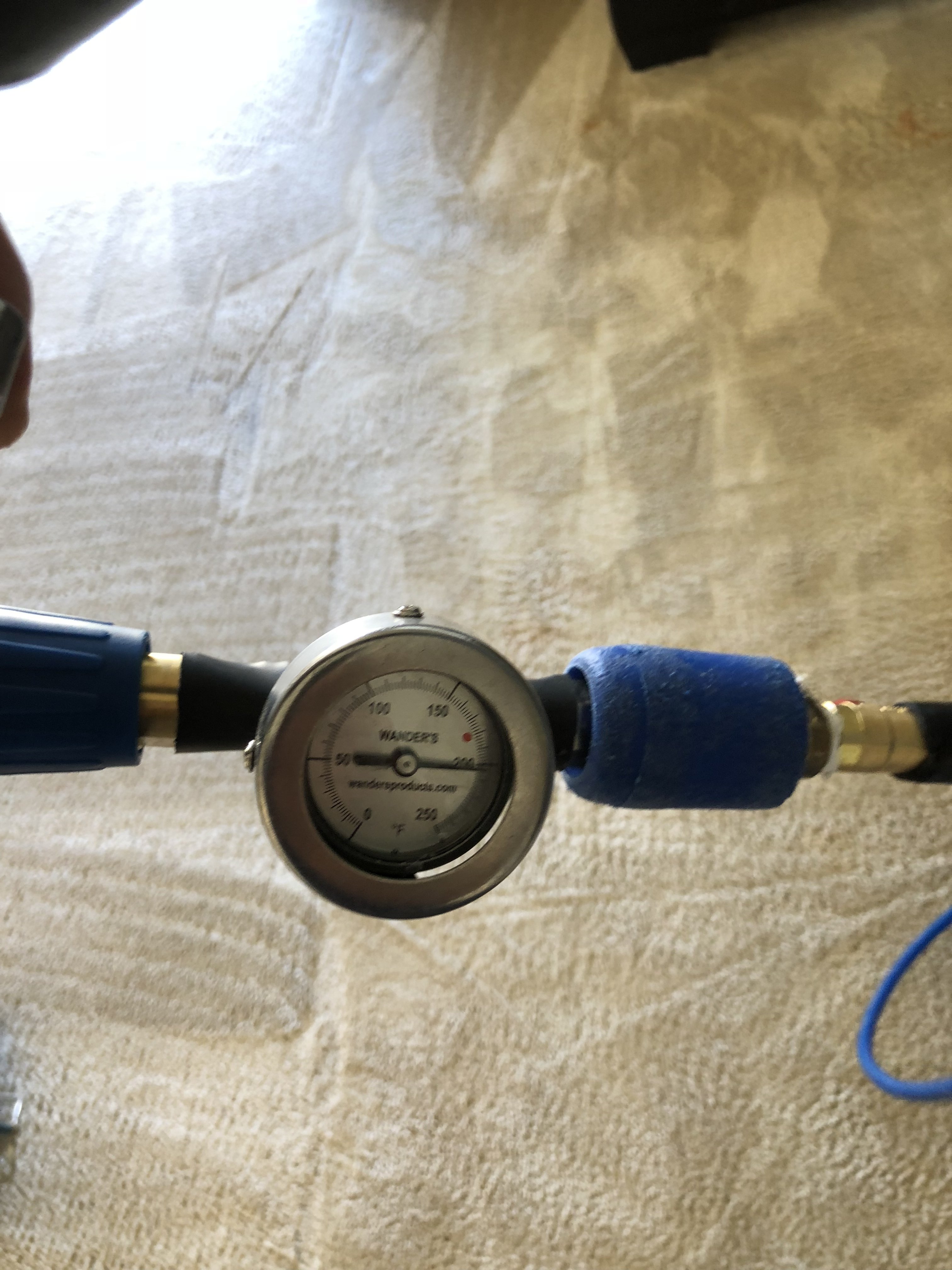

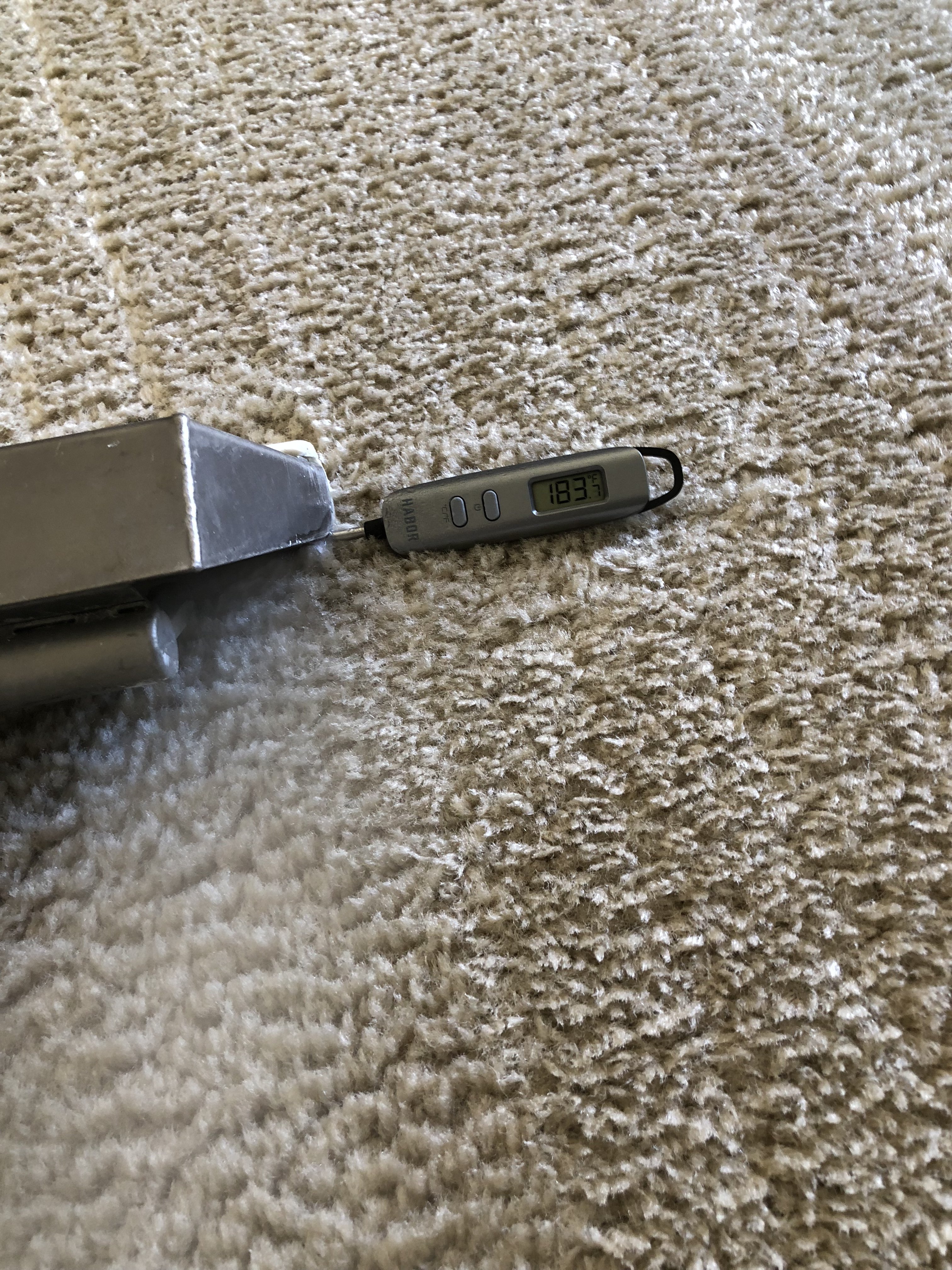

Just to see how much heat loss there was from wand to carpet, I’m using a 9 flow 6 jet wand.
When I ran my pro1200 on medium I avg 180 atw and 160 atc
Bumped it to high and I was closer to 200 atw and 180ish ATC.
Ps it was popping!
