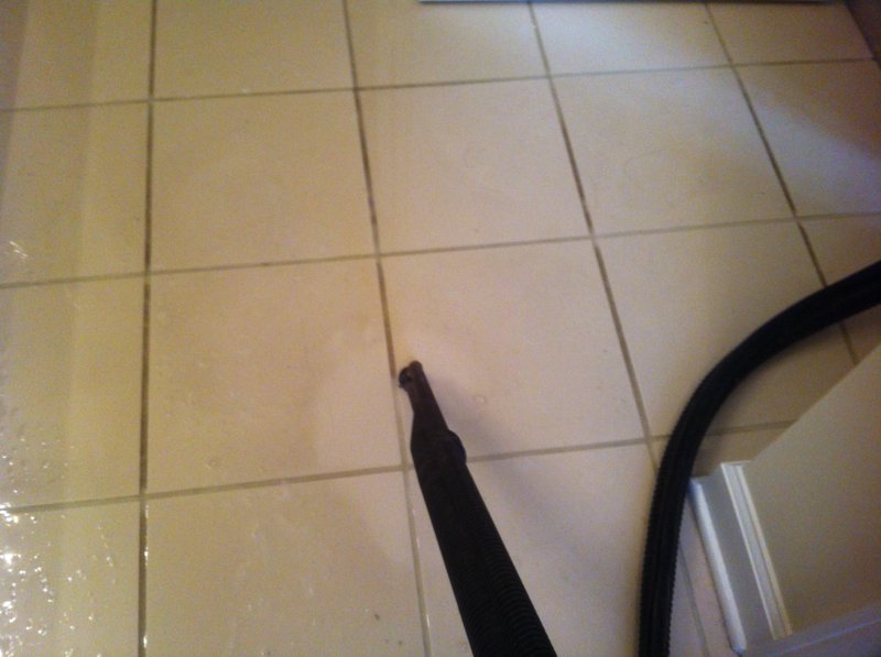

My day yesterday was crazy. I was not prepared for what came at me.
I arrive at the house, expecting to clean some kitchen, dining room, a couple bathrooms of tile and grout floor. Average time expected to be there 2.5hrs. I was wrong!
She had those rooms, a laundry room, a tiled shower and steam room, and a tile counter top in her bathroom. I didn't have enough sealer, so in the middle of the job, I drove 30min to home depot to get some.
But back to the cleaning: 3hrs into the cleaning job, I noticed that her grout was blotchy in her kitchen, dining, laundry and guest bathroom. She told me then that she just remembered WAXING her tile and grout about ten years ago. Had I known this prior to the job, I would've not done it.
I told her If she wanted me to try to get the wax out, I'd have to come back later with some floor stripper, charge her extra, and Attempt to strip the wax out with no guarantee.
After I thought about it, I suggested to not make a second attempt, due to charging her more and the chance of not getting any better results, since the cost of the job was already at $670.
So I sealed over the blotchy, grout to protect the grout that wasn't blotchy. What would you've done? And is it gonna make it more blotchy with the sealer over the wax spots?
Heart of Dixie
Melt wax with steam and dissolve it with any stripper. It will come out.
Old sealant, though, is a crap shoot.

I wasn't gonna waste a full day's worth of work on a job 35min one way away from my home.
And due to my limit of knowledge on wax with grout at the time I was on the job, I just made the decision to clean it the best I can, and seal over what was there.
Even If I went prior to pre-inspect the job, I don't think I would've noticed the wax, because the soil and dry cleaning chems were covering the wax. The blotchy spots were only coming to the light after I agitated the grout.
13,416
Georgia
Wax comes off with stripper. Stripper may not be safe for all floors.
Even on 10year old wax that the grout possibly absorbed? I made 3 calls that day to people that have more experience than me, and asked them about it. 2 out of 3 people said that the grout would probably still be blotchy

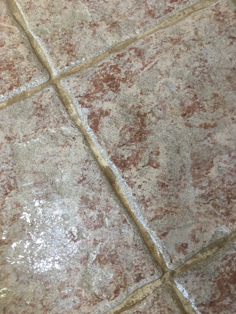

I don't know if it's just the camera angle but the grout looks like it's higher than the tile. And put down by a 3 year old.
113,218
the install is just how it should be. The tile's edges are un even in efforts to give it a stone paver look.

Why? because the edge is uneven?
Ok maybe it's just me then? The uneven edges make the job of wiping off the excess color much more difficult compared to a straight sharp edge. If you disagree with that then you must have a better technique than I do. Or a more steady hand? These take me twice as long to color seal.
