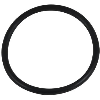

BTW Kirby and Sanitaire belts are not interchangeable.
Shane Deubell
Jun 30, 2011
4,052
If you are talking about these things, they suck. The belt and where you put it is round/smooth.
So when it stretches a little bit it has nothing to grab onto and slips.
