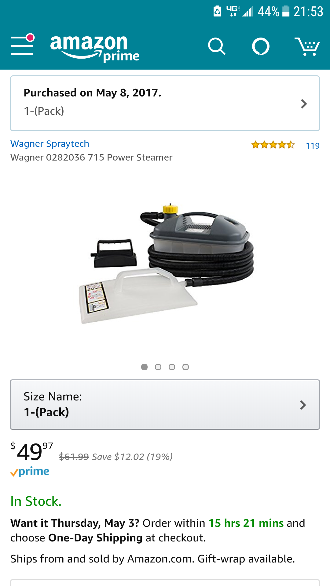

Swani
I recommend this. Very easy to use and you'd be pretty hard pressed to "F" anything up.
