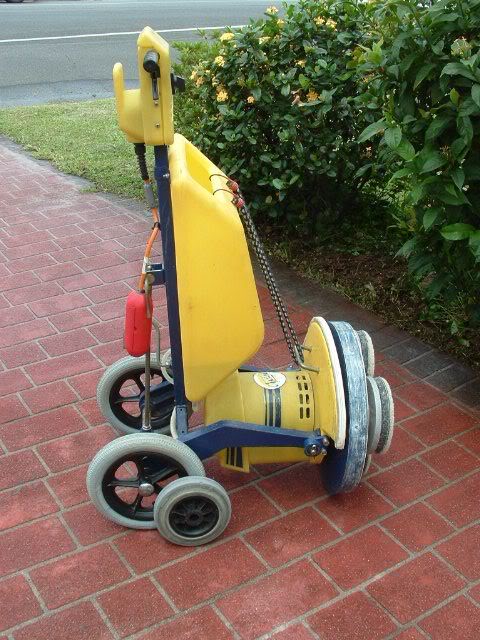

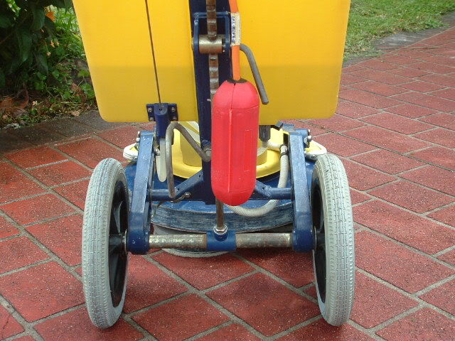

You mean like this.........................?
The red box holds the two leads together and stops them from pulling apart, it also helps protect from any water.
These photos also show the large pneumatic wheels that I fitted a couple of years ago and make it so easy to take up four flights of stairs, (64 steps).

Where can a person get those larger wheels? Why don't they come with the larger wheels? :shock:

Look like the same wheels from a Dehu?
are they really pneumatic, or just solid closed cell rubber?
Shorty
Nov 8, 2006
5,111
Cairns
Shorty Glanville
Hey Greenwun, yep, they are fully pneumatic.
Pump in to them what you like.
I only inflate them roughly 2/3.
This keeps the tires flexible to roll over the step edge, or even the bullnose if they are there.
To much pressure and they are that much harder to take up the stairs.
Look at the first pic; the wheel on the off side, has the valve near the top, just in front of the height adjustment rod.
The near side wheel, you can just see the valve at the bottom, partially hidden by the small wheel.
Those wheels on the dehum; as you say, are bloody hard to take up & down stairs.
Taking Big Yella upstairs with the little wheels was like pulling up a 2400.
With the big wheels, it's like taking up a 1200 :wink: & being a lazy bugger, I always find the easy way to do things.
