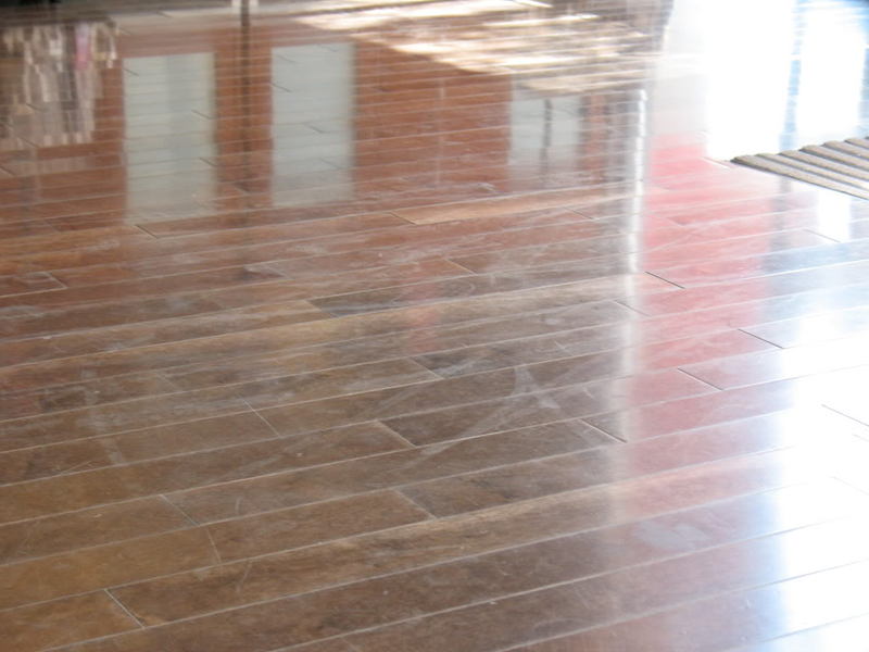

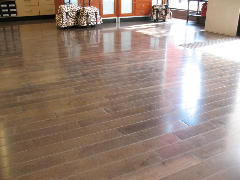

Here are some pics of the issues with this floor. We will be taking care of this tomorrow night.

That floor is 4 weeks old!!! Basically some haze from the previous cleaners putting something on it they should not have. Some drag marks from employees dragging things.

Maybe it's the pictures but the condition looks worse than what a simple polishing will correct. Again, might be the pictures, but it looks like the floor has more than a few scratches. I would also want to completely remove whatever product was used that should not have been and I don't believe polishing only will do that.
The age of the floor doesn't matter, it's the condition of the finish. I'm scheduled to refinish a brand new floor that looks better than that. The owner hasn't even moved in yet but the floor has some scratches and scuffs from the movers and workers.
That said, I'm looking a pictures and you're doing the work so I'll defer to you.

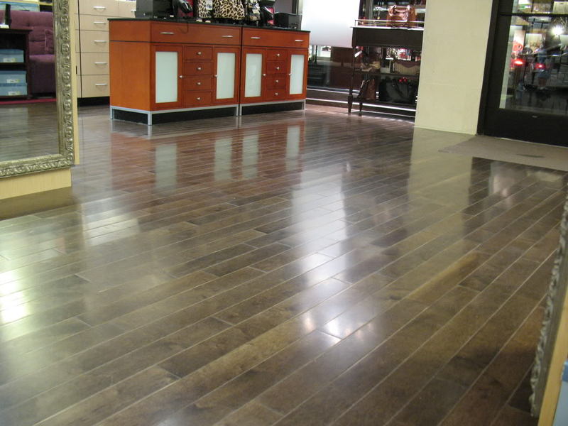

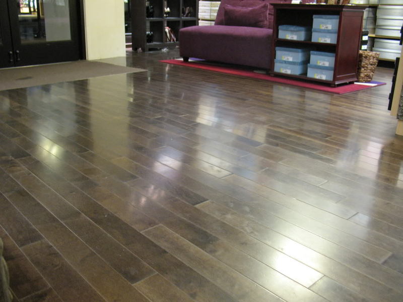

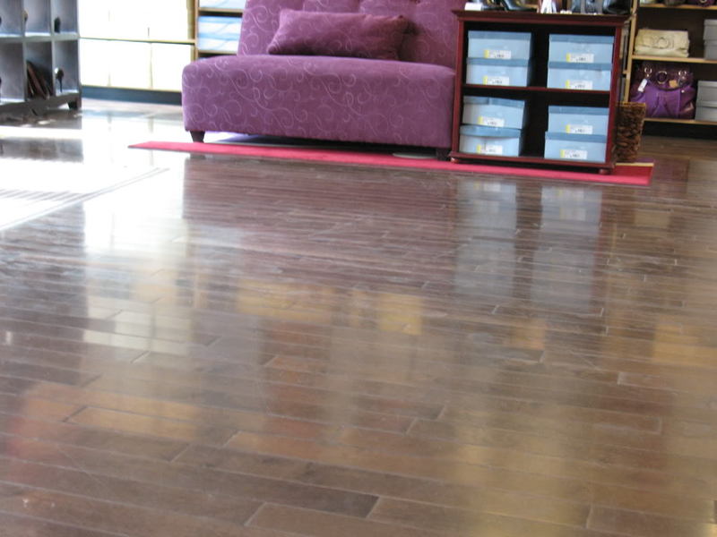

Here is the result. Different lighting because of night photo.
Spot cleaned the glue marks with neutral floor cleaner mixed strong, polished with a microfiber pad (w/ op machine) and bona wood floor cleaner. Took some of the very fine scratches out, but several scratches remained. They just wanted the residue off the floor. Now to discuss with them how to maintain this now going forward.
