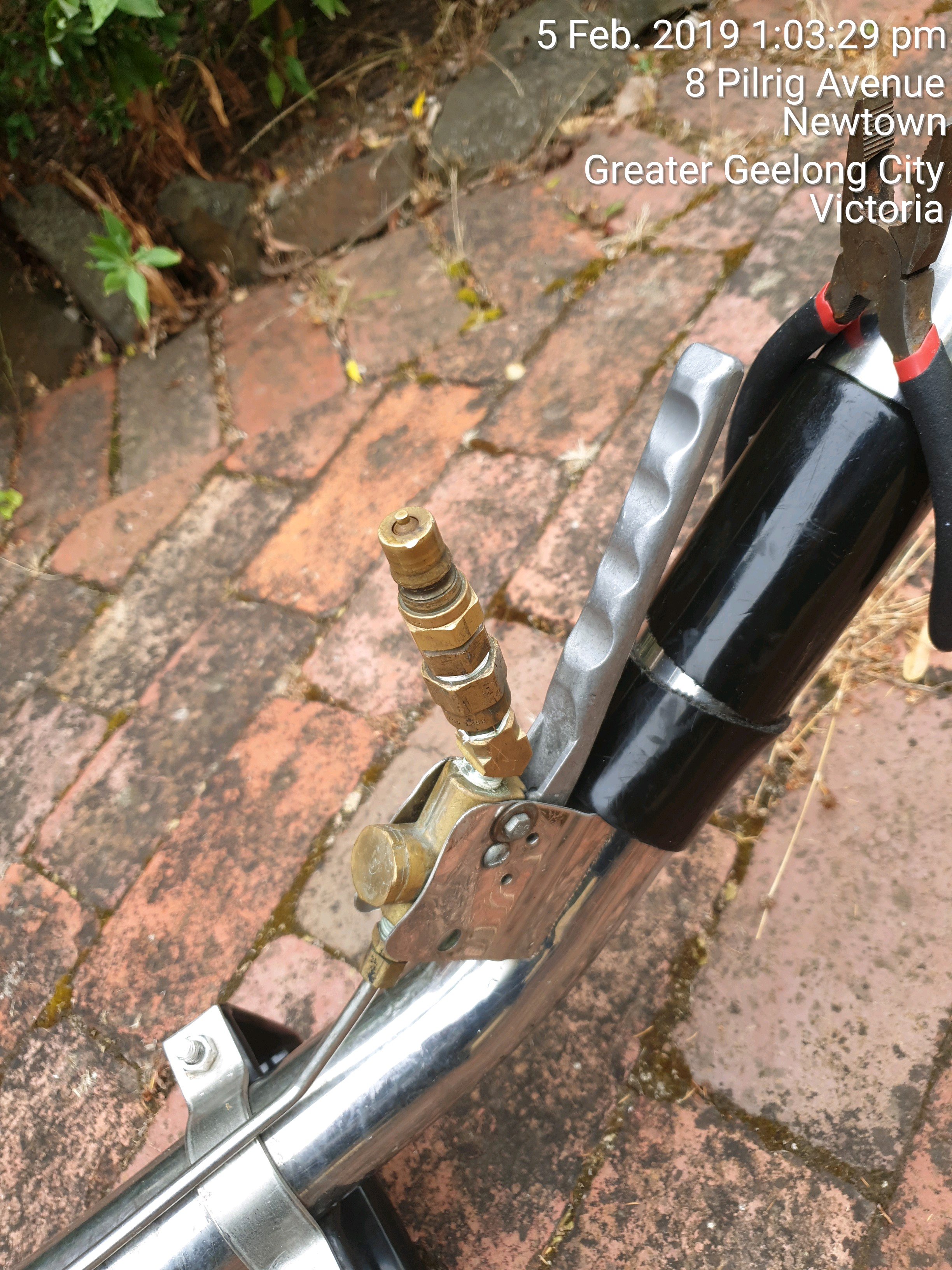

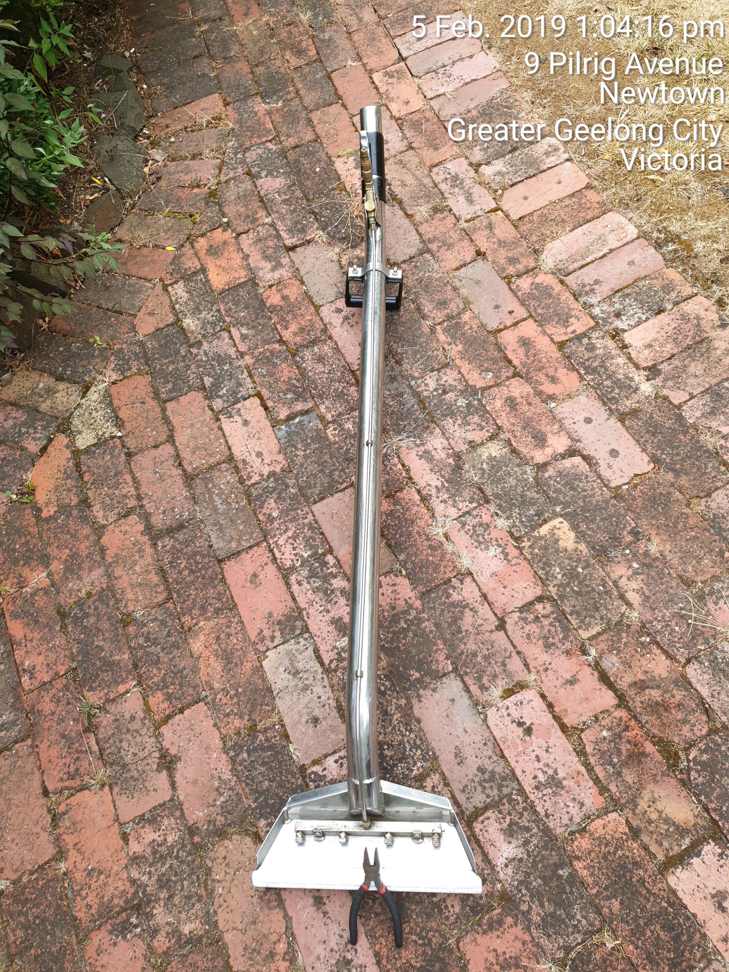

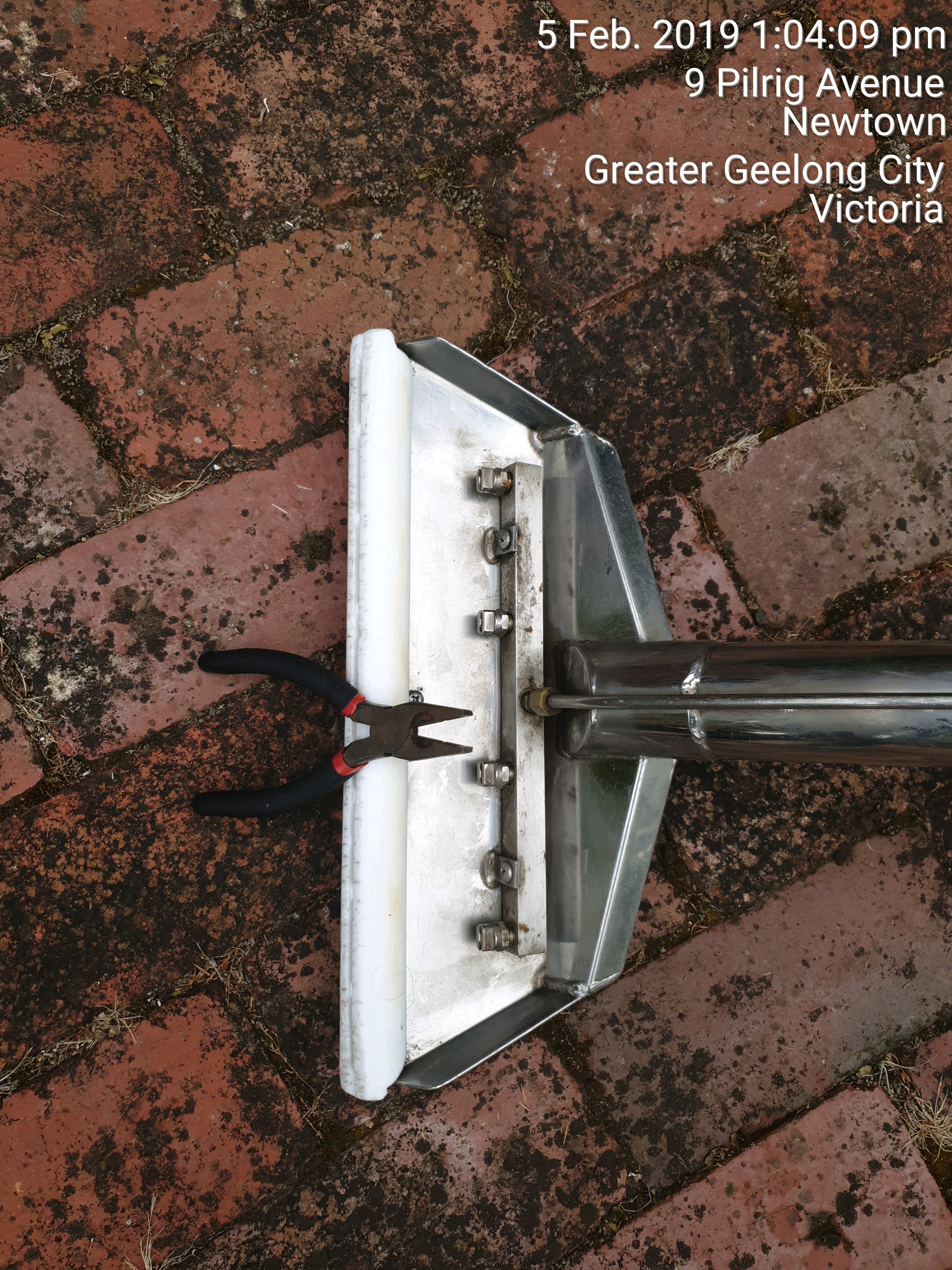

I need help identifying this wand.
I need a spray repair kit.
There is also a pin hole in the small stainless steel pipe leading to the spray jets. Can I solder this?

California Metal Products all but disappeared from the scene until the Interlink swivel wand came out.
The wand in your picture is what Greenie based his Greenhorn wand on.
He use a Westpak trigger and a spray bar that had more sheer action
don't know about solder .
silver solder patch maybe???
TIG weld for sure, if you know any TIG welders
I'd just buy or make a new line ...and it woudn't be steel...that leaves second degree burns on a leg or arm with hot TMs
I've got a hydraulic shop that makes lines for me and I replace then in the parking lot before I leave to make sure I don't have any other issues.
