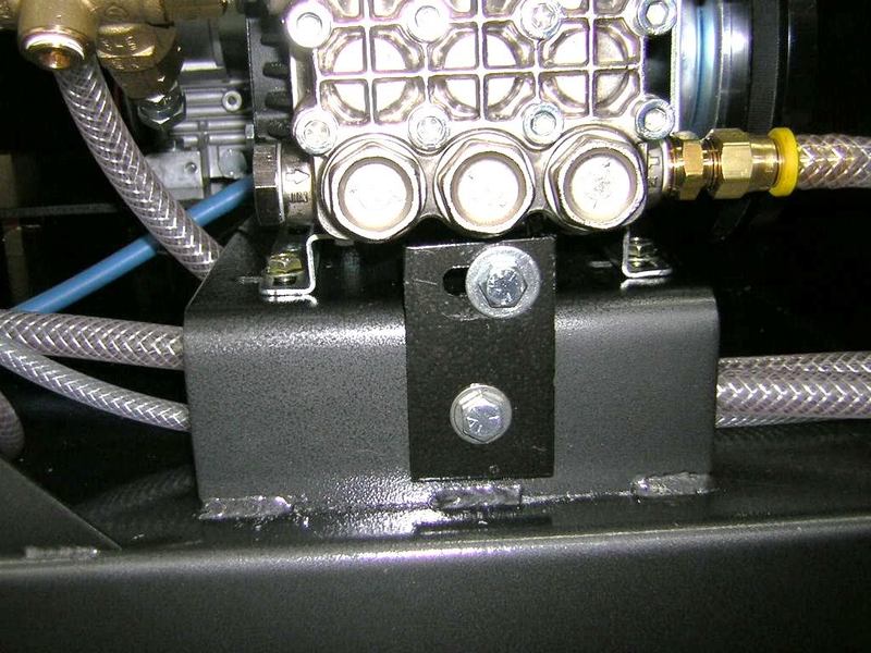

Leslie Judson Jones said:
Hey Les. How does this adjuster work? How is it rigged?
TimP
May 19, 2007
4,055
Ron Werner said:
[quote="Leslie Judson Jones":xjawckg0]
Hey Les. How does this adjuster work? How is it rigged?[/quote:xjawckg0]
Looks to me like you loosen the nuts on the sides. And tighten the bolt by turning the bolt in the middle with the big washer on it to pull the pump away from the belt to tighten it. then tighten down all the nuts (sides) connecting the pump to the plate.

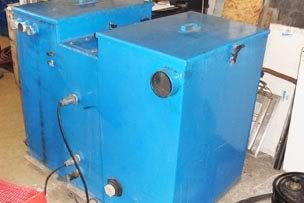

Les,
Would you go to TRUCKMOUNTDEALS.COM & look at unit #922..Prochem 805.
And tell me if the Waste Tank could be SPLIT in half....To allow for a Fresh water tank...
The Tank is so HUGH....I would like to have 2 tanks in 1...It has An APO.....
THANKS :!:
May 12, 2007
2,242
HARPER said:
Les,
THANKS :!:
IT is 300 GAL tank ,the air is pulled from the right side to the left side, I think it would cost alot to redo it.
