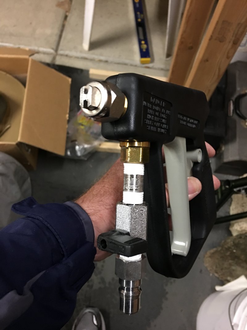

I'm blaming over PreSpraying on the damn hydroforce. I'm so tired of having no faith and consistency with those things.

I'm prespraying a lot less product mix with DI. I'm spraying less onto the carpet. I'm going one or two rooms at a time prespray, scrub rinse, next. etc. etc. No more prespray the whole level of 5 rms all at once.

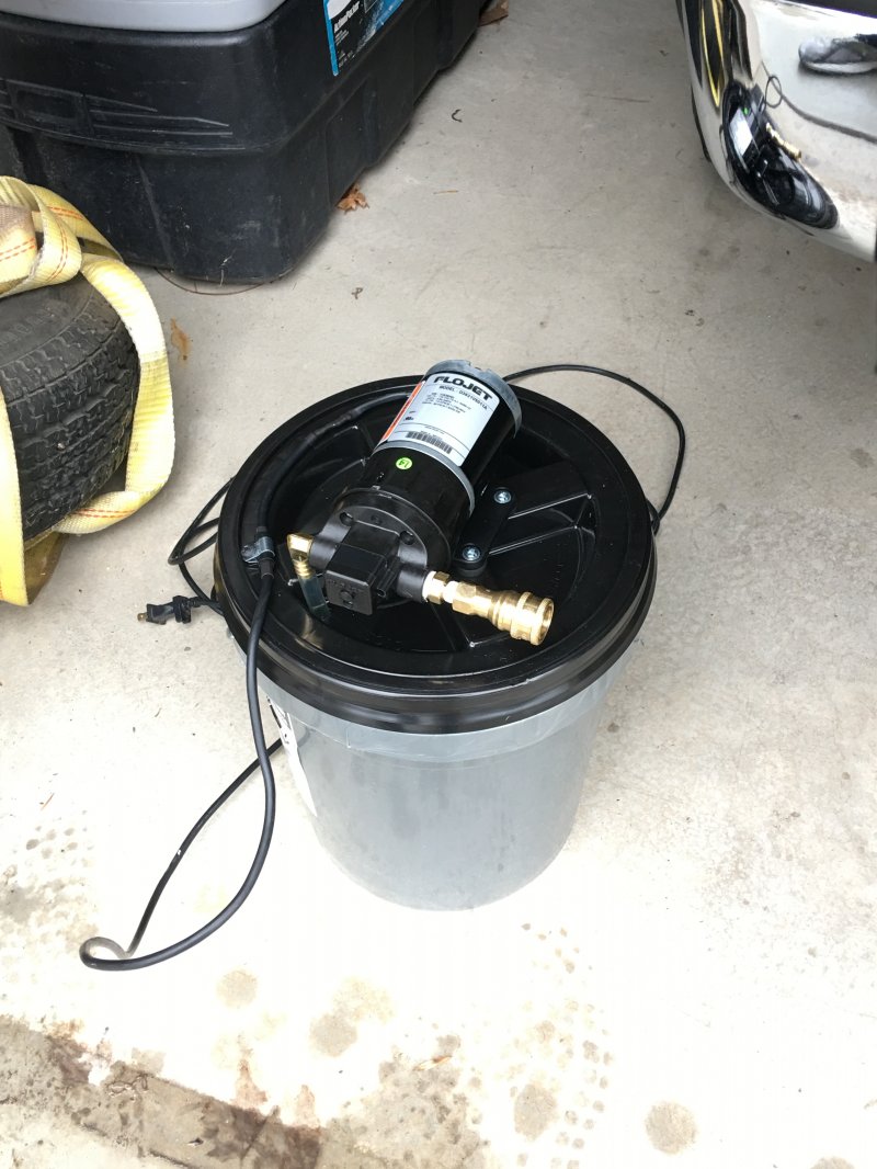

I'll post pictures of my latest project that Kemp Waterfall turned me onto to pre-spray that has me junking the hydroforce.
Lint Basket
Feb 27, 2013
296
Centerville UT.
Scott Mckay

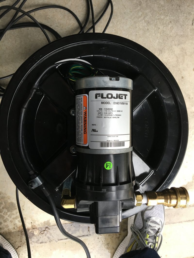

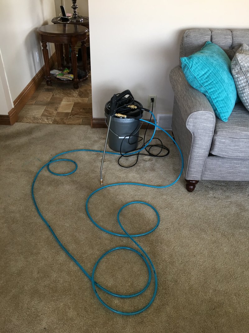

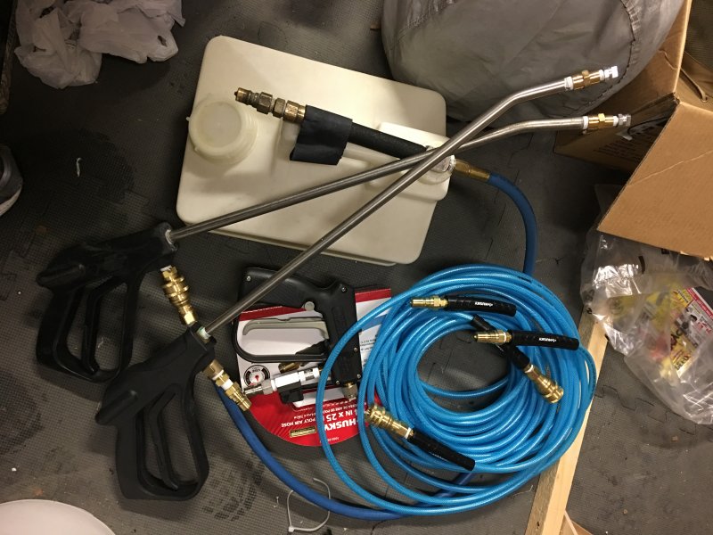

Kemp Waterfall Pail Sprayer.
Home Depot Black lid unscrews and can be moved from bucket to bucket depending on your spraying needs.
Quick connect your spray wand off your hydroforce.
Get 25' blue air hose at Home Depot.
Find an old vacuum and steel the 20' black chord from it.
Put a stainless 8004 or 8003 tip that goes to a prochem ti wand and use that on your spray wand so you don't blow out your hole fast, (because DI chews Brass up fast).
Add an upholstery pre spray gun and feel like your in heaven prespraying upholstery by just switching out the bucket and spray gun.
One bucket of prespray does most houses.

I myself was wanting to make one like that but with a Dewalt/Ryobi battery to power it.... I dislike cords... I also dislike HF's... Add a bucket dolly to it and you'd be in business....
Or get a 6-8 gallon sprayer on wheels, add the pump and battery pack... Shipping is stupid high for me to buy stuff to tinker with....

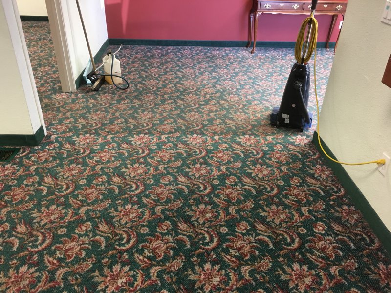

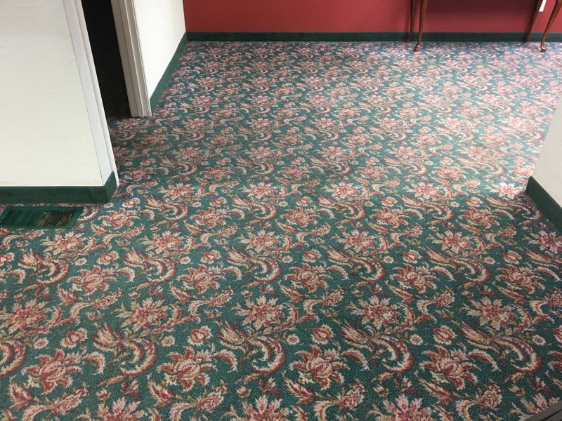

This is the difference cleaning the Hall before memorial, but my truck mount engine started to sputter due to a coil failing so I was not able to finish.
at the Memorial the JayDubs were telling me how much longer my cleanings last...
This picture shows what the carpet looked like after another cleaner came the same day to finish cleaning where I left off. Both of us used truck mounted hot water extraction.
So what was it that he did different?
