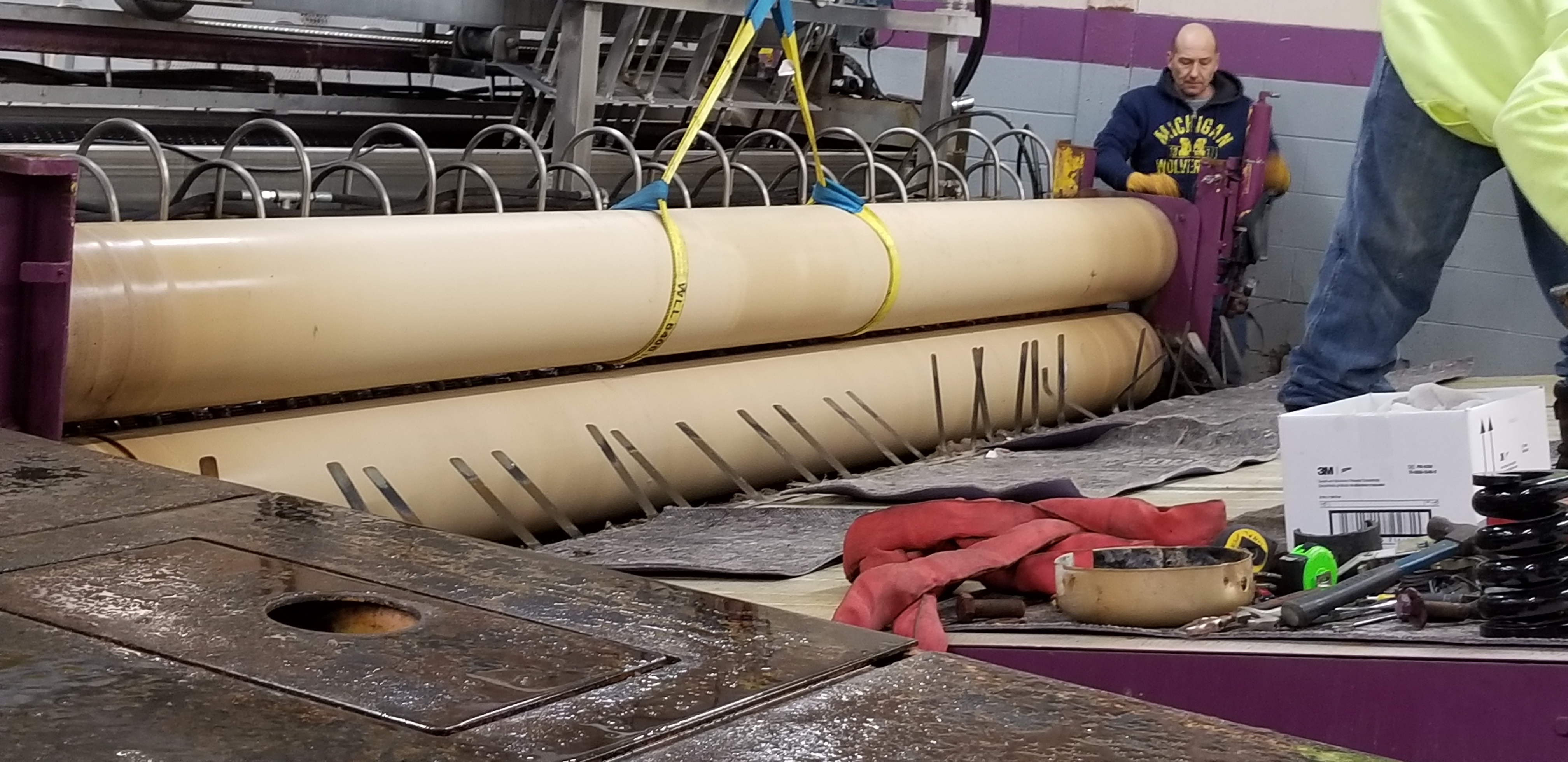

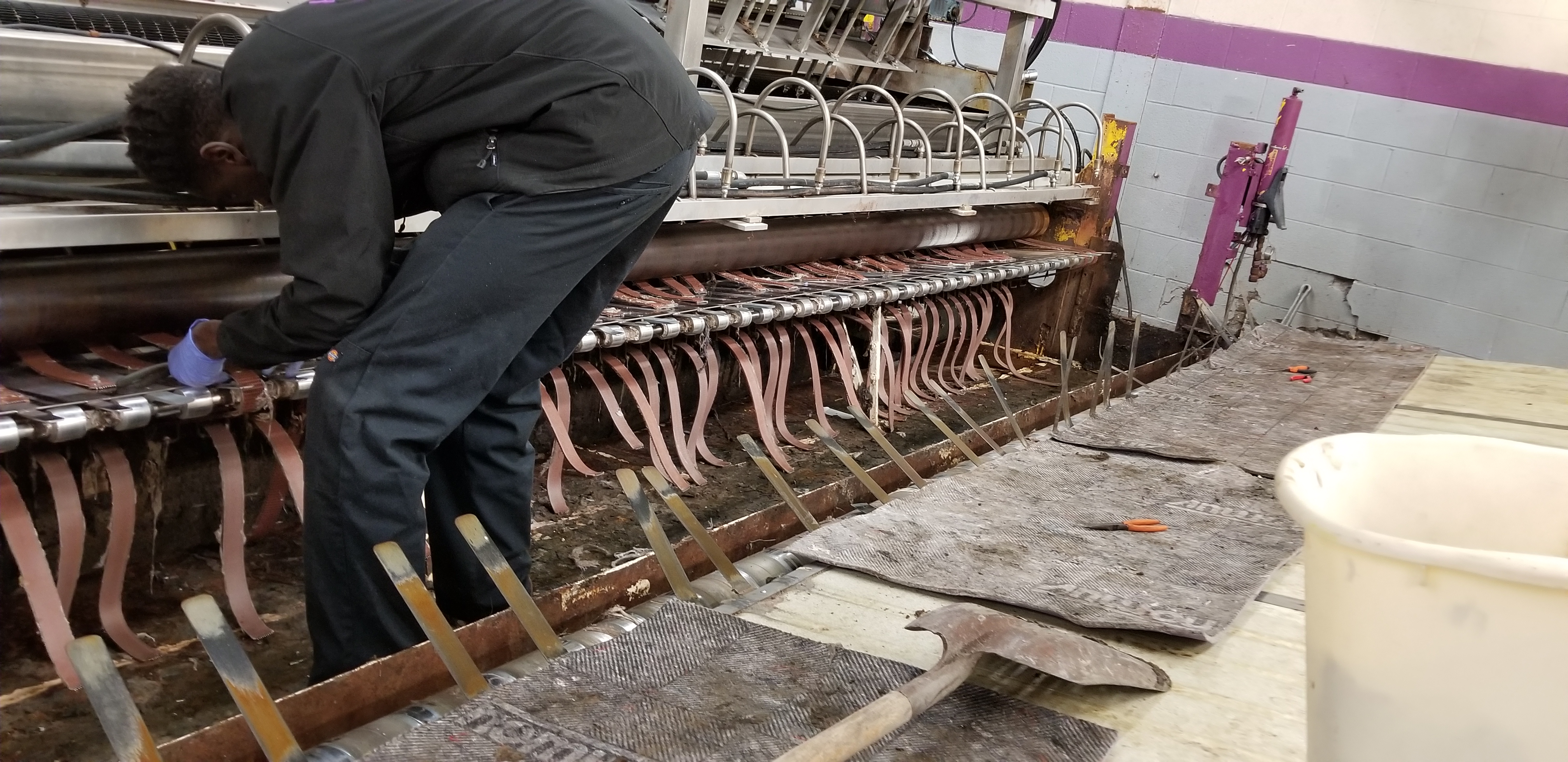

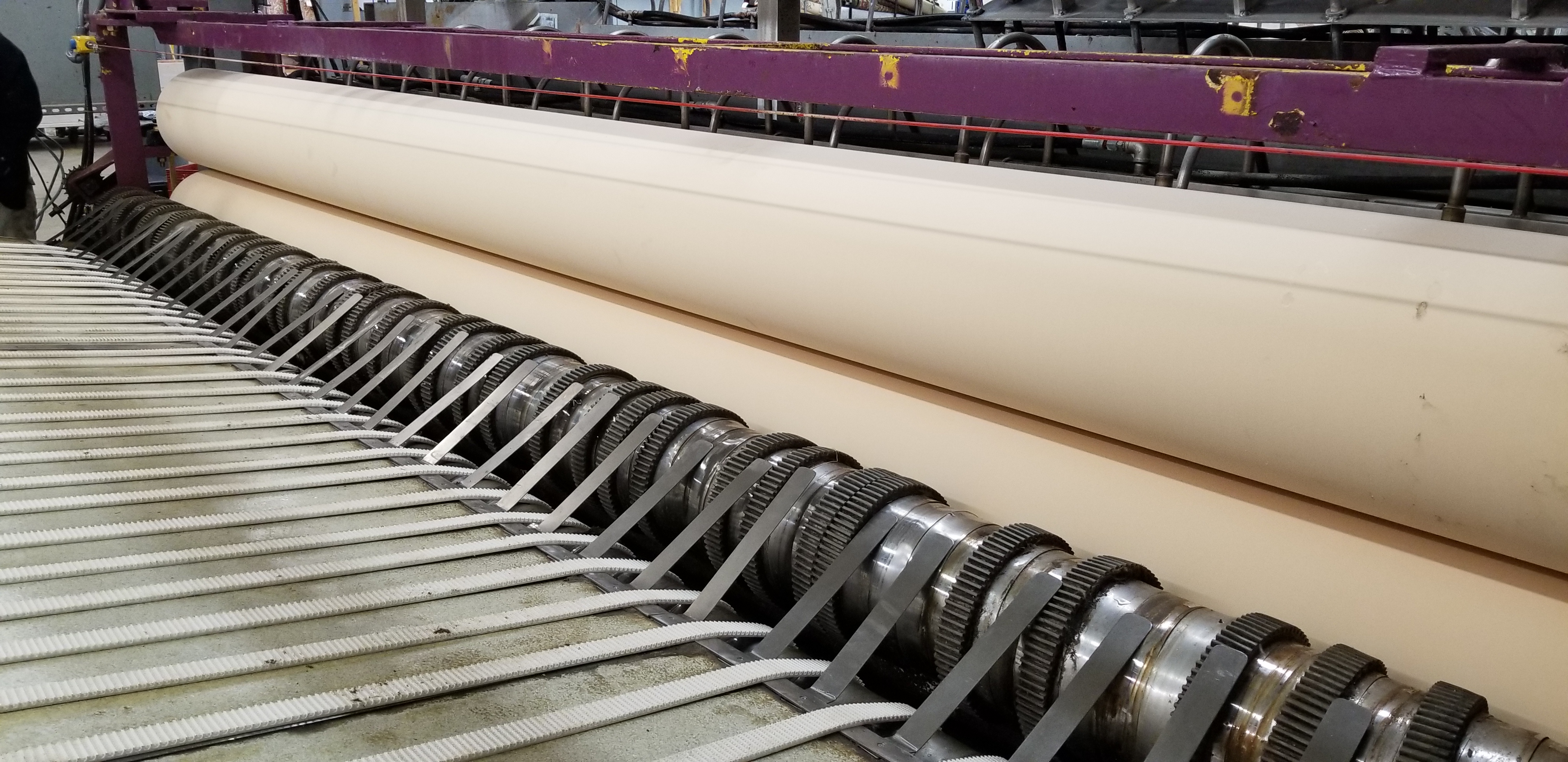

We replaced the ringers on our Moore's machine this week. Kudos to our head mechanic for coordinating it and getting it done on time and on budget!!

We hired an outside company to lift the old rollers out and put the new ones in. We had them out one day, they gave us a couple of days to clean everything up underneath and then they came back to lift them in place. Our maintenance manager was able to coordinate everything, anticipate issues and it went very smoothly!!
