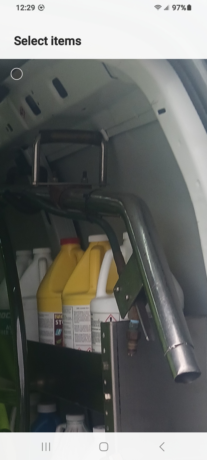

I adjusted the spray bar to where it is now hitting right behind the glide. It was spraying way further back behind the glide, impacting the carpet at bad angle and with more force I imagine. Now that I adjusted it I can barely see the streaks on my wet pass and then they quickly and easily disappear on my dry passes before I even groom.
Thanks for the lesson guys. Makes sense, now I know something else to watch for. I don't think I ever adjusted that spray bar before. Maybe it just slowly moved over time, not sure..

As a reminder when I sold it to you I told you I had to move it up a quarter inch so that the the fan spray would extend all the way to the edge of the Glide..
Did that happen today?
