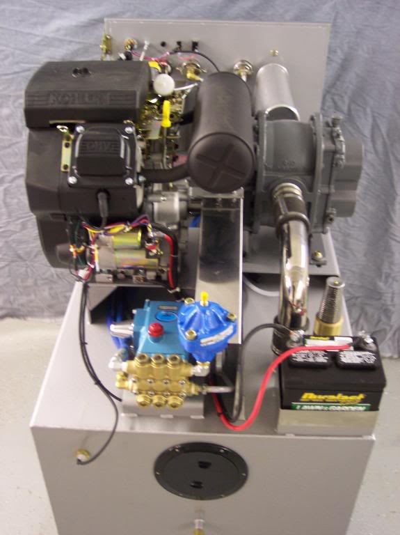

Are you able to show us how the ventilation system is set up on your truck? :?:
A unit we are replacing had a thermal switch that caused it to shut down if we left the doors closed for more than about 30 minutes. As my probable intention is to replace it with a gas heated unit I am concerned about the even higher heat that will be generated inside the canopy.

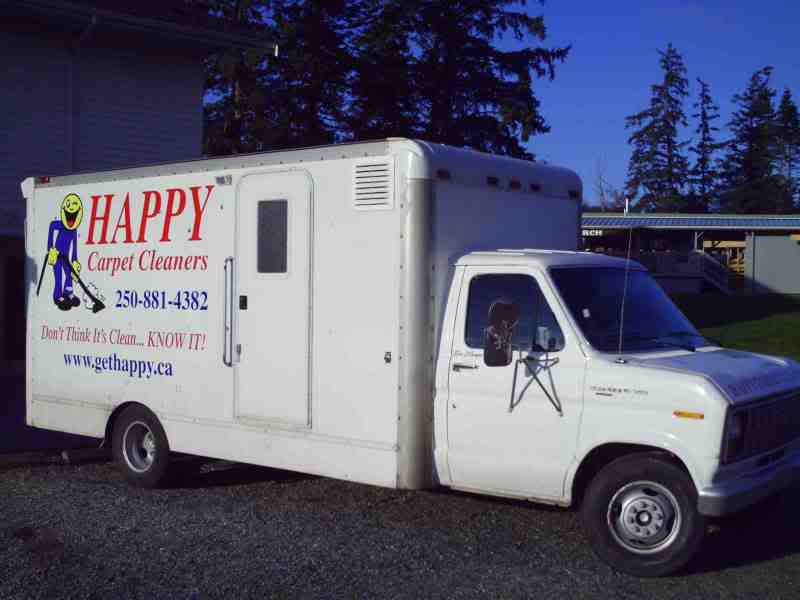

roro
ps just for Ozzie Jim - inside the "Pantec" :p :p :p

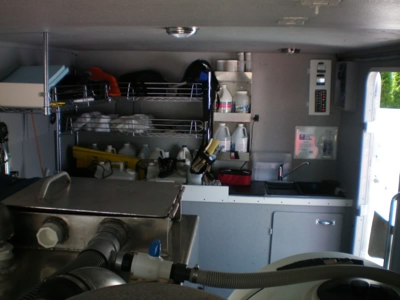

Bob Foster
8,870
This one pushes outside air on the plant
and this one sucks air out of the truck
Ron Werner
8,726
Ron Werner
You can see the exhaust air vent in the upper right of the box
Watch the video at about 1:50 left, I show the exhaust fan. th_08-09CanAmtour.jpg
I didn't show that there is a 2nd fan just to the left of the CanAm which draws cold air in across the unit when I close the doors. Its warm inside after an hour of working, but not that "hot".

Thanks for that Bob, I will need to do something similar.
Congratulations Ron on such a well set up truck ; it must be a pleasure to work from.
roro
May 12, 2007
2,242
Willie P/Bill,
Thanks for the compliment on our unit and Bob's concept truck. A lot of people don't know this, but Bob's TNT is 22 years old. i feel this is one of the big advantages Judosn has over any other truckmount system; that we have so many units still in operation that are over 25 years old. As I mentioned before, this is Bob's concept truck.
The layout is very unique. Bob needs to post more photos. Ron's truck is also Bob's first concept truck. Once you build the system, it is in a box and when the vehicle needs to be replaced, you just jack up the box with all the equipment still in place, purchase a new cabin chasis and simply reinstall.
I will post some photos of a new TNT. We have not really changed the design that much in 35 years. Why mess with a good thing?

Les, when I saw the machine it was so sensible and not over engineered that it almost makes me want one. I was amazed when Bob told me it was 22 years old.
Engine - Yep
Blower - Yes
Pump- Certainly
Heater - OUCH! My blister!
What else do you need?
Ron Werner
8,726
Ron Werner
I understand the need of a small footprint, but when I look at the TNT/CanAm, and then I look at the Legend/Saphrire, world of difference!
Bob's open concept layout works very nice. Its really nice to be able to pull what I need from the shelve and mix and fill right there, no stooping into the truck, no valves and hoses to fill from.
Sure makes clean up nice too!

I stand corrected that machine does look nice. I still don't like the position of the blower exhaust.
Gene
