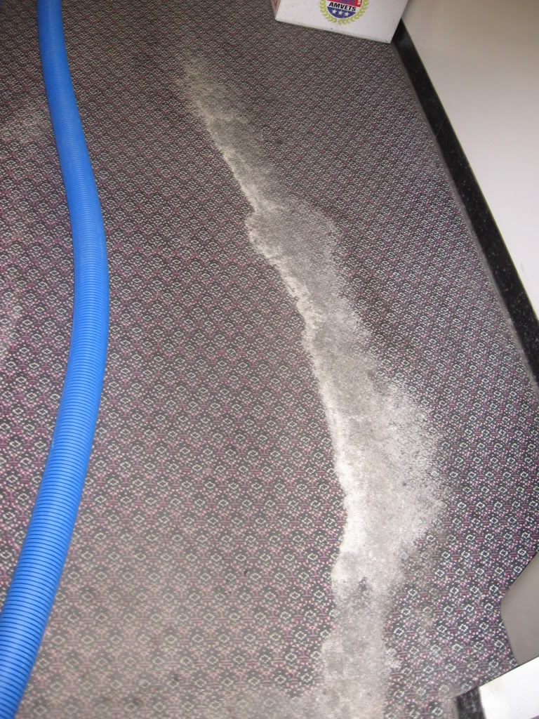

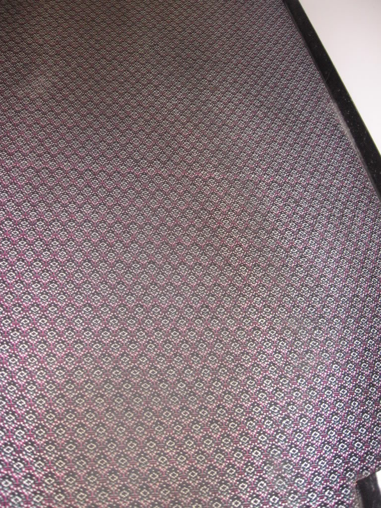

Keith
This one was like concrete:
I just hit it with Powerburst about 1/2 hour before I was going to clean it and let it sit, then I sprayed it again and let it sit for about 20 min. and extracted.
