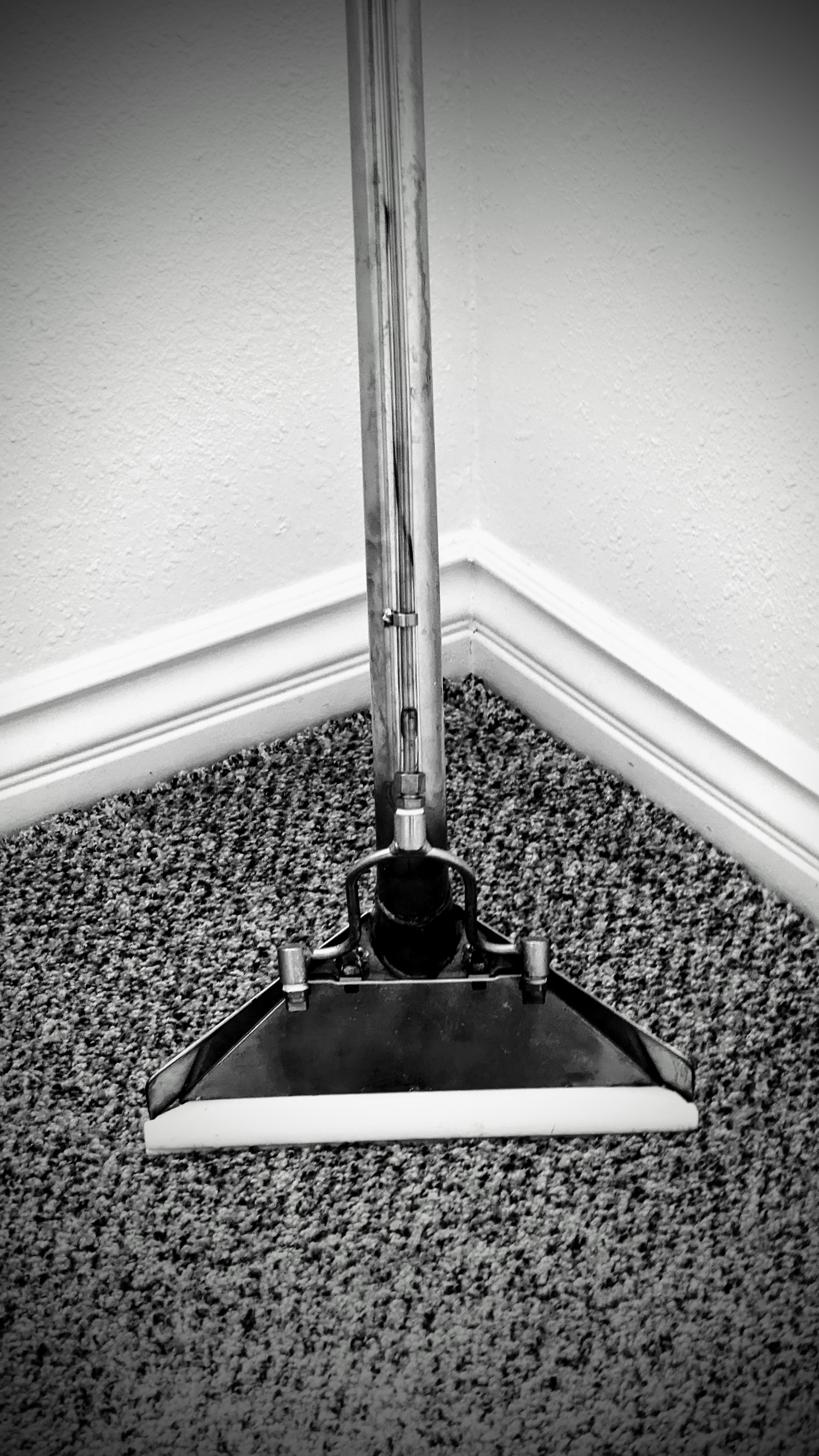

On the new wand, the spray seems to be hitting the carpet without hitting the glide. Being on an angle, it seems like it is likely to overwet. So far, the more I use it, the more I like it. Great with the portable, even better with the truck mount.

is that the reason skimming the glide is OK?
Nope I've always been okay with titanium and sapphires and all the rest skimming the Glide 5% or so and actually adjust my manifolds to do so.
I'm sure Fred can find countless conversations from the olden days discussing this very subject
There's got to be at least 15 manufacturers of this wand, and I joke that there are 28 which is why the Hank's Brothers chose the skew of aw29 and all of them Mount the pods a little differently so we allowed for air and as I said I sent many beta kits out and tested at least 12 ones on my own through various volunteers.
I've also sold more than I can count that I've installed on the Westpac version of the aw29 and as I said earlier Matt's is the only one that's completely striking the Glide but I have to wonder if he didn't insert them more than three revolutions
Keep using it and you'll probably throw away or sell off all your other wands...

Just sold 3 Glides to one company for this beautility wand. PXL_20230621_190343997.jpg

Alright Mike, I pulled the benders off the stair tool and put it back on my aw29
I installed it the same way from your instructions and got the same result. Here’s a few vids of how it sprays. If this is normal, then I stand corrected and I’ll trust it cleans as it should
