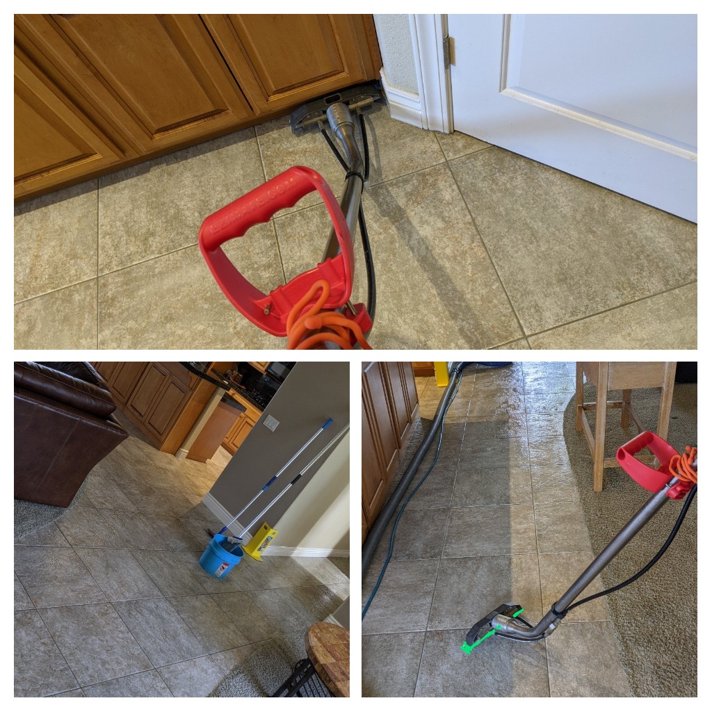

Who here enjoys using a Spinner?
Its certainly a must have tool, but:
T handle, ugh
Corners..
Tight spots..
Edges..
Recovery...
I've always preferred a HS wand for light soil situations on tile and stone but every one of them is a clunky, poor ergo'd, streaky, soaking pos....
A carpet Glide does okay on some floors but over spray, clickity clackity, potentially damaging to vinyl, wood and other coated surfaces AND doing so wears on the Glide quickly, right?
So I made the answer.
16 floor cleaners used V2 in North Carolina and all agreed, I nailed it.
and one of them use to work for Turbo Force.....

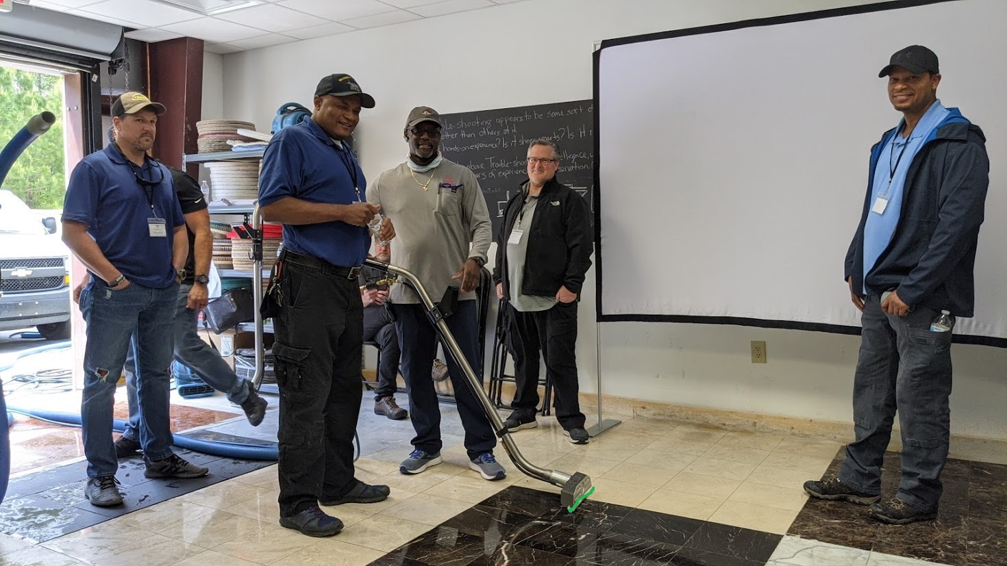

so you can use on polished marble without any damage?
What is the chance debri gets into the contact points?
Is this a retro fit or add on?
117,347
Take off your carpet glide put this on and brushes protect the floor from potential scratching ..but you got a lunk head employee who somehow manages to suck a chunk of gravel in there.. well that could happen with any extractor tool
117,347
As far as scratching polish ed marble limestone etc, let's just say Stu Rosen was very impressed...
117,347
You have to notch your wand? Seriously?
I like the idea but it's going to a hard sell to cut the wands. I don't think Dan will go for it.
You don't need to ought notch any of the ones but it just makes it easier to get them off and on without stressing the bridges which will happen after a dozen times in either direction.
Well designed wands like the evolution, the sapphires with its internal fit and up-and-coming zipper wand and the existing zippers will be very easy to swap out
But if you recall back in the early days of glide development when everybody was trying to figure out whether they wanted whole hybrid or slot everybody was trying to cut a groove and their titanium splash guards and it was like a beaver trying to chew through cinder block but now that we got angled grinders and aluminum headed wands it's a piece of cake to cut a little notch there and it doesn't hurt a single thing and if a customer ever said oh my god there's a little chunk out of your wand wing down there get the hell out of my house I'll give you my two devastator wands for free
117,347
Hardly.
We're going to sell umpteen thousands of these things and anybody's stupid enough to not notch their wand shouldn't be cleaning hard floors anyways.
Hardly.
