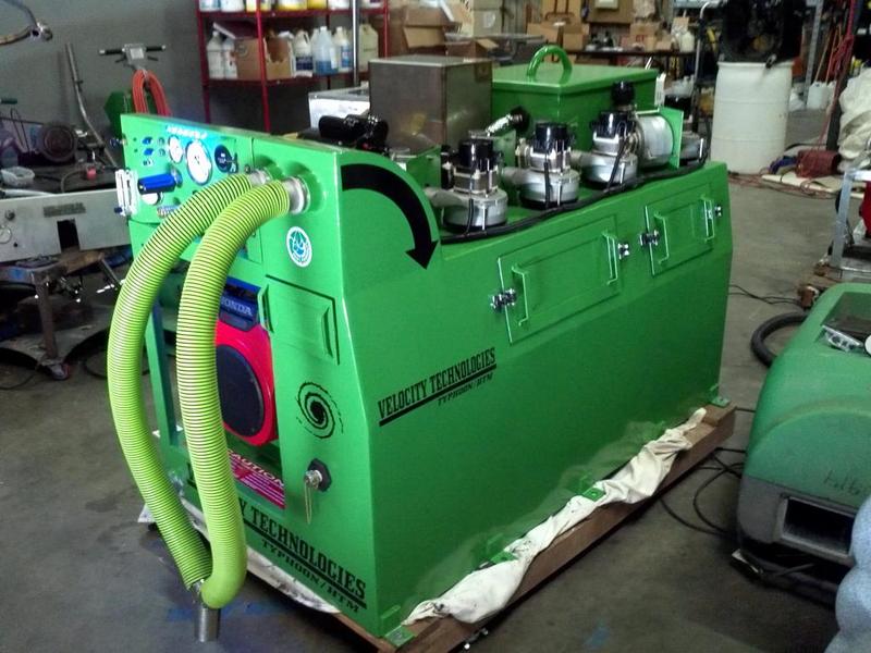

What in the Wide Wide World of Sports is THAT! Nice paint job! Is that a food processor or a juicer?
Gas fired engine driving lamb blowers? :eekk:
Different. :icon_rolleyes:

The Velocity TM has at least 5 vac motors that I can see . . .
The Honda engine is for the built-in generator . . .
Every model I've seen looks different from the last model . .

That one could be a unit of my friends from Minneapolis.
That company (Velocity Technologies) went out of business fast and left a bunch of people hanging.
My friend had to do a lot of retrofitting and rebuilding to make that TM work.
He had a great plan to be more green and he has great marketing, but the initial receiving of the product, the remanufacturing of the TM was a bit disheartening I think.
Over on *** there was about a 150 page discussion going on over there last year because someone else had also bought one and did not get anything for their money.
I have not seen this in person yet, but I know he has it working. Don't know his future plans, but he went from a Vortex (might be the one Jim Martin bought...)to a Butler, then to this.

In the right region of the country (the south and the southwest) where electricity and not natural gas is the primary utility for furnaces and hot water, the ETM is an excellent choice as you can easily access a 220 plug and fire up these machines. The Velocity machine generator should not be utilized except as a last resort and then with additional cooling as the gas engine melts and destroys the electrical components and vac motors due to it's placement under the machine. An interesting idea but retardedly engineered.

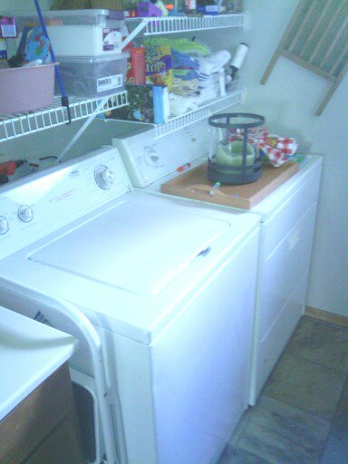

Reasons empties are fine that's if they have a 220 dryer outlet up here it's pretty much 50/50 if the dryer is electric or gas not very good odds
The new dryers or front loaders have stands and higher and give no access to the 220 plug.

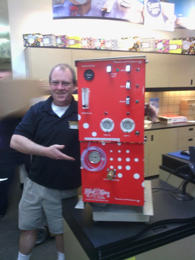

So I went back to a 2 110 machine the techo viking which had a nice run and sold around 10 of them all are still in use and making money for their owners one nice thing they seem to have a good resale vale too.
the Technoviking very small compact not counting the waste tank in weighs in around a 100 pounds
how the heck are you going to use the dryer outlet

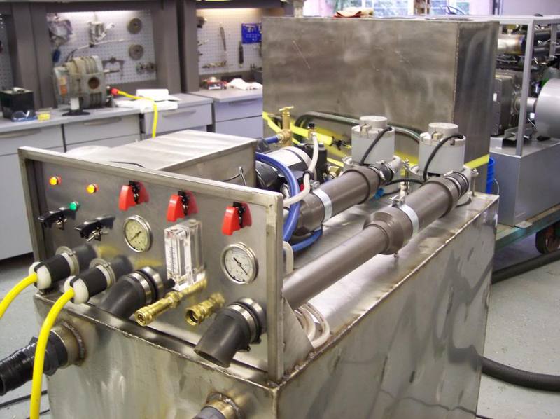

this is the original nordic1
this machine is or was just a test bed and never sold

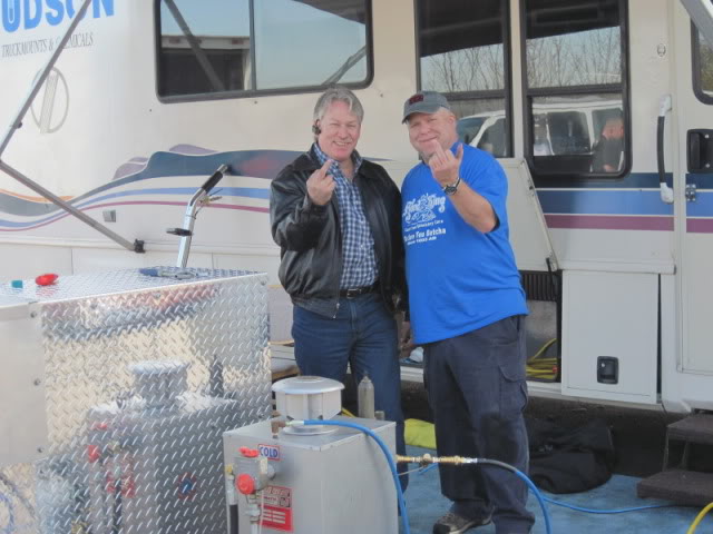

then it morphed into a more portable version which was used at MF in Nashville this machine was sold but was rewired to only run on direct 220. it is being used as a shop machine.

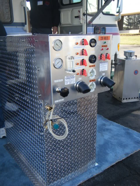

now the final version of the nordic1 smaller and more compact with the ever famous cylinder waste tank
none of these were sold.
