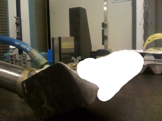

I'm not selling these, so you don't need to delete this!
Just sharing:
Well, even tho I don't care for Glides, I made one for my Prochem Stair tool !
I made this out of "PEEK" 1 INCH ROUND.
What is Peek? it's over $5.00 a inch. WOW!
:Superior chemical resistance
:Good abrasion resistance
:Flexible with high tensile strength
Now I have a GREAT Washboard Glide for those nasty matted down dirty STAIRS

peek was one of the materials I tried along with delrin, rulon, glass filled ptfe etc... in the end the regular virgin teflon worked best.

Teflon is not any good if you are looking for agitation!
And longer life.
And I can take it off & put it on with my fingers! (Great Material) SNAP! :wink:

Vacuum is the real agitation, if you think not, disconnect your vac hose and push that slider.....smooth as silk on presprayed carpet.
If a guy needs more agitation, he'd be ahead to just break out an agitation machine and charge a nickle more, and do the job right.....in my humble opinion.

Well, that's hard to do on stairs! lol
And NO you can't push a "Washboard Slide or Washboard Glide" easily with NO vacuum and a ton of prespray! WHY ,. it's those grooves man! They are sooo awesome, that they will scrub paint off the carpet! Just read what user's have to say.

I just started using the glides about 6 months ago when I hired a new helper and he couldn't push the wand. Needless to say I loved them and will never go back. My only complaint is that they wear out to fast. After 3 months they are flat with lots of deep grooves. I wish Teflon was more durable.

There was a point in this Ad somewhere, FLAT and a big ass slot, and additional grooves does Not GLIDE very well, nor dry very well, so is it really a stair glide?
Honestly..it's kind of the Anti-glide, let's see if Mikey would like that on his Vortex?
As for wear, keep your teflon glides Round as best you can, a little block of wood and some 80 grit or a Rasp will make short work of keeping them round, then follow with some 120 grit, it'll also clean them up nicely. keep em' round and they will push easier and extract better.

Your not to bright! Now I have a GREAT Washboard Glide for those nasty matted down dirty STAIRS! (Get it ? WASHBOARD, FOR AGITATION :roll: ) And the slot is the same size as the stair tool ! :roll:
Not designed for easy slideing! :roll:
