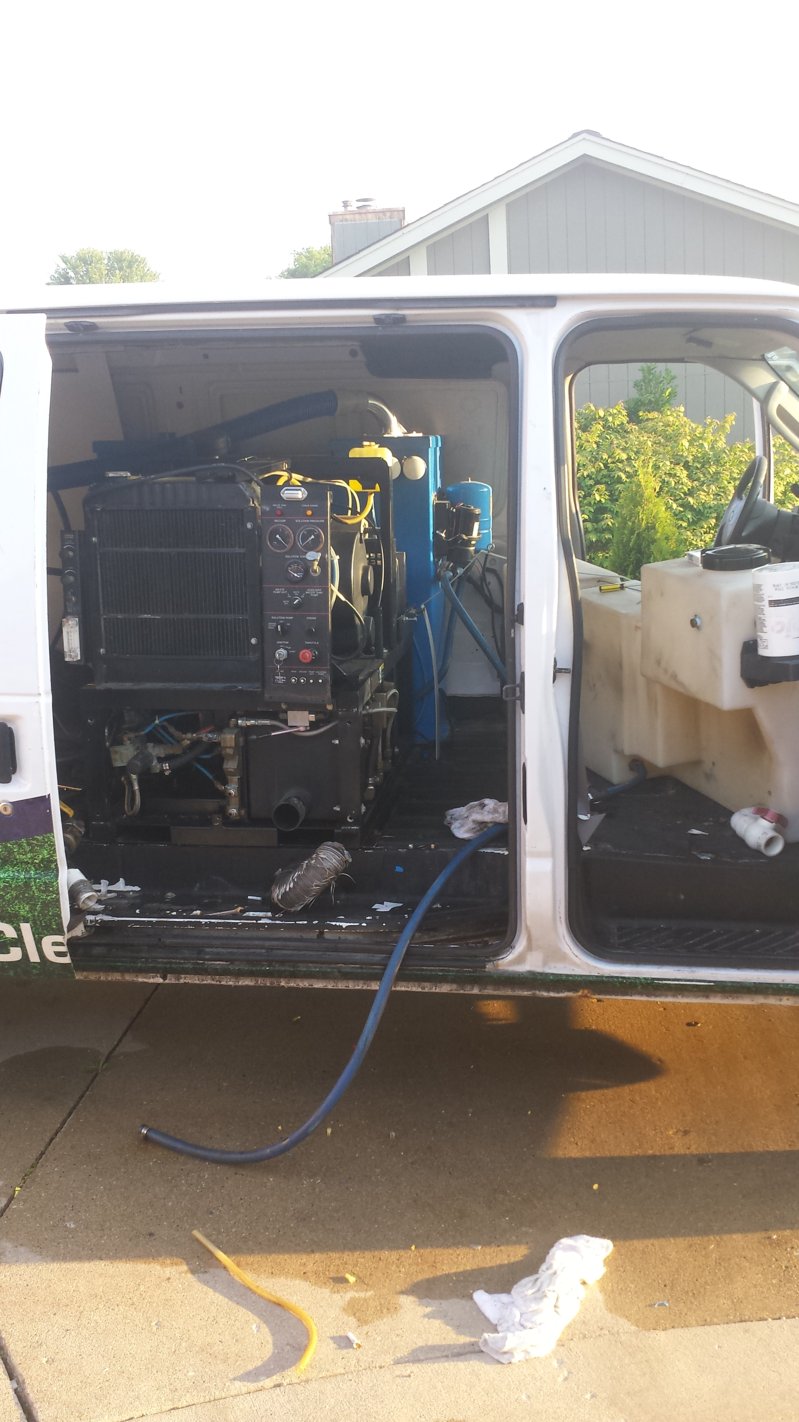

My Apex will only run in the override position..
Able 1
Apr 12, 2008
6,469
Wi
Keith
To get through last week we wired the switch so we would bypass all of the shut down sensors..
So far I have:
Replaced the shut down relay
Jumped the wires to the waste tank switch
Replaced the solution pump switch
Changed the oil pressure switch(from my other Apex that runs)
Changed the high temp switch
Am I missing something?

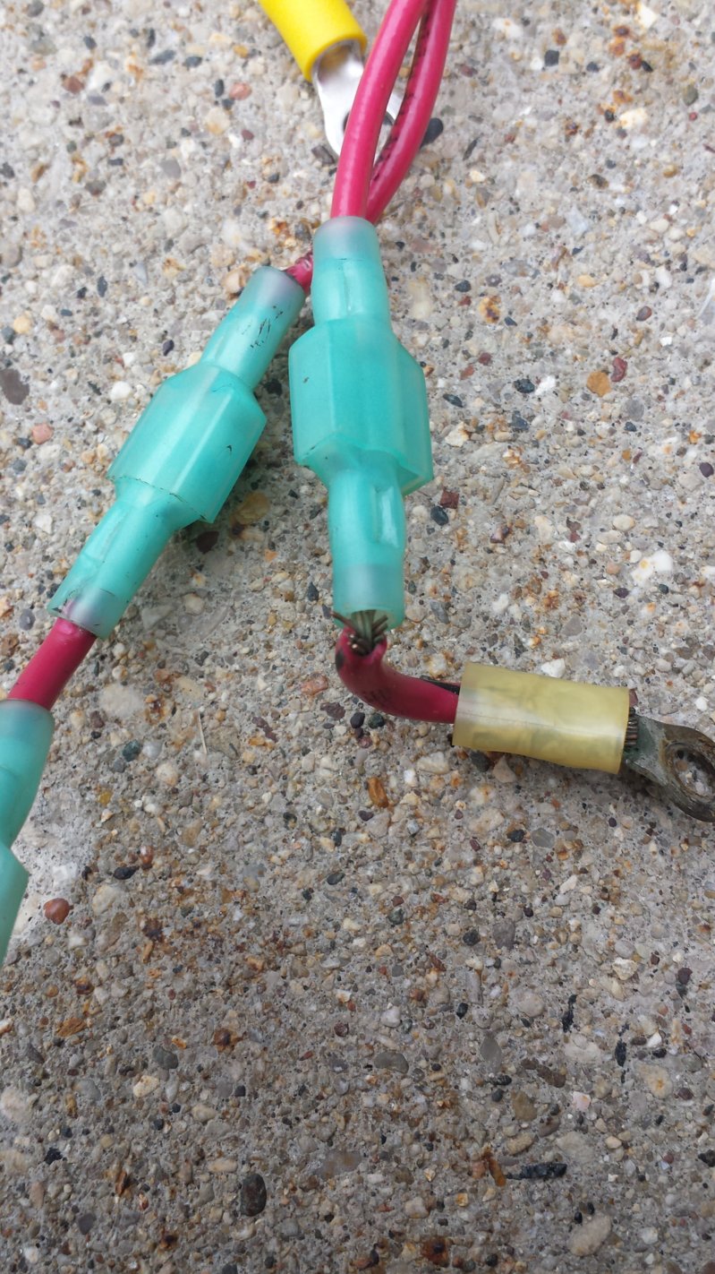

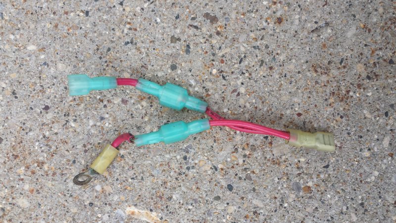

As I was poking around I found this gem!!
Hope this is it!!!!!

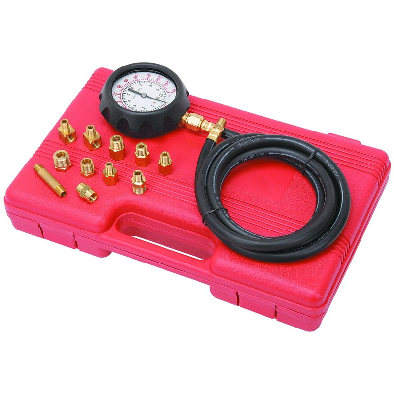

If it's the oil pressure switch, most I have seen are standard 1/8" or 1/4" pipe threads. You can buy an oil pressure test gauge from a good auto parts store that will thread right into the port.

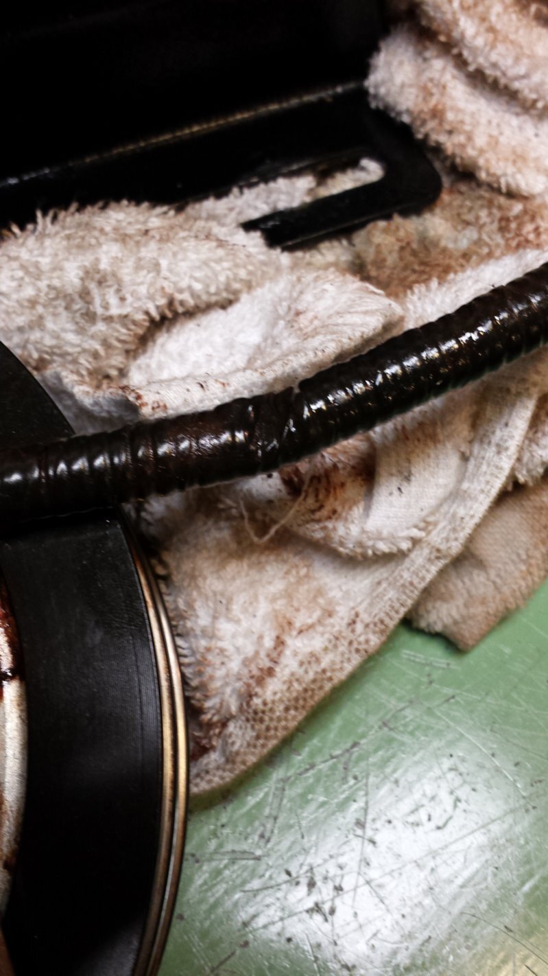

One of the wires going to one of your sensors may have a worn spot causing it to ground out. Trace them all. The best way to find a shutdown code is to remove only one at a time. if disconnecting it doesn't fix it I would leave it connected. I would also use a meter. You can check for continuity and if something is grounding out when it should or shouldn't. Look for a wire that's chaffed and touching.

I did one at a time, it has that black wrap around the wires.. Though I will take another look..

I had two wires inside all that wrapping that had rubbed together enough to lose its shield. I ended up making an entire new harness. I got all the colored wires from wire barn and made it myself. It was slow and tedious but I got it done. My neighbor had the tool to crimp the ends before inserting in some of the special plugs. I was able to buy most of the plugs I needed from batts racing. It has to be a sensor or a wire in my eyes. Definitely where I would start. If it's a sensor removing them one at a time will locate it. If it's a wire that won't work but will tell you it's not a sensor. You can also test the sensors with a meter. They should all be open except the float which you've already solved. The spot can be so small it's easily missed because you have to look all the way around each wire.
