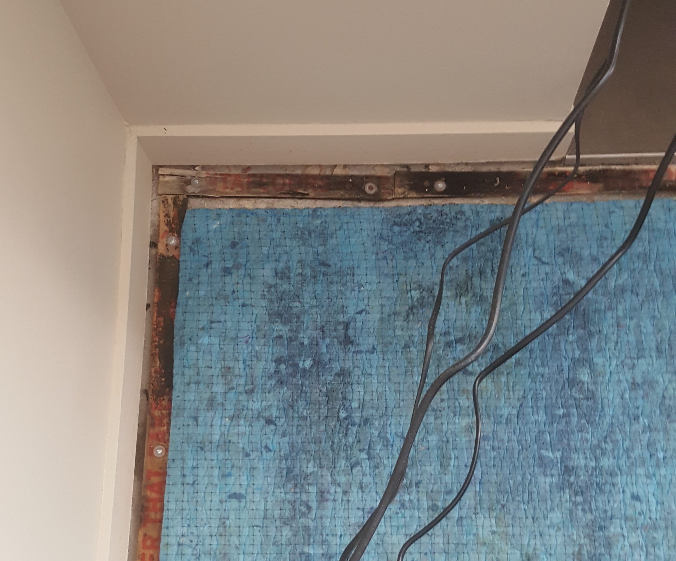

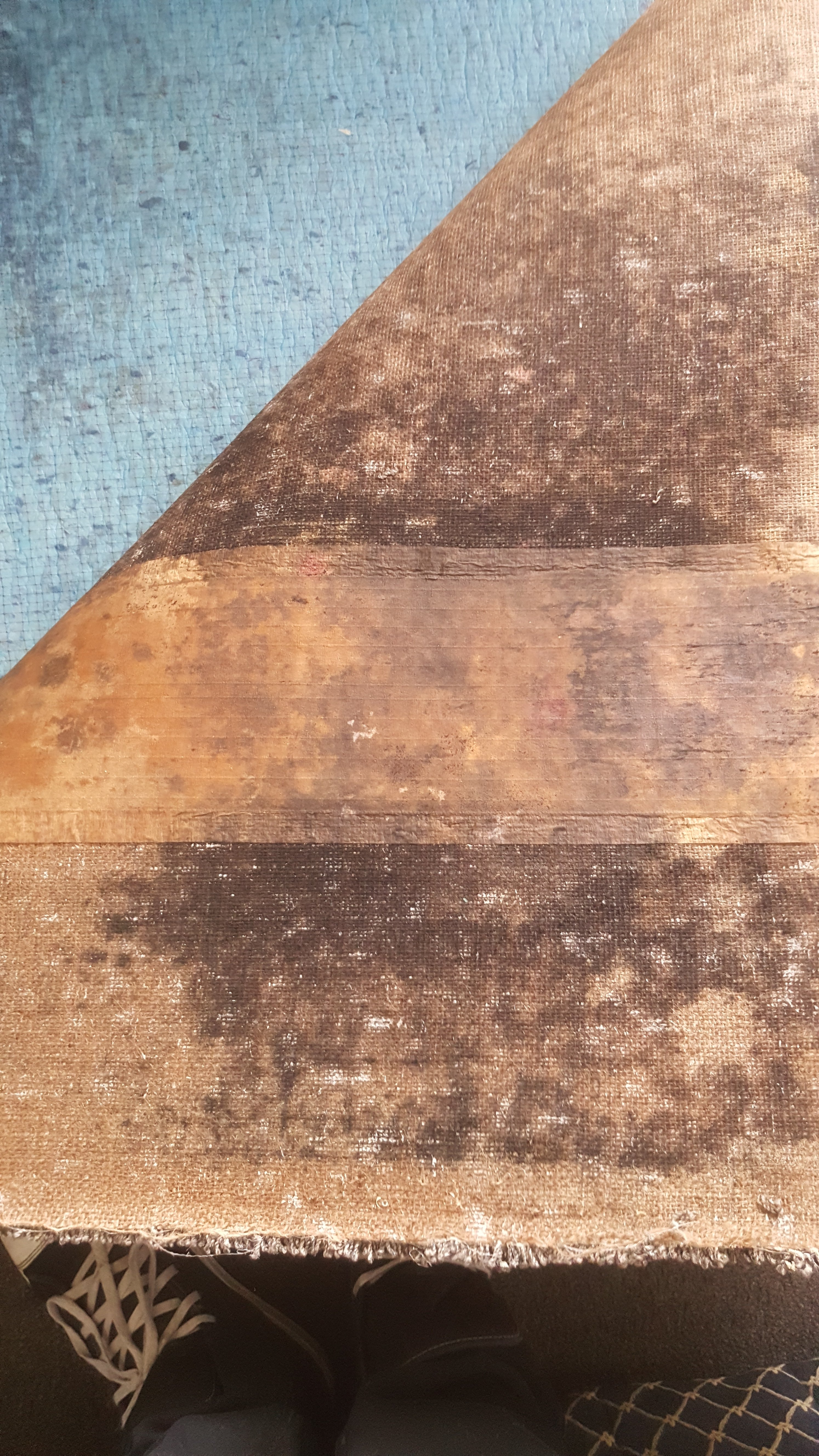

Found few areas in wall towards the ceiling and on ceiling at 43% wm :eekk: lifted carpet and its dry and clean..
went to the adjoining room next door where there was no noticable odor and lifted carpet to find this hot mess..
well.. there was no odor it stinks now too!
