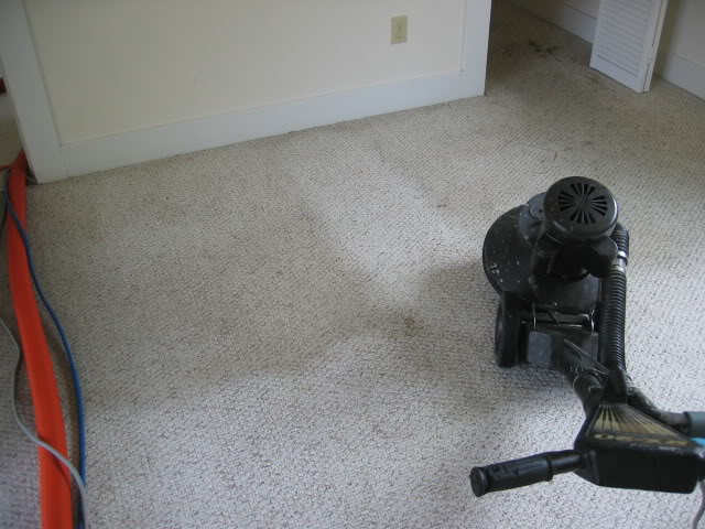

I need to get my RX 20 running for some big commercial accounts. I am killing myself wanding these 10-20K sq. ft. monsters. Most my Saturdays booked out for a while....
I am going to see about just getting a new head. I priced parts at $500.00 to get it running straight plus glides for $200.00, or just a new glided head for $1000.00. Prolly just get the new head.
If I am running a greenhorn at 12 flow (4 #3 jets) what should I jet my glided RX at?

6 flow is plenty on mine. I have the HE head and it has 3 jets. It makes my TM hover around 200 ATM and it's plenty hot. Actually I ran out of water on one of my machines this week and the CDS kept up with my .10 flow greenhorn and my RX and both were steaming on CGD to finish a good size room. Of course the truck engine was probably about 220 and the temps outside were around 100+ so it may of been that it was hot enough for that one room and maybe would of cooled down if I kept running it like that. I may try it some more shortly, it will be nice to save some cash not having to buy propane for the 2nd machine.
