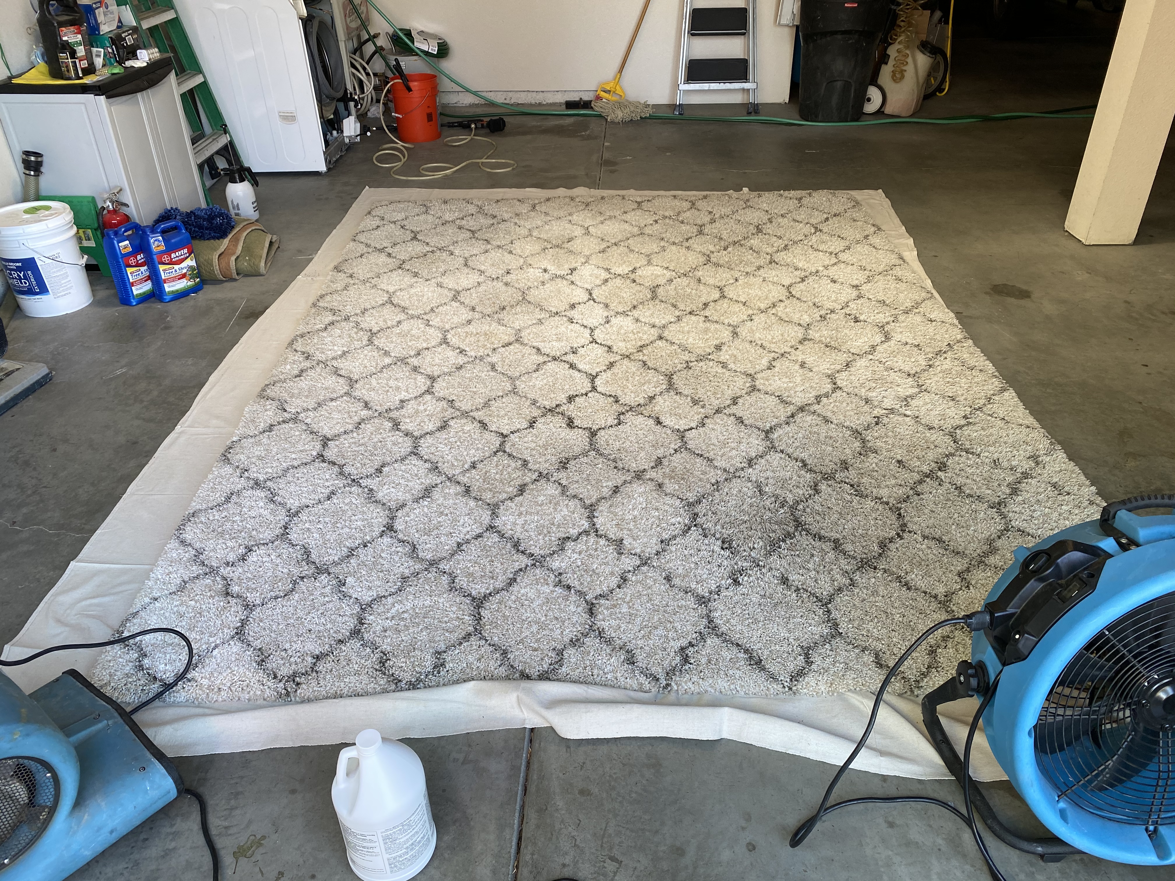

Well my crappy rug browning went away. But the dark areas are wear. These poly rugs really are shit.

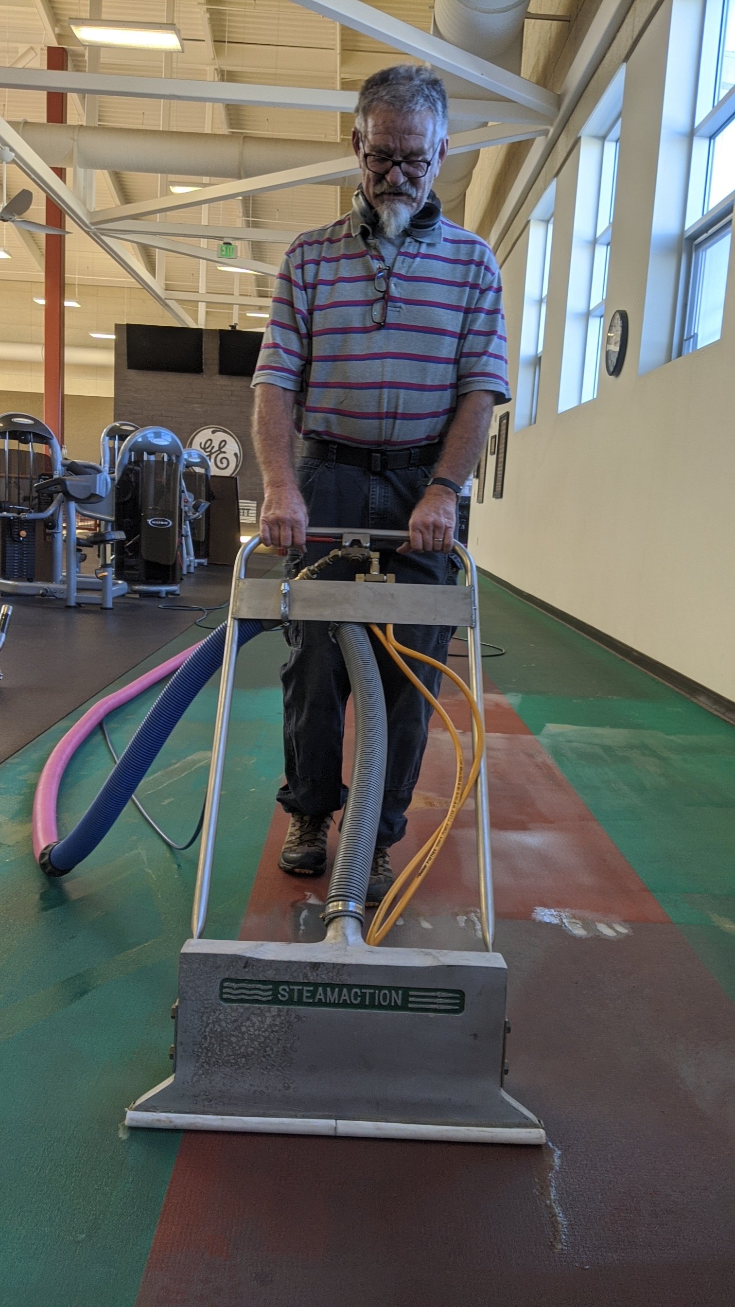

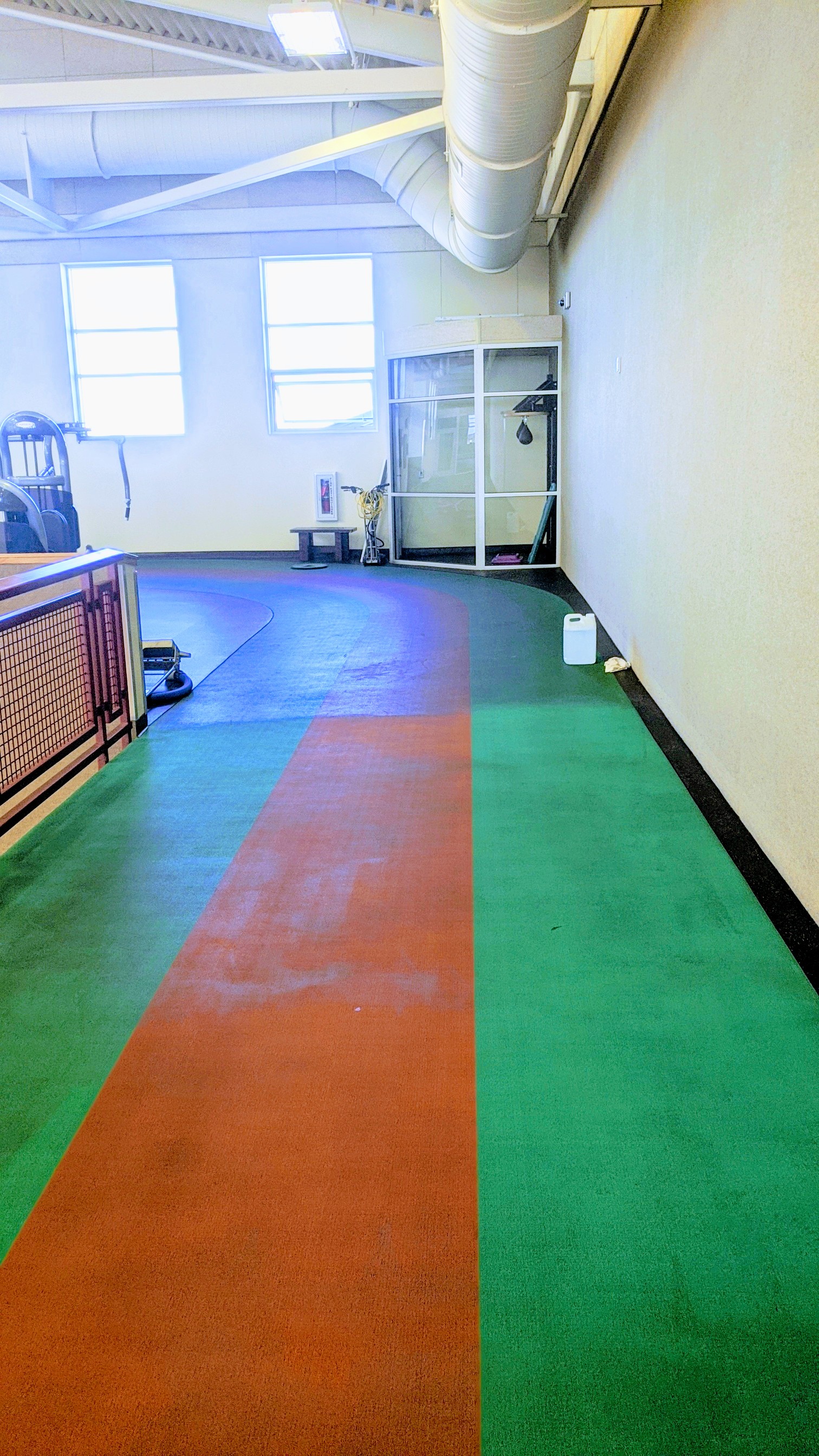

Today we tested the following:
mega strong Tsunami.
MST with a stripper boost.
Just stripper.
SPP pad.
Groves cut into a Green pad.
360i BH.
Drag wand to speed up rinsing.
All for naught.
The winning formula is a high pH encap with a d'limo boost and rinsing every 75 to 100 feet before it starts to dry
Than a post o'Pad w/ ammonia follow up the next day to remove the wicking
