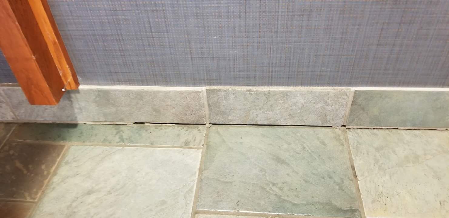

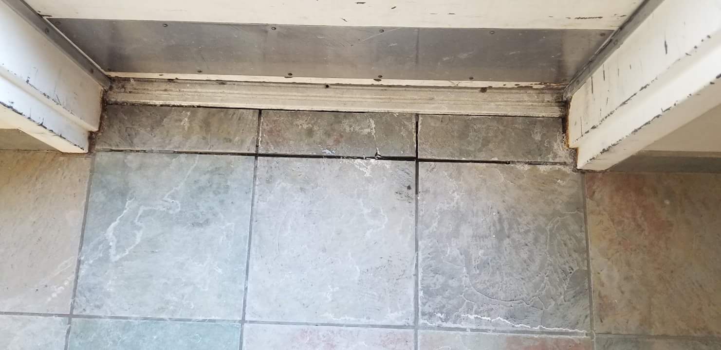

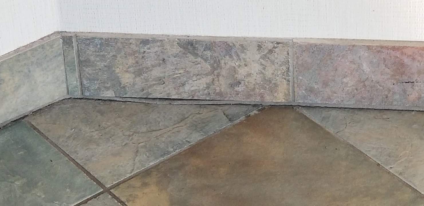

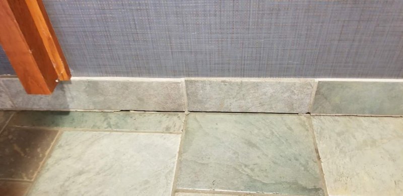

I've been stumped on how we are going to deal with the gaps between the tile floor and the tile baseboards at the Minneapolis RMH...
As you can see in these photos, the constant freeze/thaw cycle is causing the grout to pop out and where they have tried to re-grout, it just happens again. I believe Siliconized Latex Grout would not last long either due to it's lack of flexibility and plain silicone would look horrible.

The gap size isnt that bad, ive had much worse before and had to use backer rod just to be able to fill in the area.
You might have to go with straight up silicone unfortunately, maybe http://colorriteinc.com/ has something thats better?
