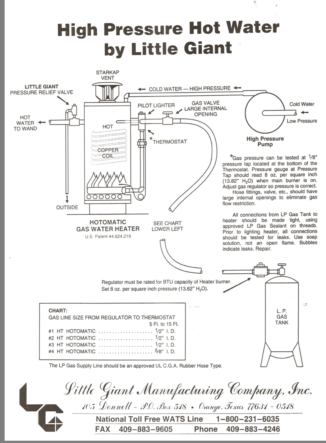

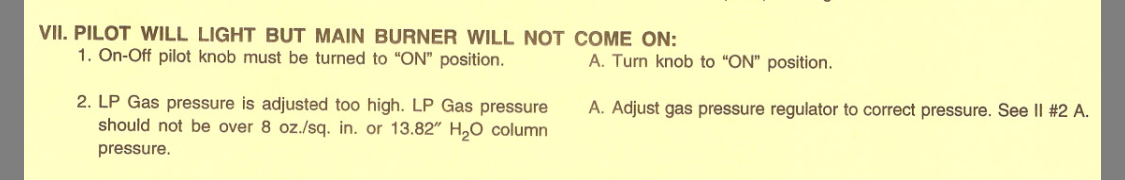

I would assume that it can. Here is the info on testing/adjusting

Thanks Fred and dealtime. I called Les and he immediately pointed out that on front of the valve there is a dial and the stopper on the shaft behind it sometimes needs adjusted. I turned it and sure enough the valve was not opening or closing. I have adjusted it according to his recommendations and it sounds like it is working now. I am going to clean the burner before I put it back together. I'm confident that was the problem but I'l let you know.

Okay Guys my heater is back in business! Behind the temperature control dial on the front of the Unitrol is a lock nut and a stopper on the shaft that was out of adjustment. I adjusted it so it click in and out at the "70" marked on the valve. I cleaned the jets and put it together and sure enough it fired. Thank you everybody for your help. As I was running it it didn' seem to be as hot as it used to be, I wonder if the new regulator was more restrictive than the original one that came with it. Any thoughts on that? Does it use a higher volume regulator?

Someone may have tweaked your regulator to get more heat. Probably why the nut was loose. You have put it back to stock. Adjusting up or down from 70 will change your maximum heat output.
