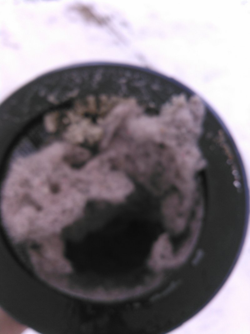

Yeah, I mean, to each his own, but keep your filters clean and turn the RPMs down a bit if that's what it takes.
My first apartment today.
I'm not stopping to change it out at apartments. Someone's home yes I do keep it cleaner. I filled it up again on the last job just before I had a breakdown.
