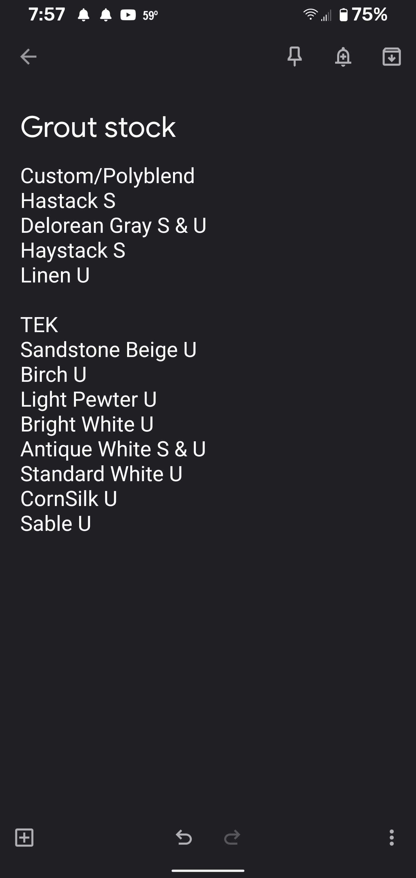

Keep a grout inventory list on your phone
112,588
This is my Nevada list, our California list would probably be three times as long...
Super handy to have when you're giving bids so you know whether to include the cost of the grout and the cost of going to get it..
many customers choose to keep the grout which they can rightfully do since they paid for it but a lot of the move out situations tell me to keep it..

I guess you don't understand what I'm saying these are colors I physically haven't stocked left over from projects Don't you think it'd be uncomplicated for me to know which ones I have while I'm giving to estimate so that I can reflect the price of either myself or the customer having to go get more and yes I do 5 to 10 a month so I guess I am a professional
112,588
for my customers and my techs, being prepared is being premium.
I get that certain situations ( move outs, apartments, the colorblind) might not give a damn about color accuracy or long term durability, but I and most of my persnickety clients do.
I'm sure I could talk some into "close enough or good enough" but I enjoy complicating things I guess...
