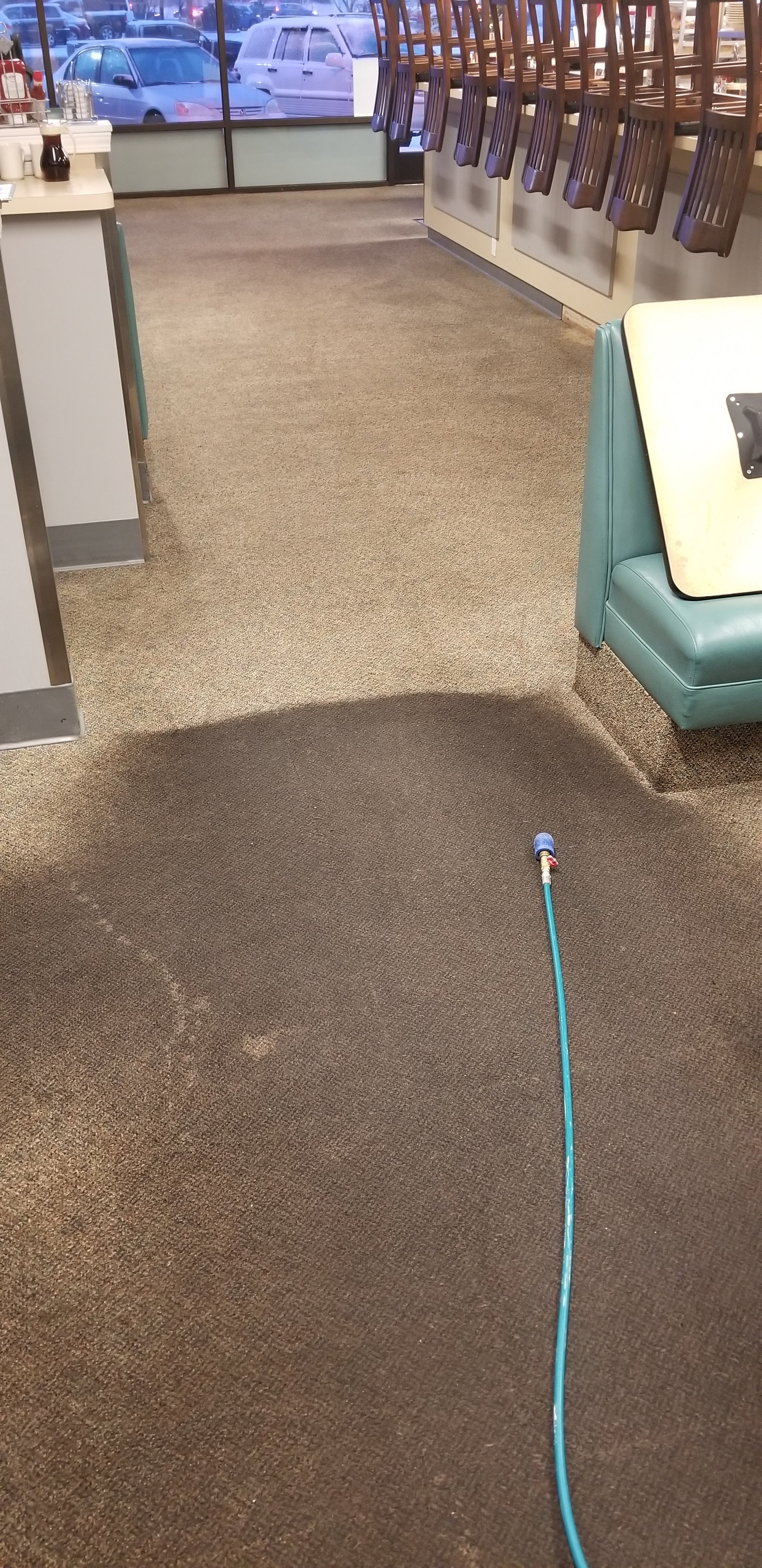

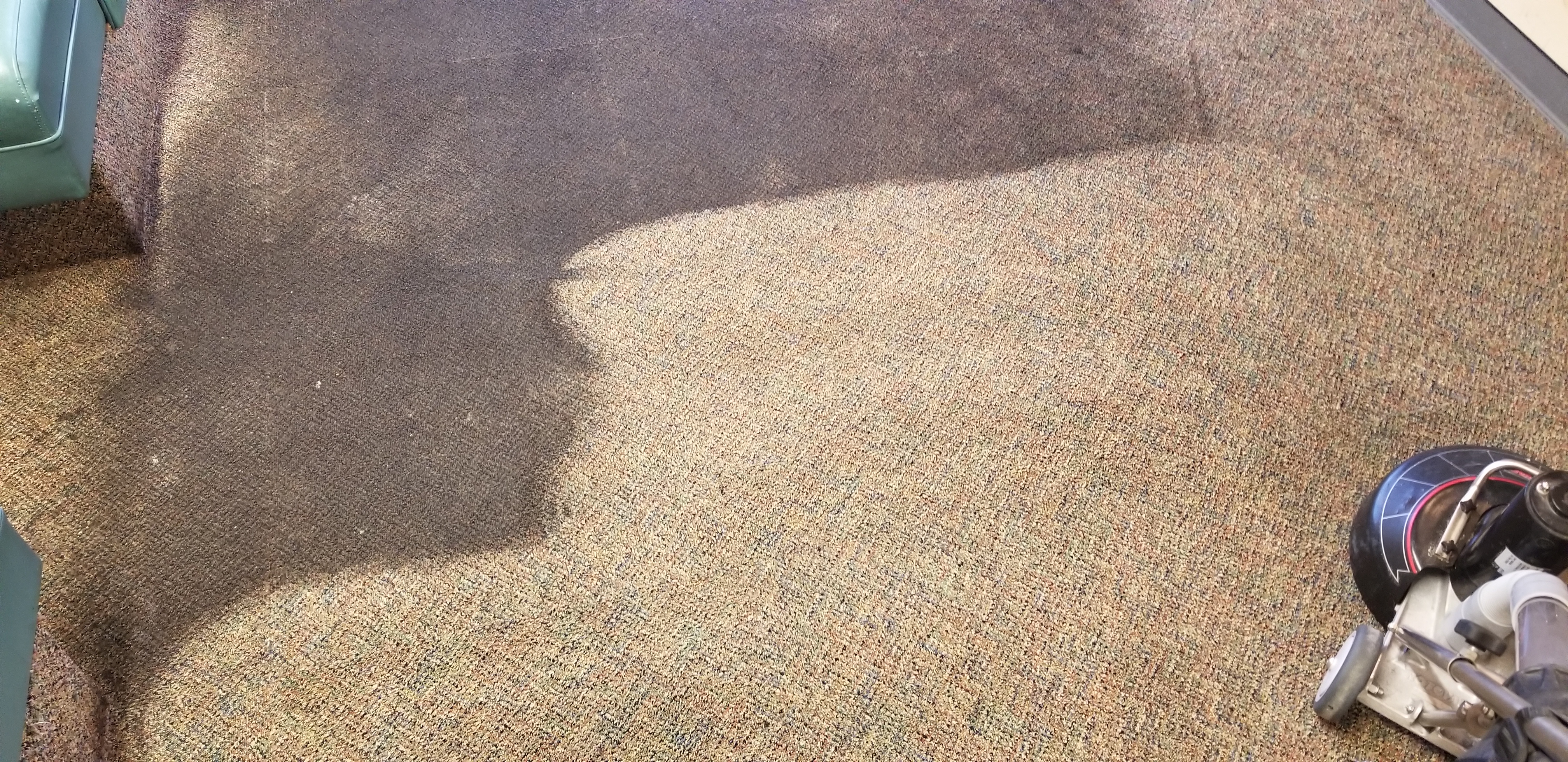

My worse shit pit restaurant is on for Tuesday afternoon.
You've seen the videos.
I've used the following methods in search of the quickest method..
175/Red Pad and wand rinse
Cimex pre scrub and wand rinse
Cimex and 175 post pad ...dont shoot me, it took the longest but stayed looking best longest as well..
175/Red and 13" Zipper rinse
175/Red and Wand rinse
360iBH and wand trim
Gonna give the Peppermint Extreme the real test.
