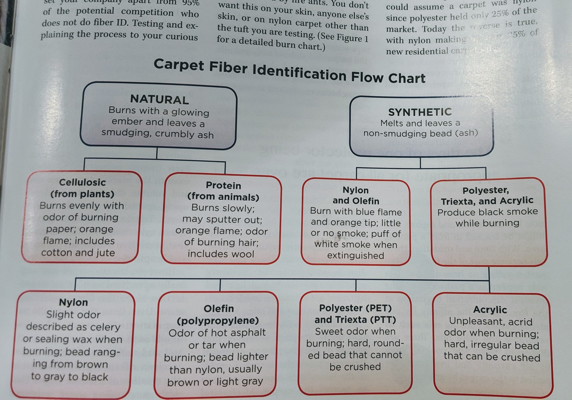

Despite my interest in testing being done on uphosltery fabrics, I have not had much interest in identifying the differences in carpet fibers beyond "wool" and "everything else" for the reasons indiciated above.
Until recently......
Its bad enough that idiots are making area rugs out of viscose and lyocell. Now they are making wall to wall carpet with the stuff. If you think polyester and triexta are garbage, wait till you get one of these.
I'm not saying to burn test every carpet; I'm saying to ask some questions when the carpet is within a year or two old, and especially if its had weird reactions to your customers' spotting efforts, or even the spills themselves.
THEN maybe do a burn test.
These are not isolated incidents. I'm getting calls, emails, and texts at least weekly.

Warrington had a long, boring, useless article on this very subject in Cleanfax. Bloviation at its finest.
Thank you, Marty for bringing my name into this conversation. I live for publicity.
The article focused not on the cleaning procedure for different fibers but on choosing the fabric protector that will provide the protection that a specific fiber would benefit from.
In my days of operating a cleaning business, I found doing a burn test and discussing fiber differences a big marketing advantage. I think it would still be today with so few technicians doing any testing.
If you find no use for the information, OK with me. Leading horse to water and all that.
