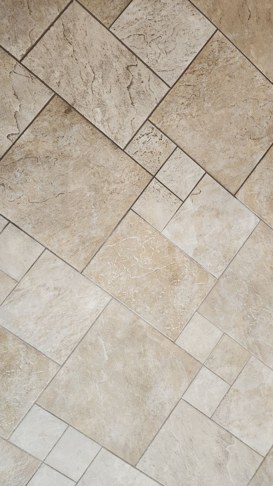

Equipment failure right away, and grout lines look dingy after scrubbing with a high pH cleaner. So this is why folks use acid grout restorer and price accordingly if the customer wants to pay for it. It's all ceramic. Off to my local supplier. I'll be here until night time. F#@! it, I'm going to make this floor sparkle. I want those after pics for my profiles, and a hundred church goers marveling at the stunning tile and grout. This is fun.

Yea that makes sense. I only ended up doing an acidic grout treatment in one small highly trafficked area anyway. It was fun to try it and see the difference. I fully dried the area with air movers after the initial alkaline cleaning so I could see what the grout really looked like, it improved a lot after scrubbing it with the acidic cleaner. I can see how one can restore grout to an extent using it.

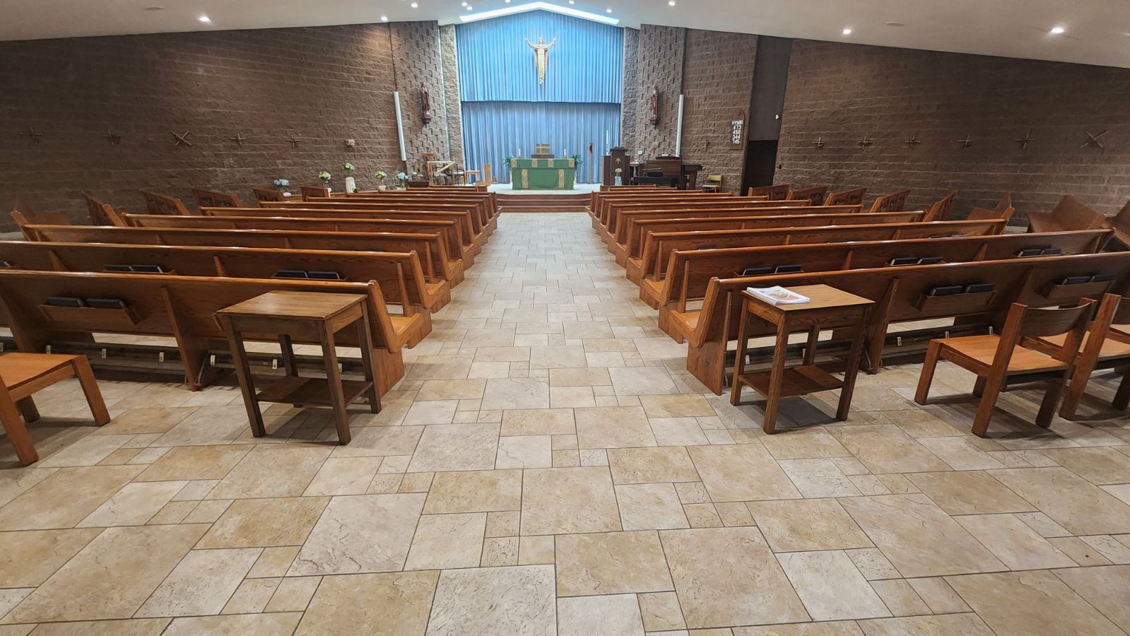

That was a way bigger job than I thought. Scrubbing around all the pews and moving a bit of chairs and small furniture took a while! I priced it higher than any other commercial work we've done but not high enough.
