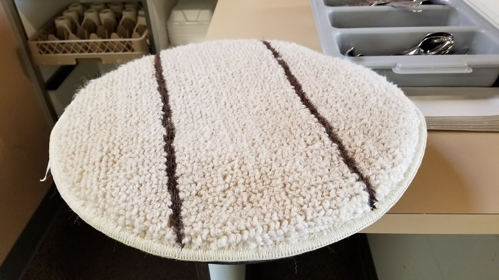

I need my AT and a Zipper SS
113,222
anything less is a fooking pita.
But I got er done.,..
Pre vac'd by me witw their 887
Mega Pre Spray, 175" w' brown stripe Tuway
wand rinse with Formula 90.
Had to re-pre-spray about 5 small areas.
Wanding was real slow and 3 wet, 2 dry on average.
Acp

Are the tiles fraying because of the 360 or traffic. I have a ski lodge bar that looks exactly like that after one year. Skiers wearing their boots in for a drink.
113,222
I hope not and don't think so.
Their other locations don't have tiles and stay cleaner longer. I'm they should have yanked em after 3 months on a warranty claim

360 or your bonnet what really is the difference as far as aggressiveness on those seams. That is one reason why I bought the zipper SS you get the agitation without the aggression. Someone could easily make a claim that it was your agitation method that loosened up those yarns on the seams.

I've been sliding tables in and out because there is always stuff on them. I doubt I could get them to clear the tables for me but I like the idea.
Oh and I use the 15 inch crb on one restaurant for aggitation. Makes wanding a breeze.
8,172
Yukon, Oklahoma
Just your zipper ss maybe and probably, but not your AT. Maybe your cimex for scrubbing, but not better than 175 under tables. Looks good lone wolf, old man!!!
I've got the feeling that these owners don't care about their carpet that much.
