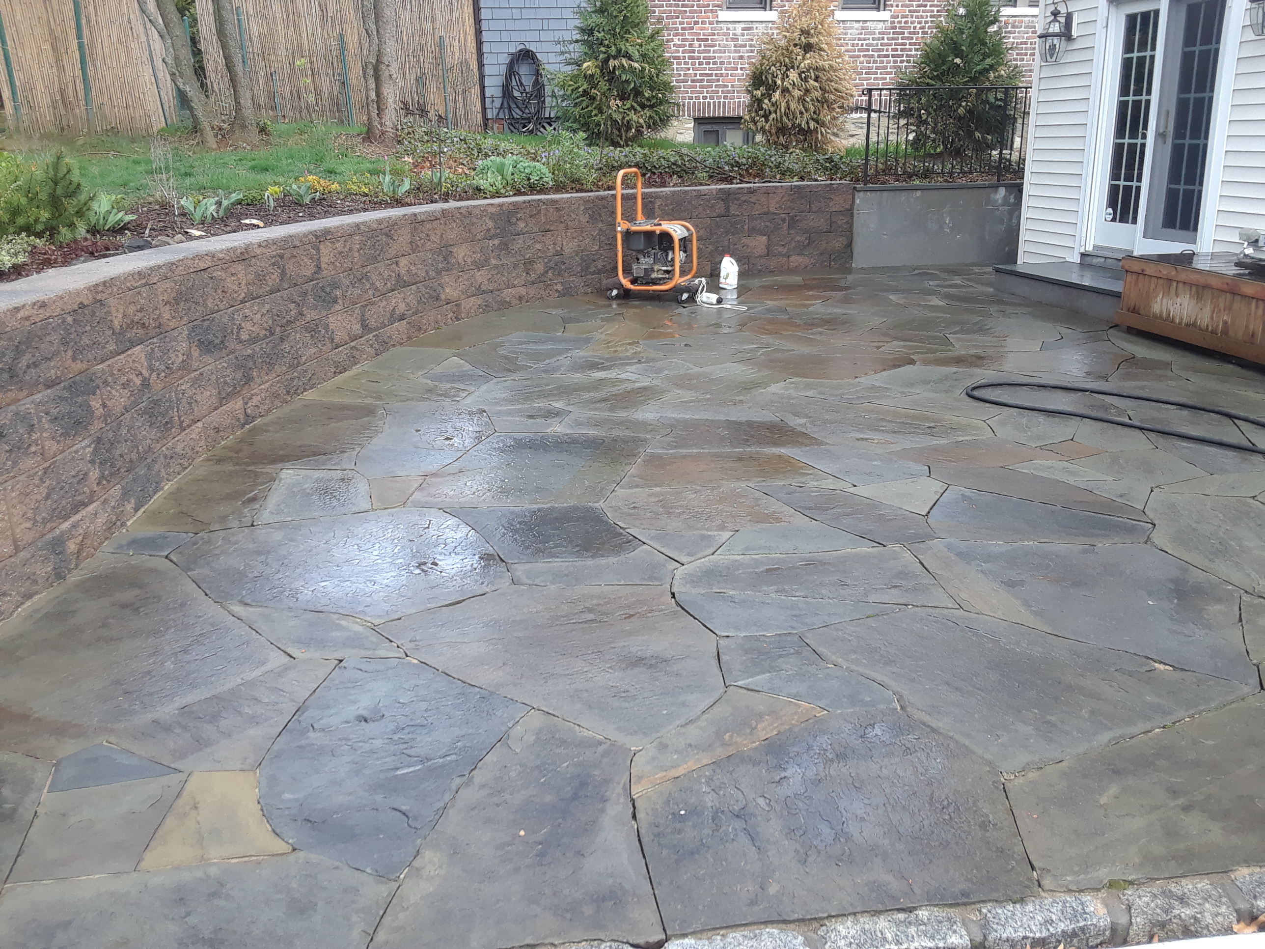

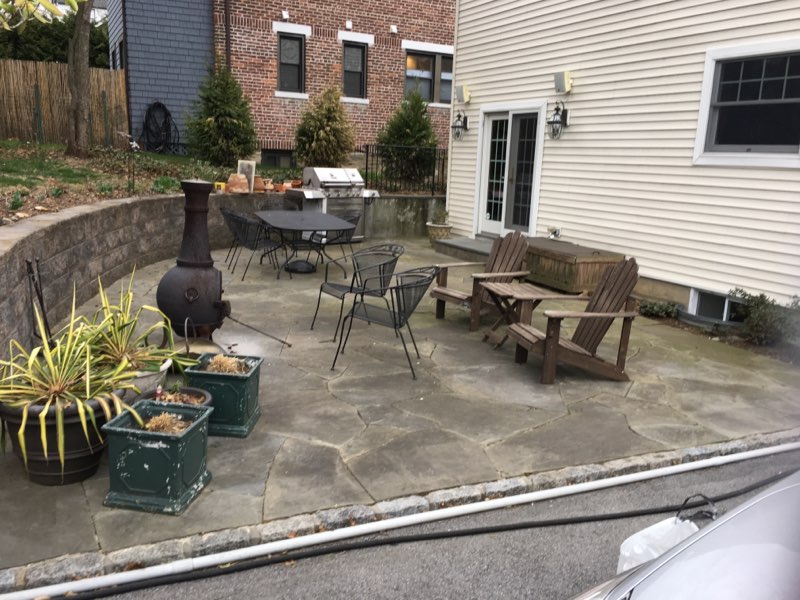

All this talk got me motivated to clean my gutters patio and sidewalk.
Tried the bleach product from Lowe's but still ended up hitting it with about 600 psi and a yellow tip.
Took about 4 hours last night.
Goomer
Feb 9, 2009
3,398
Bronx, New York
Frank Mendo
Looks good, did you run a spinner on that?
Just a long lance one stone at a time while trying to stay clear of the poor joints.
I use a high pressure ball valve on the end of my hose before the lance and tie the trigger valve open to make it easier.
Still tedious work.
