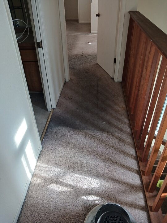

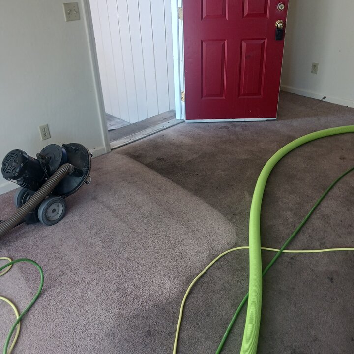

I believe you're looking at this backwards, the machine in question will clean nice homes where people respect and take care of their floors at very low cost low noise low fuel consumption and at some point in your career it'll be all you need..
Unfortunately where i live if i only did the "good" jobs id be outa business in a month. In a large metropolitan area you might have the luxury of being able to pick n chose which carpets you do but us country bumkins don't have that luxury. We have to show and play the cards delt. The good,the bad, and yes even the ugly.

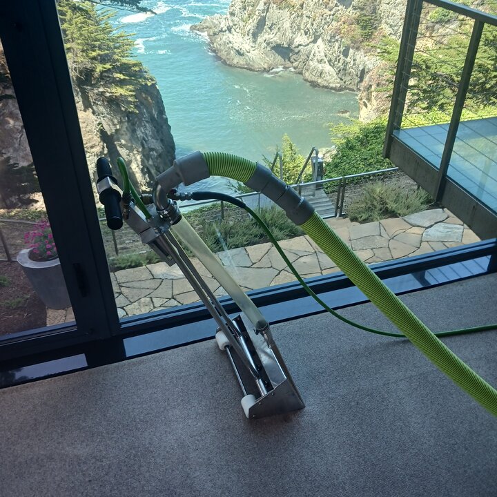

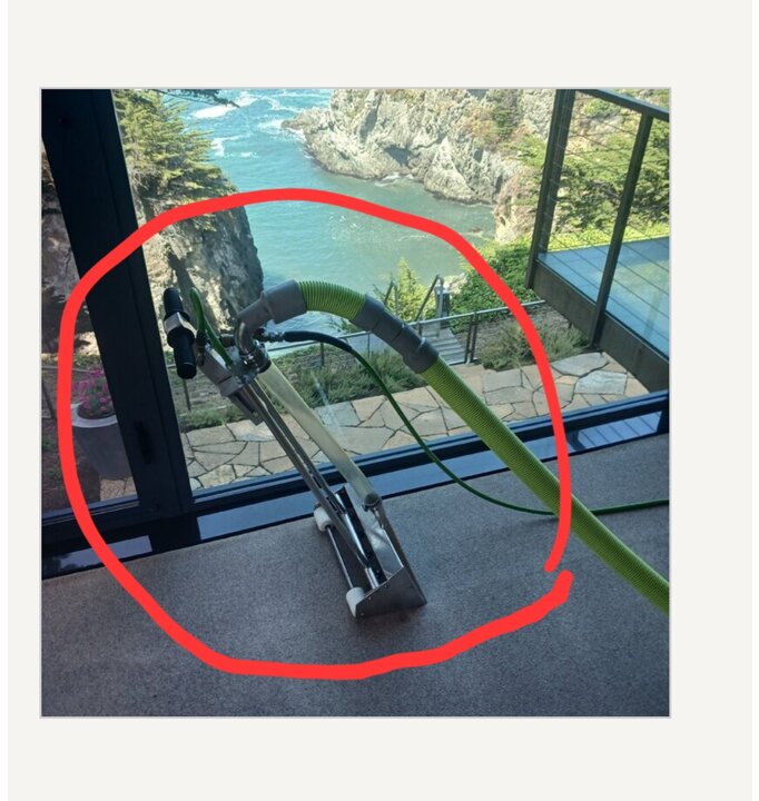

Dwain, what is this thing?
My secret weapon! Is wha sets me apart from others. It is an antique by manys standards. But really it is a steamgeni 16" 4 jet weighted drag wand. I.prespray then clean every carpet with a rotary extractor using emulsifier. When finished i switch to a rinse and completely rinse n dry using this. Rotary gets carpet completely clean and relatively dry. Following up with the drag wand gets the carpet residue free and very dry
