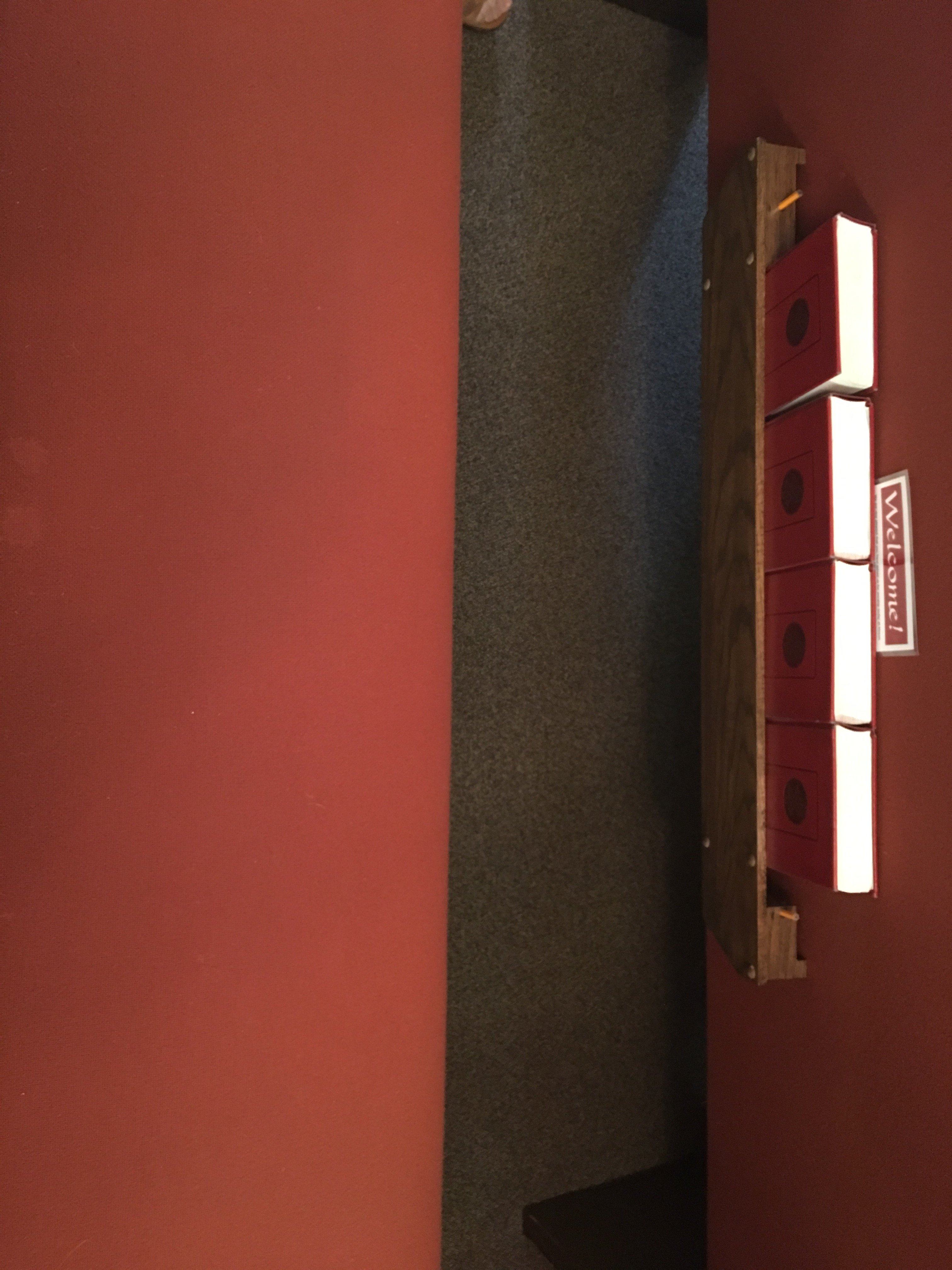

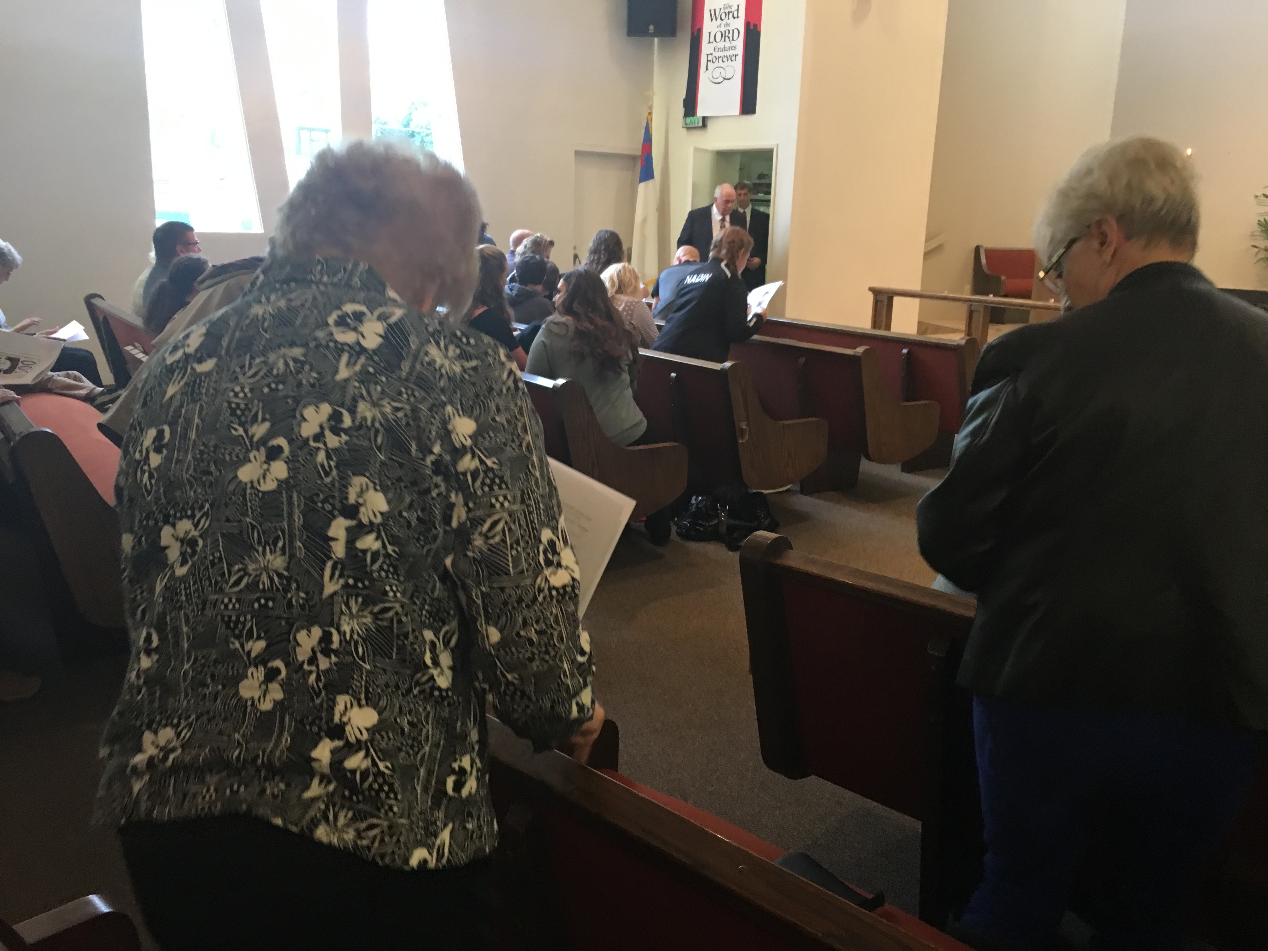

I’m sitting here in church surfing MB and wondering how I would encap this place. How do you guys get in between and under the pews? I don’t really want to use a CRB.

I did it just because I knew it would suck...and it did. A swivel would help but it's still going to be a tough job. Too many awkward angles.
I got the hang of it pretty easy. It all depends on which side of the pew you’re backing out of and whether or not you have an assistant pulling that hose out. It can be an easy job or a job in Hell. It all depends on those two things only
No assistant they were ecapping and another was cleaning chairs. And a few rows of upholstered pews.
I started at the front and worked to the back. It was never easy.
