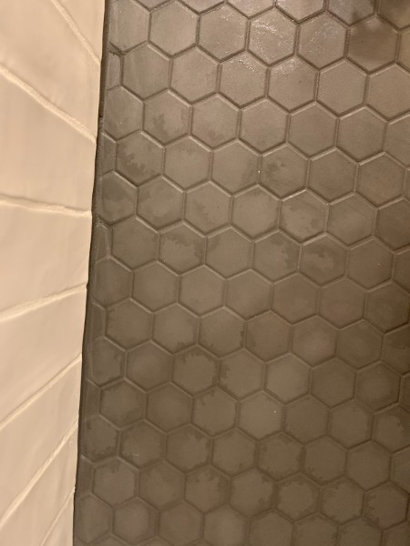

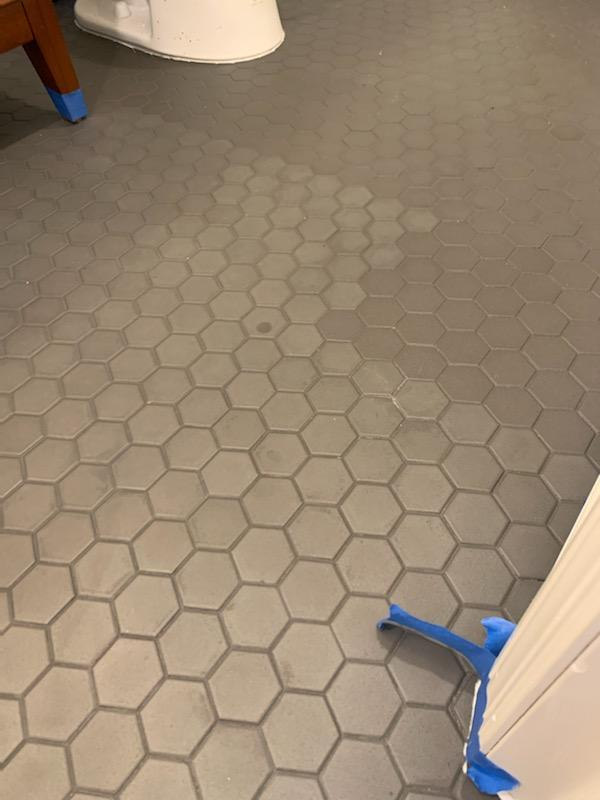

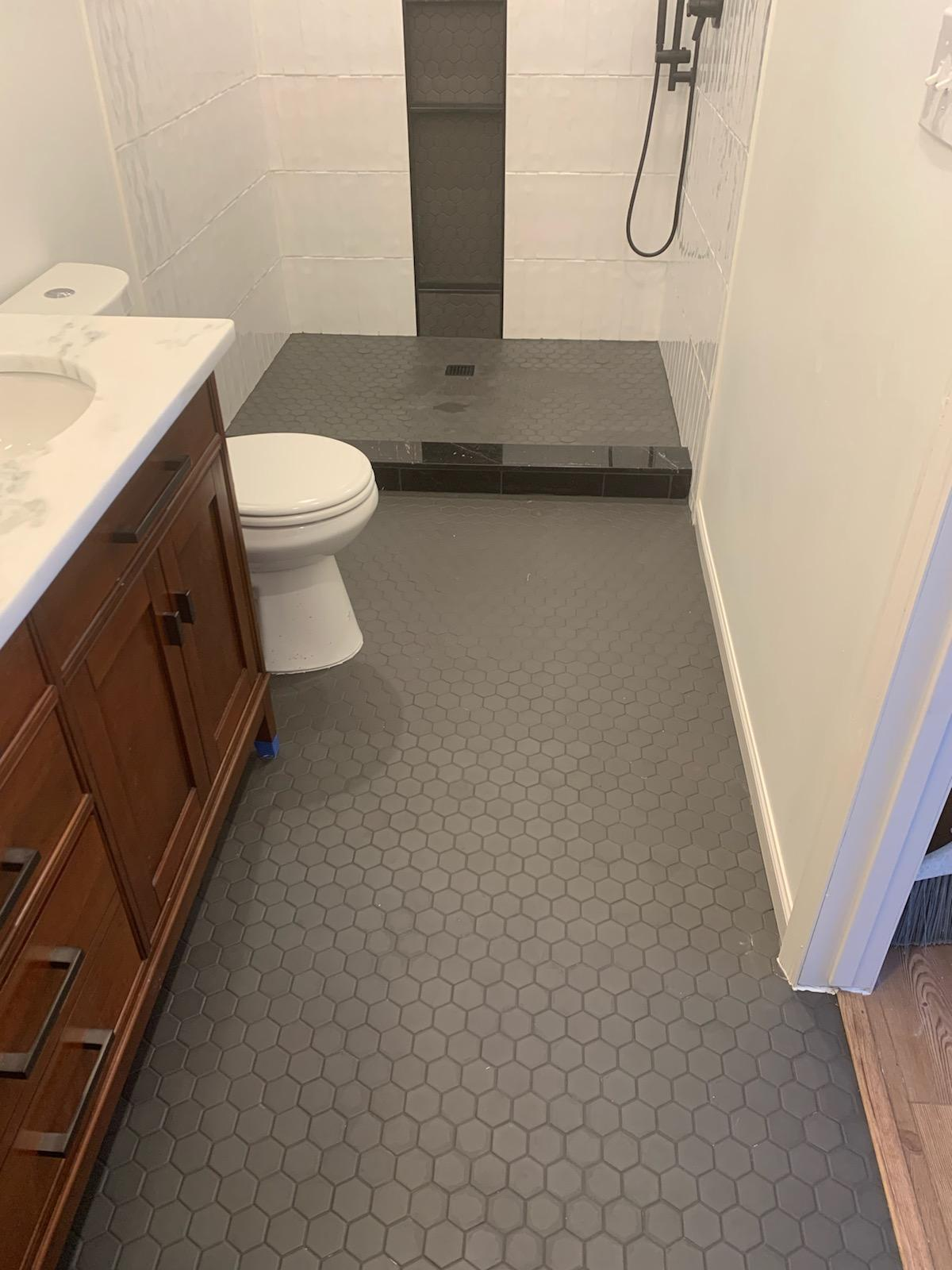

Interior designer picks an unglazed porcelain for a master bath floor and shower stall.
Homeowner decides she does not like the color of the grout so she applies a color seal.
During the removal of the excess color seal, a coating of sorts comes off the "unglazed" porcelain...
In the photo below, the dark irregular rings around each tile were created by just water when it dried. Up top you can see some remains of the coating.
The manufacture, designer and install all have been zero help.
The manufacture told here once you use chemical on their product, you're on your own....
She found me by doing extensive term searches and found our ongoing porcelain thread on Mikey's Board.
My advice was to tear out both floors and start over. Unglazed anything does not belong in a bathroom and color seal certainly does not belong on a master bath shower floor. We had a great conversation and she was thrilled to have my bad news confirming her nightmare.
She says the tile packaging had floors and showers listed as "great for"....
Just one more example of the flooring companies being complete unethical greedy idiots.

is absorbent flooring big in Douglasville bathrooms?
proper porcelain shouldn't be absorbent even without a glass layer (glaze)
unglazed is frequently recommended for "wet" areas....mainly due to slip resistance but also due to the inherent properties of porcelain........like it's limited absorbency/porosity

We all have to work together and find a way of cleaning these floors without hurting these floors.
Just imagine what this floor would look like in two years.
urine stains, efflorescence everywhere, lotion, make up, hair dye.....might as well put carpet back into bathrooms
112,591
If she had never touched the floor and stated to live on it, all the acidic shower products out there would have lead to the same disaster.

and you sure that isn't epoxy grout haze/residue?
or a sealer they applied?
*I'd expect it to end darker.........and not be so even...but
112,591
yep, this lady is a pharm rep and on her game.
Water stains it now that the glaze on her unglazed porcelain got removed by an acid.
let that sink in.
let that sink in.
I'm having a hard time seeing the relevance of her being a pharm rep....
an acid like epoxy grout haze remover?
Does water stain it? Or does it just become trapped under whatever is left there?
112,591
She used Grout Haze remover, not Epoxy Grout Haze remover.

well....I'm no expert......but before I ripped up that floor I'd do a proper haze/coating strip

so it'll be even more absorbent?
and F up her colorseal.
Surely it wouldn't F it up any more than tearing the tile out.
I also doubt it would be more absorbent.........I think there is more going on there.

Fred she's going to tear this out and put in a glazed ceramic.
There's doesn't seem to be anything on any shelves these days with the word "porcelain" on it that's worth the cardboard box it's packaged in.
