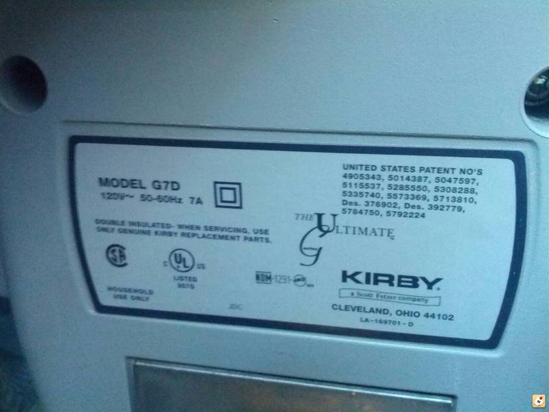

Inspired by this thread I picked up a Kirby G7 for the whopping price of $0 this morning.
There is no belt on it so I'll need to get one before I can test it out.
Where is the best place to get parts for these things?

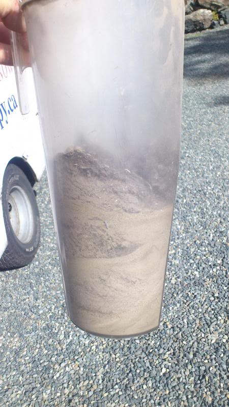

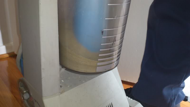

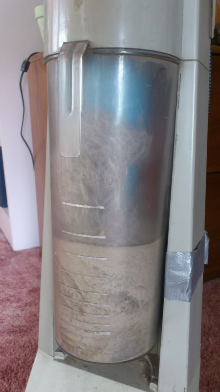

Commenting on the nature of our disagreement and my position on the issue, I am interested to know how "much" soil is extracted with the Cleartrak in terms of measured weight.
I am impressed by the appearance of filling clear canisters but this in and of itself doesn't tell me much. Ron has spoken to me about the Cleartrak being a modified machine which I have no difficulty accepting, but even taking this is so there; to my mind remain significant issues with it. I have had some first hand experience with the machine it is based on this being the Amway CMS 2000. The CMS 1000 and 2000 are (originally) Bissell manufactured and Dyson designed machines. They employ a Dual Cyclone cyclonic separator and a panel type micro level foam and paper element filter. These filters are of quite limited area, much smaller than the area of just about any bagged vacuum cleaner, and certainly smaller than our traditional upright machine designs.
As with Dyson vacuums the cone piece of the dual cyclone particle separator sits in the centre of the dust collector bin. What this means is that as the bin fills with soil, the area for heavier particles that do not make it into the inner cyclone separator accumulate on the outside of the cone. This area is obviously quite a bit smaller than the volume of the dust collector would be were there no cone present. In this way the unit has a tendency to visually misrepresent the actual quantity of soil recovered; as it will accumulate on the outside of the collection vessel, gradually obstructing the user's view of the plastic cone that occupies the largest part of the collector's real volume in the centre.
another issue I have pertains to the nature of cyclonic separation itself. As the dust particles fly into the canister that are entrained in the constant movement of air that is the cyclone's vortex. This causes large volumes of air to become trapped in amongst the collected debris and further exacerbates the illusion of greater recovery quantity by making the soil itself occupy more space than it otherwise would. It's like shaking a quilt or pillow.
When these factor's effects are jointly considered, it is evident that the machine will be far more visually impressive that is really the case. in terms of customer engagement and confidence this is a boon, but from the perspective of allowing the operator to really interpret visually "how much" soil has been recovered it is quite deceptive.
By contrast upright cleaners with bags vent debris into a bag under positive pressure. Owing to the combined forces of gravity and positive air pressure the soil will fall to the bottom of the bag and as more soil enters it will be compacted under its' own increasing weight and the incoming air. This is actually the reverse of the cyclone system. The bag has no internal mechanisms with which soil has to compete for storage volume, and the forces at play will tend to compress the soil and minimise its' visual impact weather looking at the bag's final fill size or even cutting it open to inspect the contents. This is to say nothing of the hidden fine dust which becomes trapped in the bag's walls.
On this basis I think the visual interpretation of performance is at best unhelpful and at worst divisive.

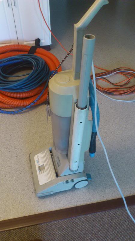

I have a Cleartrak as well and it sits in my laundry room. It's a nice vacuum but Imo the tools suck and I have to constantly clean out the filters as well as the canister.
I used to swear by bagless vacuums (I've had them all), but have now been crossed over to a bagged guy. Love the filtering, power, and ease of maintenence on my bagged vacuums. I don't think I can go back...

Cleartrak looks great but i need a vac with good edging capabilities. especially for stairs. bringing 2 vacuums into a home/building doesn't appeal to me. :errf:

Some truth to what Grant is talking about. The centre cyclone chamber does take up room in the canister, but I end up dumping it more often and I simply change the filters (washable many times-great $ saver) I just fill up a small garbage bag.
Depending on what the outdoor environment is you will find different soils. If you live near a beach, more sand, having landscaping done-more soil (one client had a olefin berber carpet and was landscaping a clay yard. Long haired sheep dogs brought half the yard into the carpet :icon_rolleyes: ) in a high rise- more dust and lint. I've pulled over 10lbs of soil from some carpets. Others are canisters of hair and dust which have no weight at all but it needs to be removed or it'll just stick there. One condo had hardly any soil at all, except for 1 sq yard where I put over an inch of drywall dust in the canister. If I couldn't see it, never would have known it was there. I can hear when my filter is getting plugged, but I can't hear when the soil is coming in. If its making a noise coming in the canister, its not the soil I'm really after.
The deception with bags is that you can fill them to the top and still have great airflow. Yes, all that soil gets pulled and compressed into the bottom of the bag. But where is all the fine dust being filtered. As that heavier soil and hair etc gets compressed into the bottom of the bag, the air has to get through some where, so it goes out the TOP of the bag. By the time the bag is half full, the pores in the top half have been plugged with all the submicron particles that have no where else to go. Keep a lot of bags on hand for those jobs where lots of pet hair, or lots of dust beside the beds.

Cleartrak has all the edging tools and an extension hose for doing the stairs.
