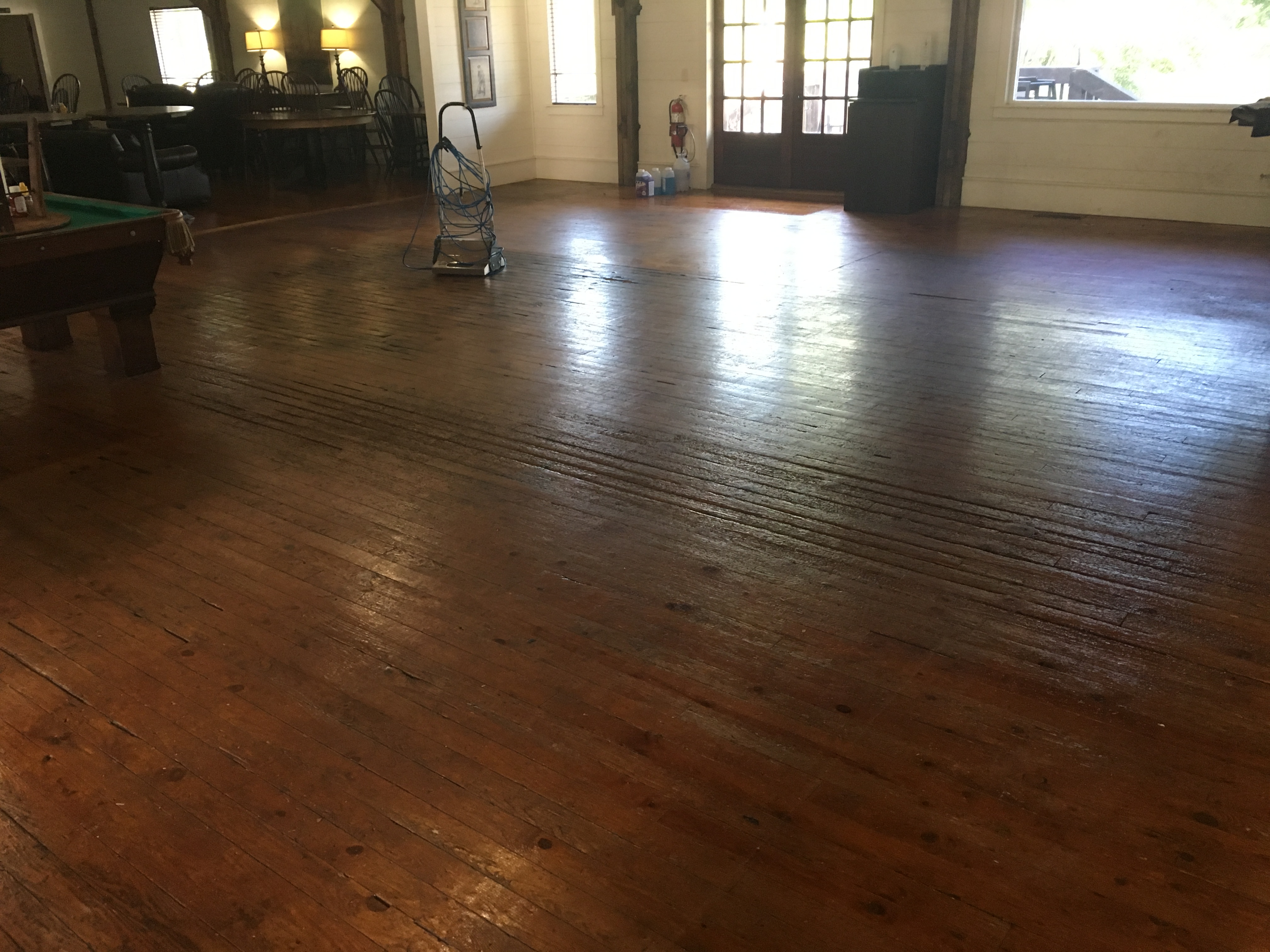

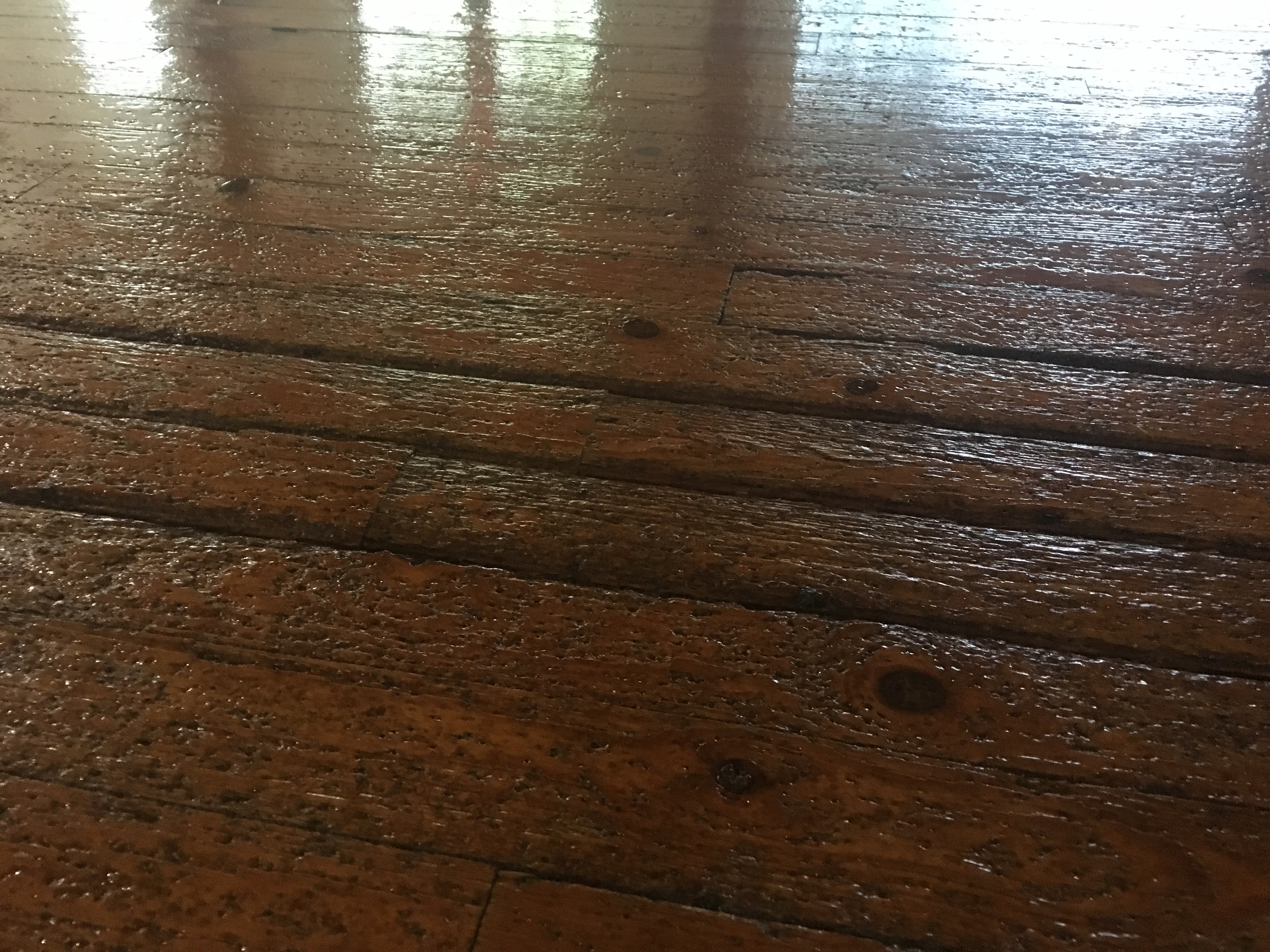

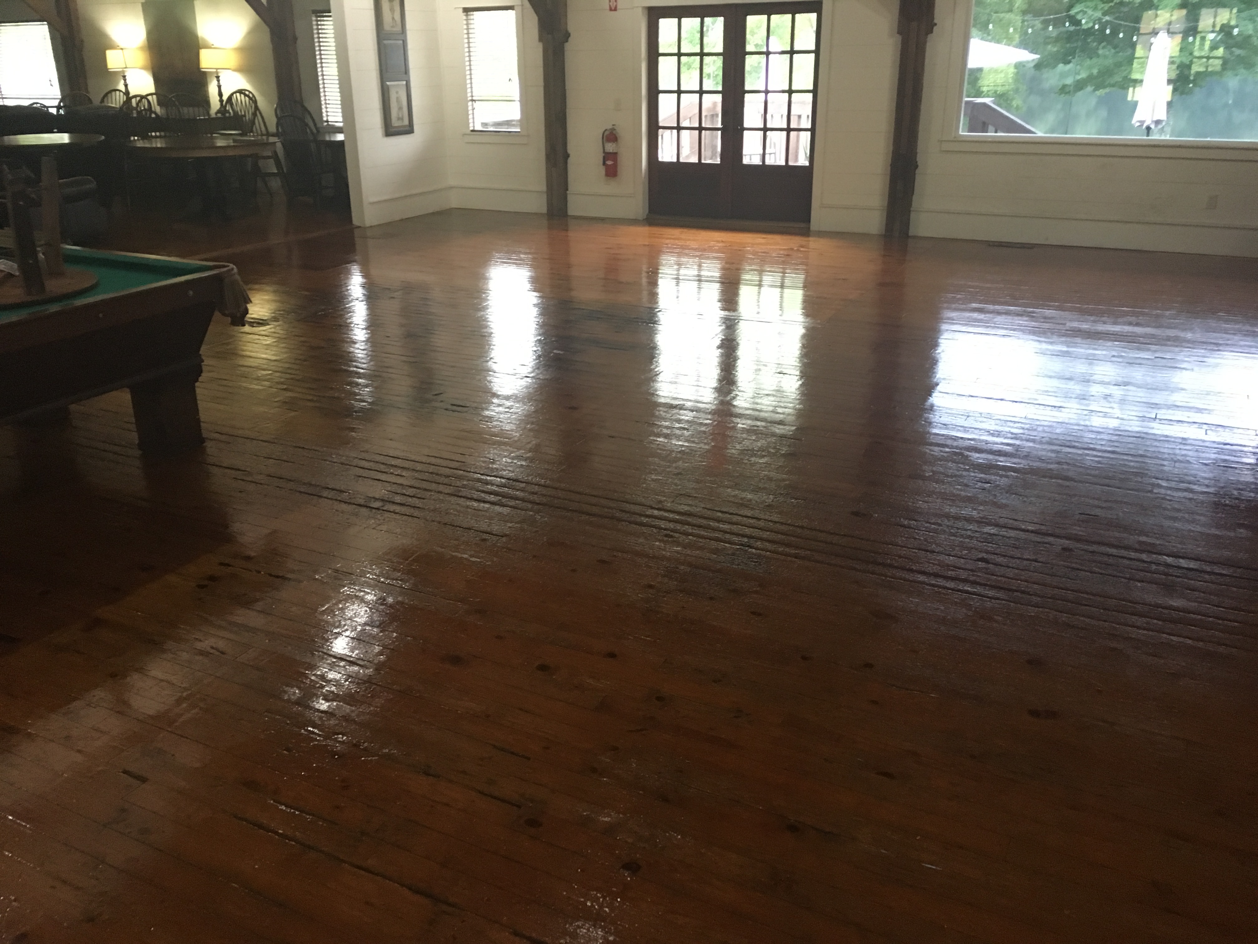

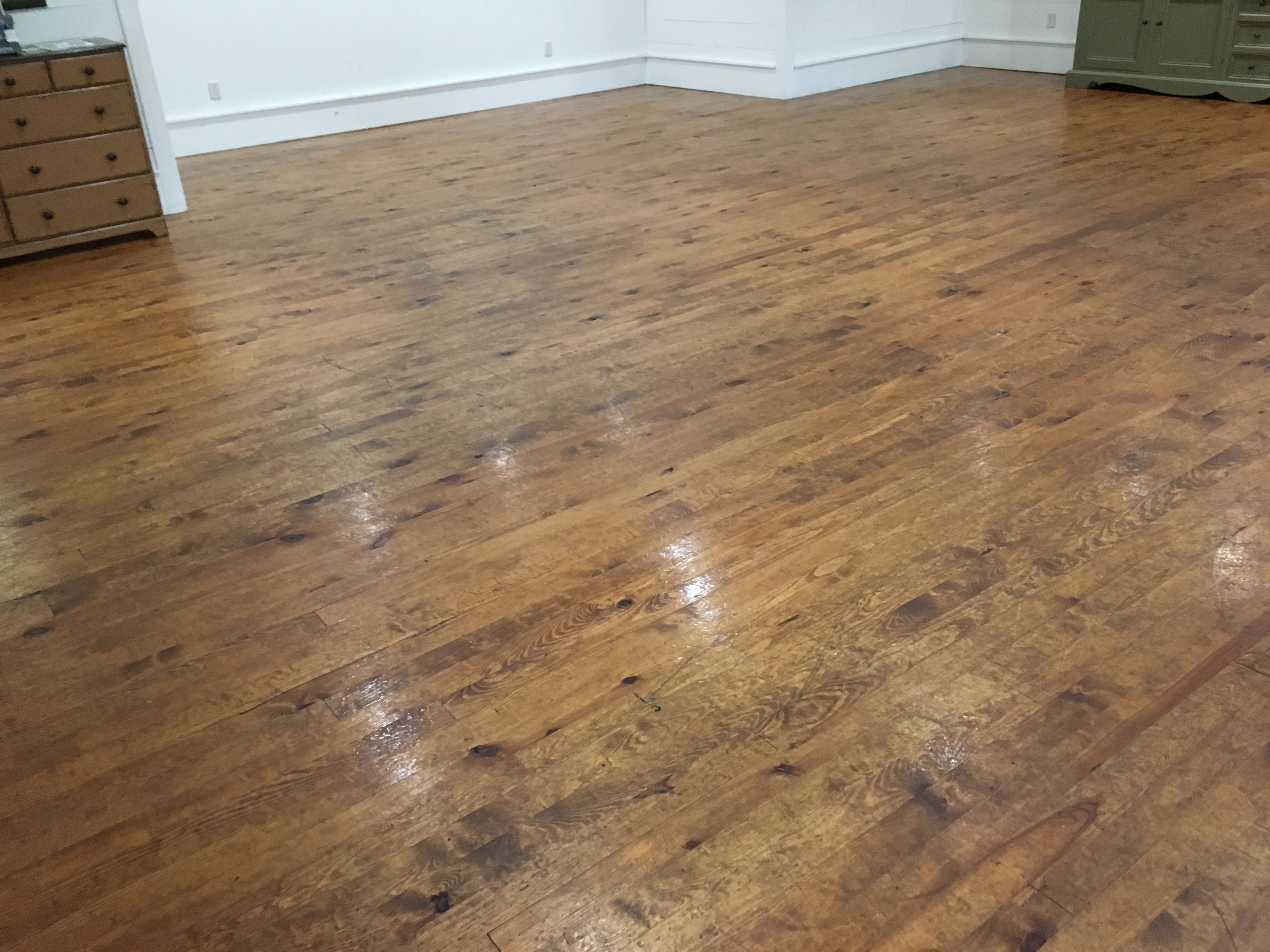

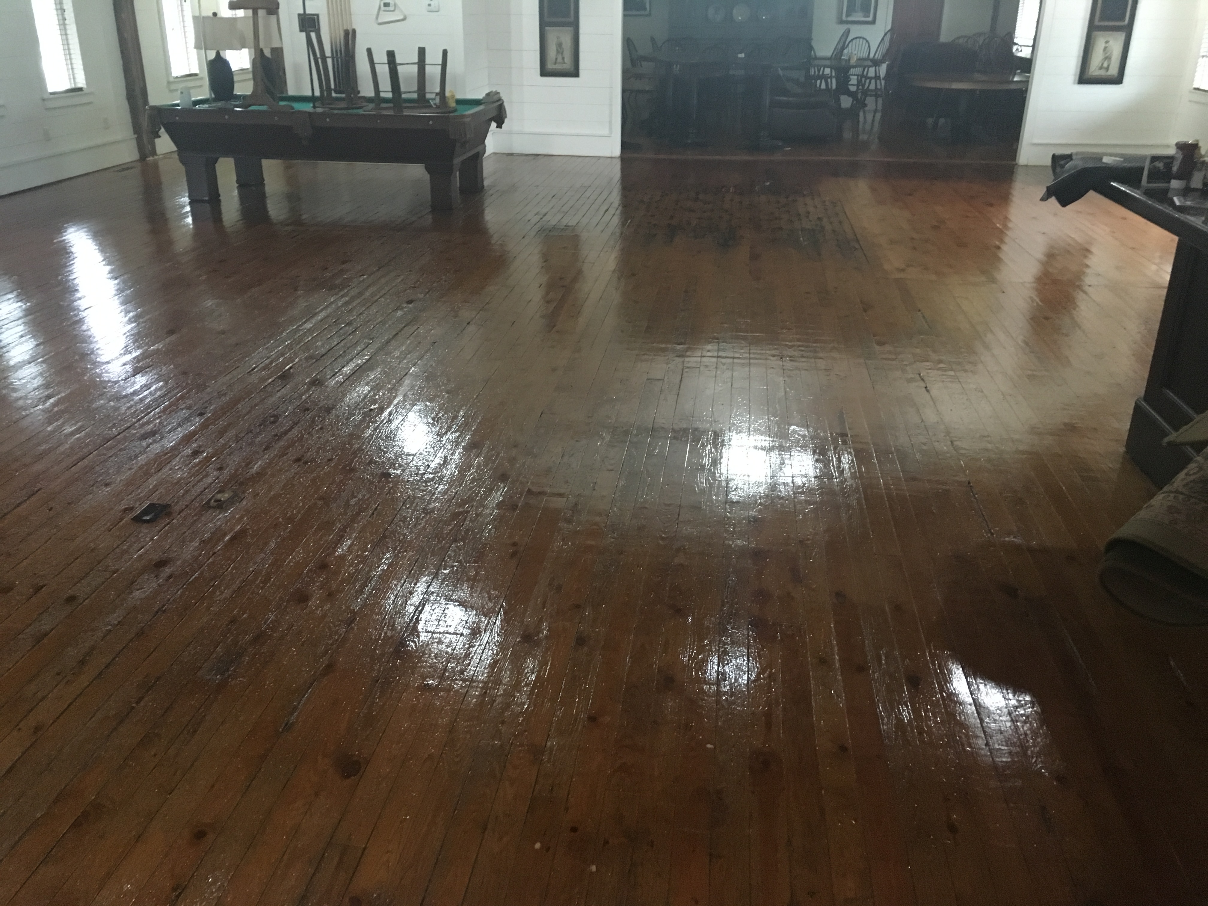

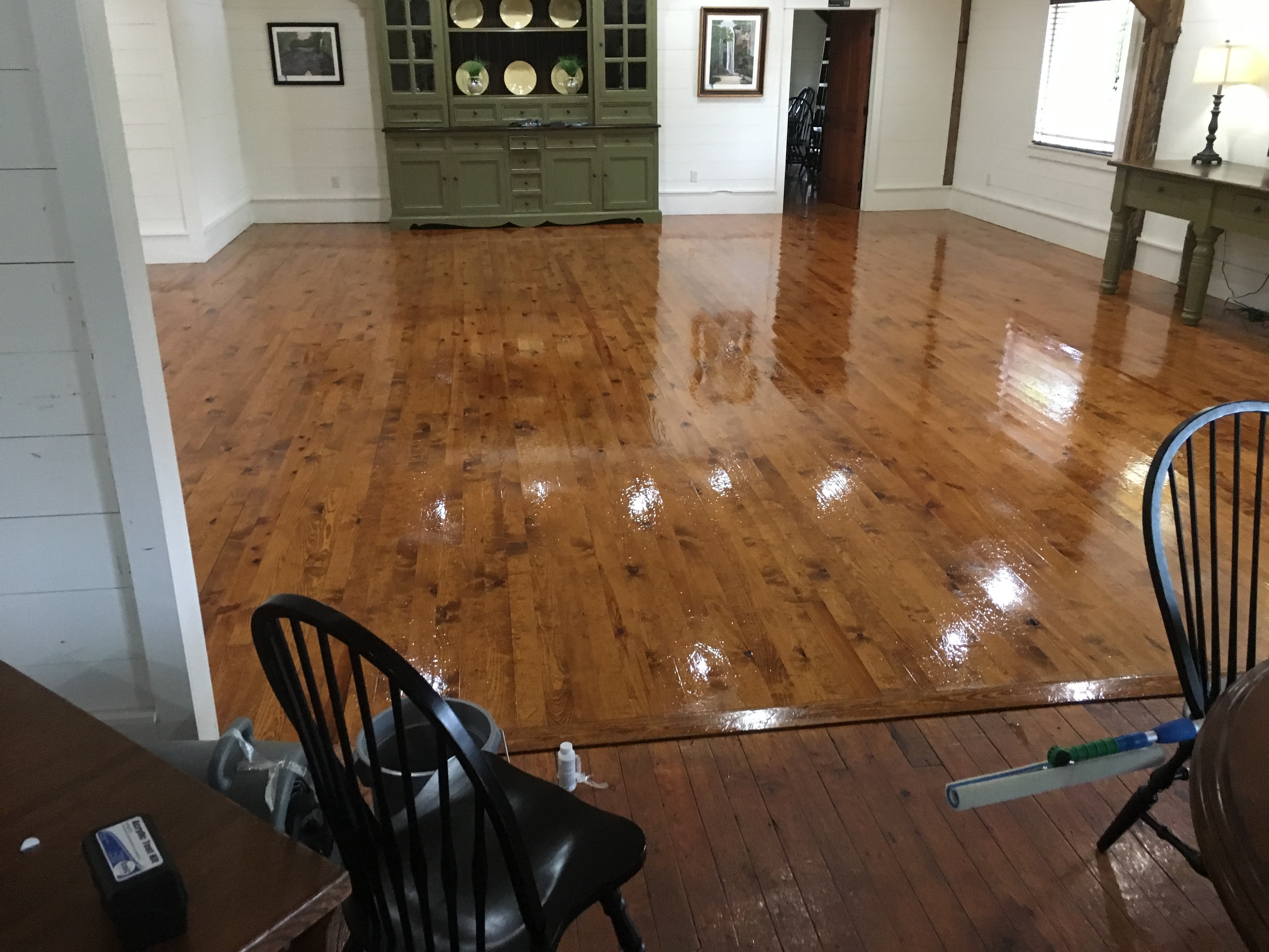

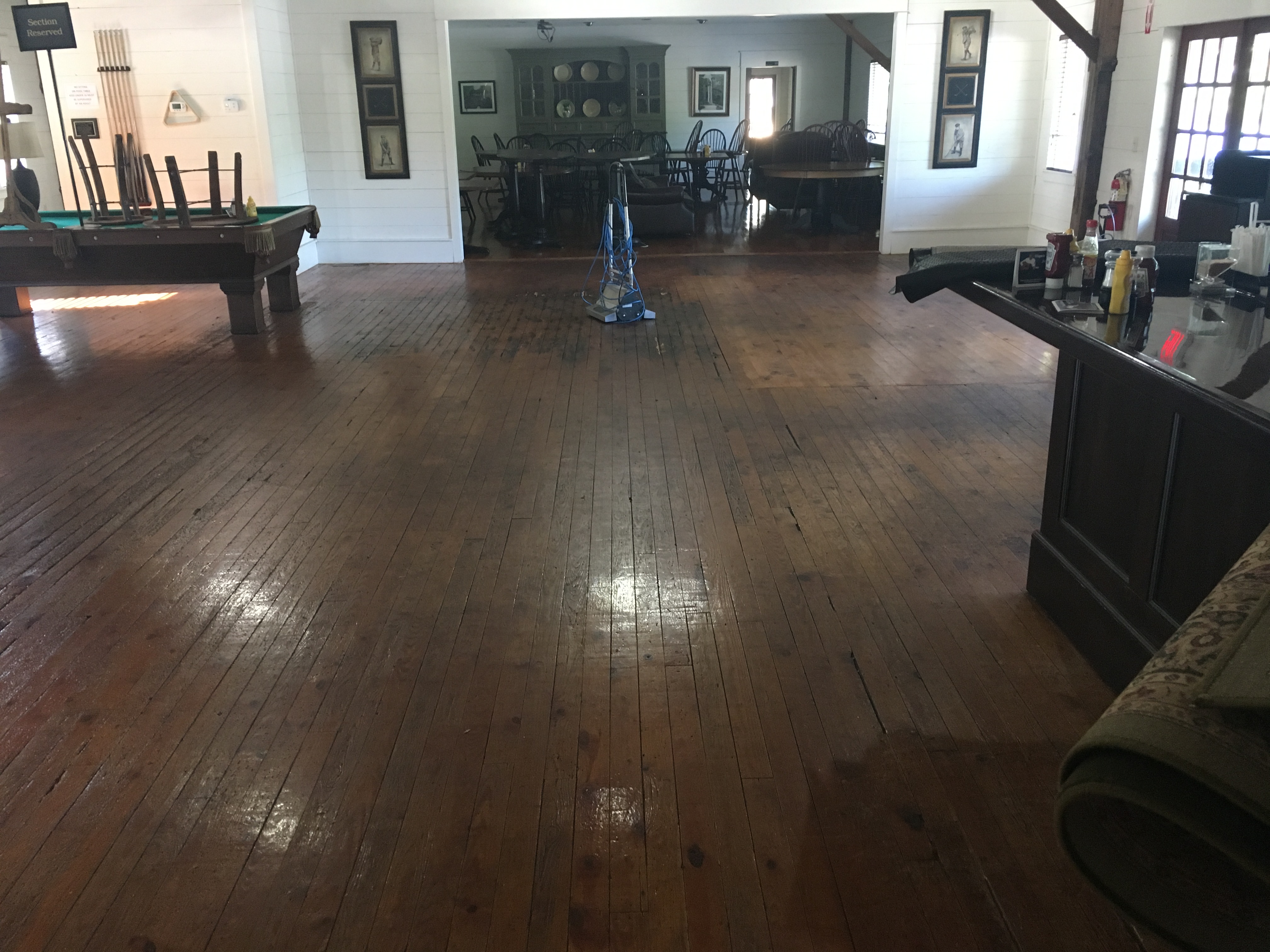

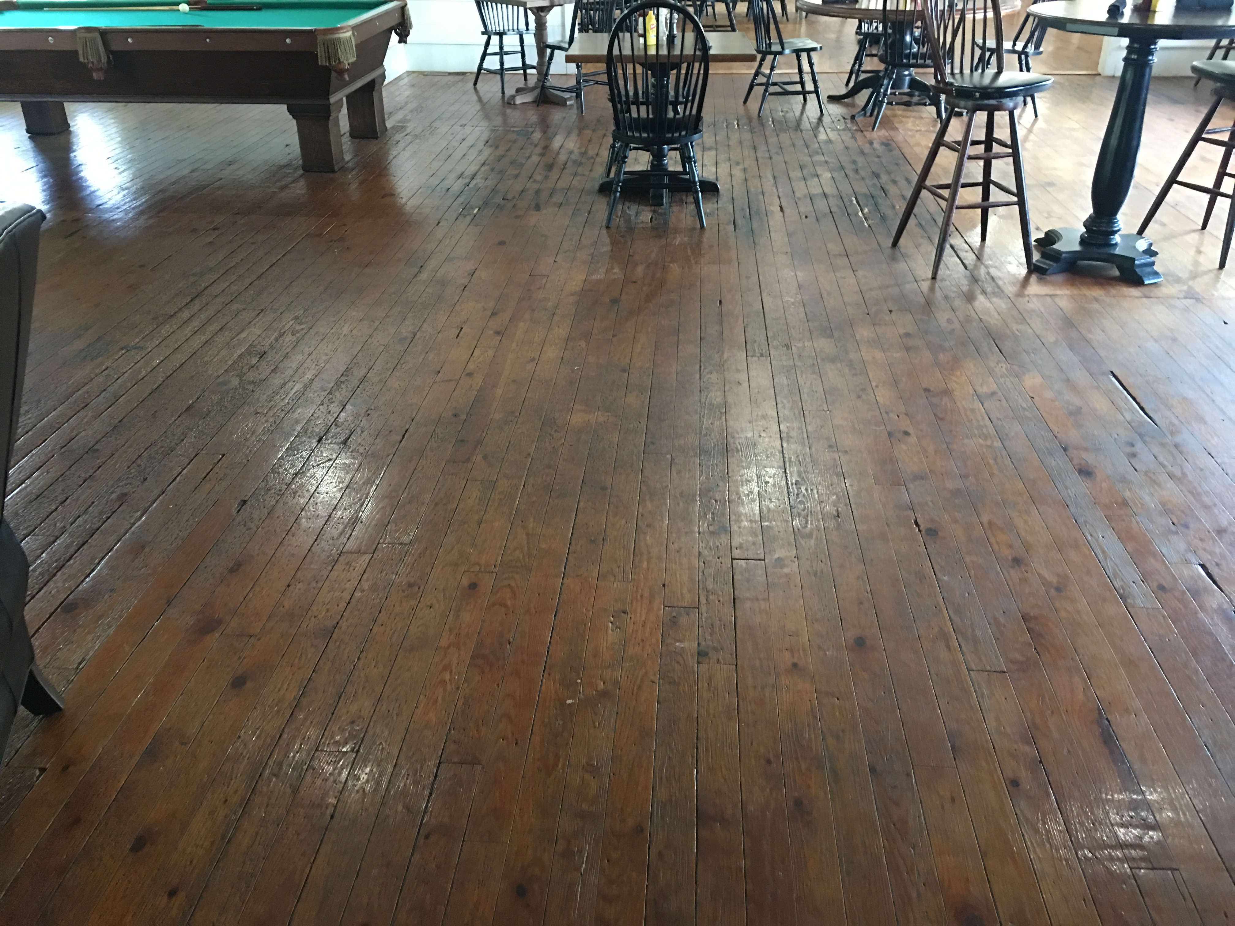

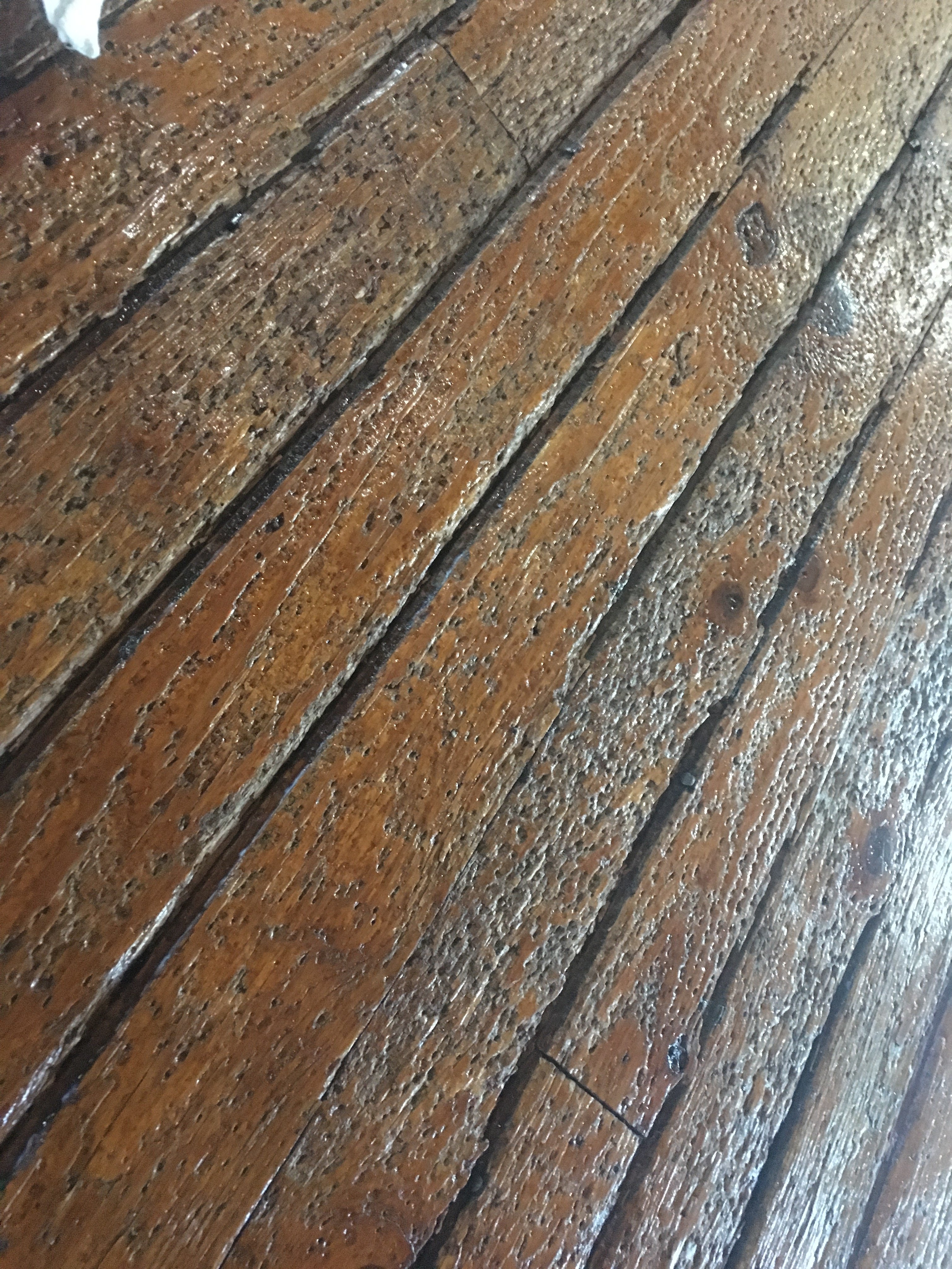

I had to work to preserve this damaged floor from golfers metal cleats in the 50s that they wanted to stay that way. The first 3 are before. I had to dry crb it to get the sand out fromnin the big gaps
And I was also told from one of Basic Coating’s chemists that you Can use Streetshoe in place of minwax polyurethane on bare wood if the need arises to avoid the dangerous VOC and has a much quicker cure time. You’d just need to do 4 instead of 2 coats
So that’s my feedback on the process of preserving hardwood floors.

Keep in mind, all those after pictures are 24hrs later after it's dried. Just to answer the question if that was a wet picture. Nope.

Matt on that heavily worn floor a T Bar applicator would have filled up all those voids creating a big mess. Some times less is more.
I agree. And I saw it fill in those gaps. I went behind those areas with a dry rag to absorb the puddles.
Heart of Dixie
You could lay it down with an HVLP sprayer and shields. On a rough surface like that one, it would control for puddling.
