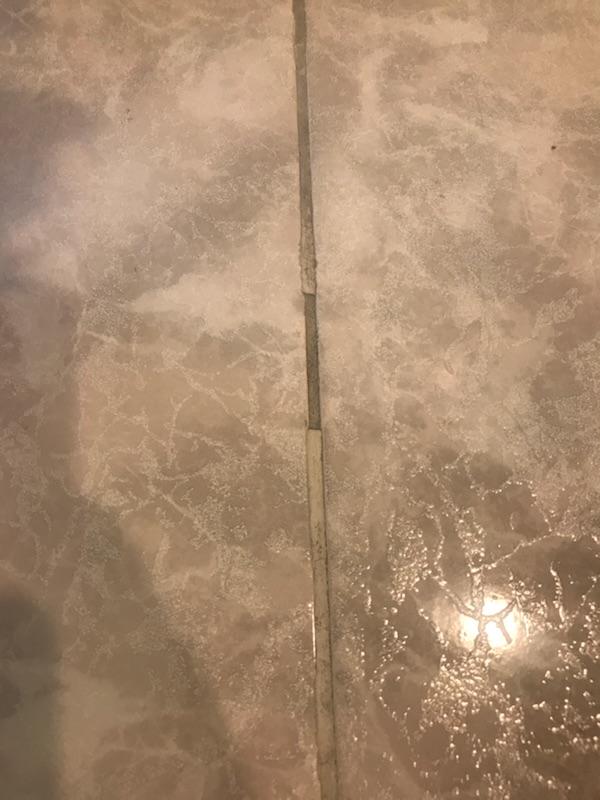

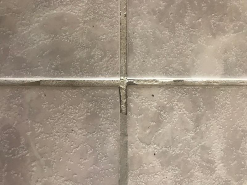

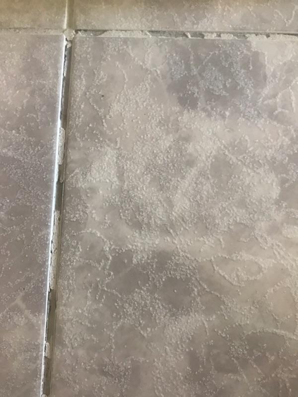

I know this is an old thread but unfortunately is an ongoing issue for me. Last year (2017) we completed a little over 5100 tile jobs. We get theses calls probably 5-8 times a year. We clean tike usually around 1250 PSI with a spinner. With this issue arising only once every 700ish jobs, it is clearly a faulty instillation. Unfortunately most customers accusing us of ruining their homes are unwilling to hear this. Usually I’ll ask them to get a repair quote and play it by ear (just pay to fix it as long as it’s reasonably priced).

Well this most recent “grout gouging” fiasco has come to a conclusion. Come to find out a few months before hiring us to clean the tile & grout the customer had a competitor apply s “skim coat” of grout over the existing grout. Quite literally did not attempt to remove any grout prior to regrouting. Simply filled the recessed grout line with new grout probably 1/32” thick making it completely flush with the tile. Then is pissed at me when it blows out. He littered said he is “selling the house” and wants me to “re skim coat it so he can sell the house”. He “doesn’t care how long it lasts”. Just wants to be able to sell it. I told him I refuse to redo an already improper installation and pass the buck to the next homeowner. Now he is “taking me to small claims court”, and telling everyone how we ruined his home and don’t stand behind our work. SMH

Unfortunately the 3rd or 4th I’ve run into in the past year. While inspecting it can be tough to spot since you’re really just looking at grout. Not like checking for a film former where you can do an acid test or something. This seems to be a bandaid fix for people selling or flipping houses. Not really sure what the answer is. They’re so delicate the slightest amount of agitation or psi can start chipping them. Maybe a scratch test on the grout before cleaning?
