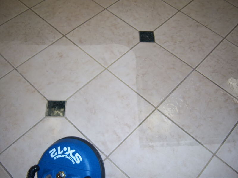

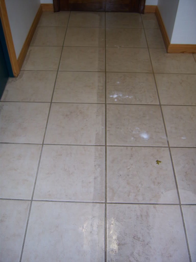

Here are some pics of my first tile job, how does it look?

Did you scrub the grout with a brush after 10 minutes of dwell?
Damaged, cracked or missing grout is likely, especially after cleaning, you need to inform the customer before hand & should offer grout repair services charged by the hour.
Once you get comfortable with cleaning you should educate yourself on sealing, I use a solvent based sealer from This Old grout, color sealing would be the next level.

you need to let tha baby dwell a little longer, just remember to keep wet. You nee to learn the tubro tilt or get a cobra hand tool and do aginst the walls first,I hate that last 1/2 in aginst the walls
Looks good
M
Mr. P
In your list, you didn't say you had a grout brush. I feel you really need to scrub the grout lines good. Also, I've used viper venom and i use a defoamer because it did foam up for me. Dwell time is important. If you want to learn more go to Dirty grout .com there is a wealth of info there. This old grout and grout perfect has some great products.

Looks like your grout lines are in need. Tile surface looks great but that's the easy part. If you scrubbed with a brush and allowed plenty of dwell time...10 min like stated above. Then you need to etch that grout. And if that don't do it then and if the custy wants perfect grout color seal is the solution.

The floor was left to dwell 20 min, grout lines were scrubbed with a grout brush, the sealer (looks 2 me like floor wax) was just a nightmare to get off, i actually did the floor twice once like in the pics then again after that. i use a dootle bug on the edges, and then scrub the grout along the edges by hand, i used a gekko on the grout lines after i used the sx-12. then i used the gekko edging/coving tool to do the eges. worked pretty good, the floor was just a big pita. i used floor stripper for the sealer and viper for the 2nd cleaning. it seemed to work pretty well. i will take some pics tomarrow of it dry. i have some grout lines yet that just look like crap, im going to use viper renew on then and do them by hand. i cannot use viper renew on the floor beacuse there is small square marble inlays in the foyer area as seen in the first pic. thanks for all the help guys.
