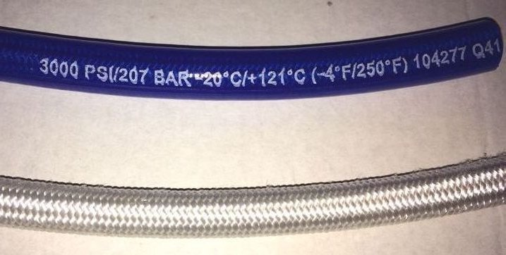

Larry Cobb
5,795
Dallas, Texas USA
Larry Cobb
This Blue hose has ~3 times the insulating ability of the wire-braid hose due to the woven reinforcement.
This minimizes heat loss in the winter and heat damage in the summer.
