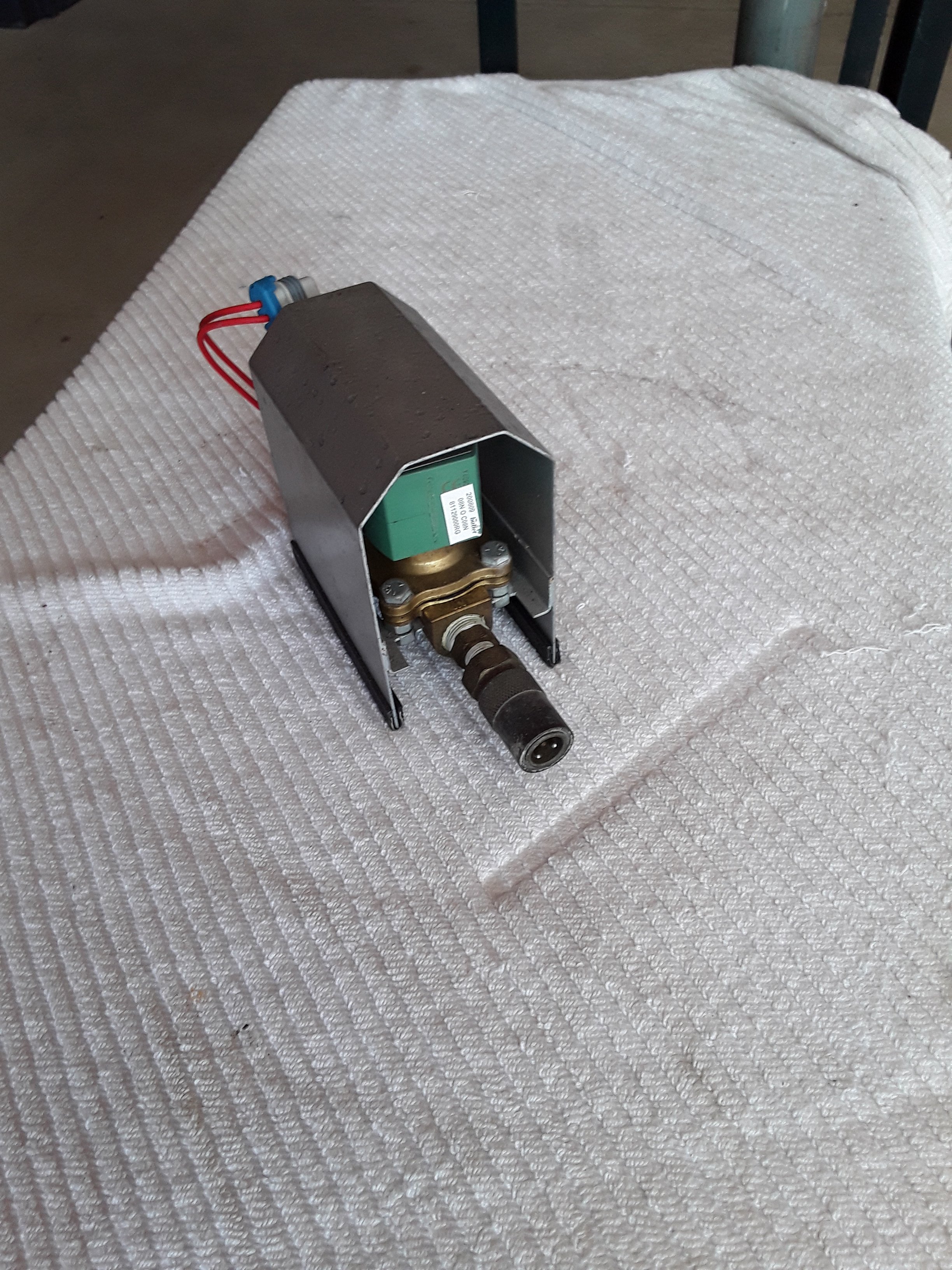

Butler uses an electric setup. Float switch in the tank, solenoid valve control of the water. It works very well, a bit more complicated to set up than mechanical valve.
