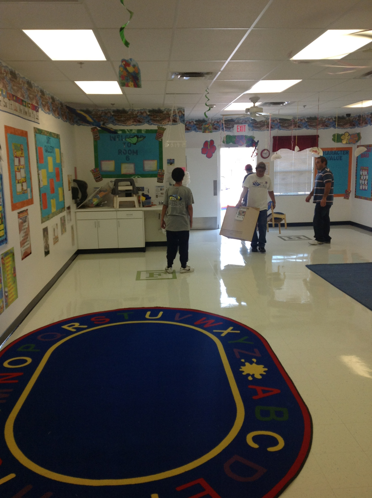

17 years between cleanings. Neutral cleaner in water and rotary scrub with a maroon prep pad. Edges cleaned with maroon doodle pad. Buffed to close it up then 3 coats of Pioneer Equinox floor finish. Buff with thermal pad on a propane when dry
