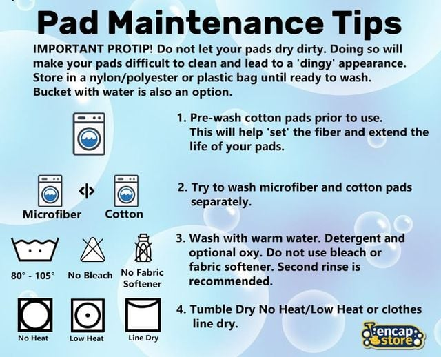

I’m planning on using 20-25 pads Saturday....
13,580 sqft. Phoenix, tops spot, a little 40V...
I’m going to the laundry mat.....
For all you guys that use laundromats to clean your pads...
Don't go to some new state of the art laundromat where all available equipment is new energy efficient equipment that uses like 10 gallons of water per cycle. A lot are programmed for only 1 wash and 1 rinse.
Find a slightly older laundromat that still has older equipment that offers a prewash, wash and 3 rinses.
These machines depending on size use 80-120 gallons of water for a complete wash cycle.
We’ve got one in town that has 4- 6X size loads... made to clean quilts, and other large items.... it works awesome...
