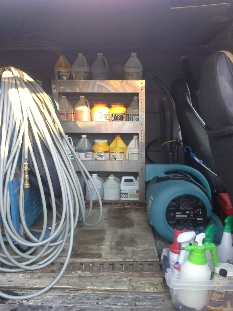

I don't mean or want to pick on you Steve but what do you have on board your work truck?
13,372
I carry a vacuum and my bane.
I have one wand a stair tool and an upholstery tool.
I have many other tools but I dont keep them onboard since they rarely get used.
I scrub with my wand for now.lol
Yes some tools make the job easier but I can still accomplish the task at hand.
Sometimes a white towel is my best tool.

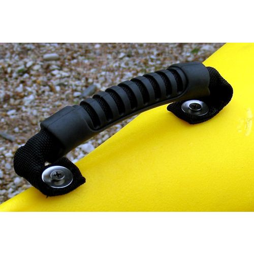

How about attaching a rope/kayak handle between the two magnets?
