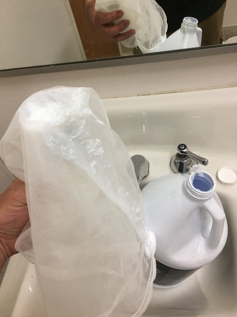

I still have 2 gallons of this Hos encap stuff. I guess I'll just strain it through a paint strainer. That should solve my issues.

I pulled out the mesh filter and cleaned it this morning. Looks like I'll need to filter this encap juice through a paint filter.
Yes. I rinse out my Orbot after every use and shake my chems before mixing. I'll make a video of it pouring out.
That was fun pulling out that filter and putting it back in. My bicep got stuck in the fill hole.

Ok. Not impressed. I ran this Hos Environ through a paint strainer. No good. Clogged up the strainer. Clumpy craziness. This pic is filling a water bottle direct from the jug while straining through a paint strainer

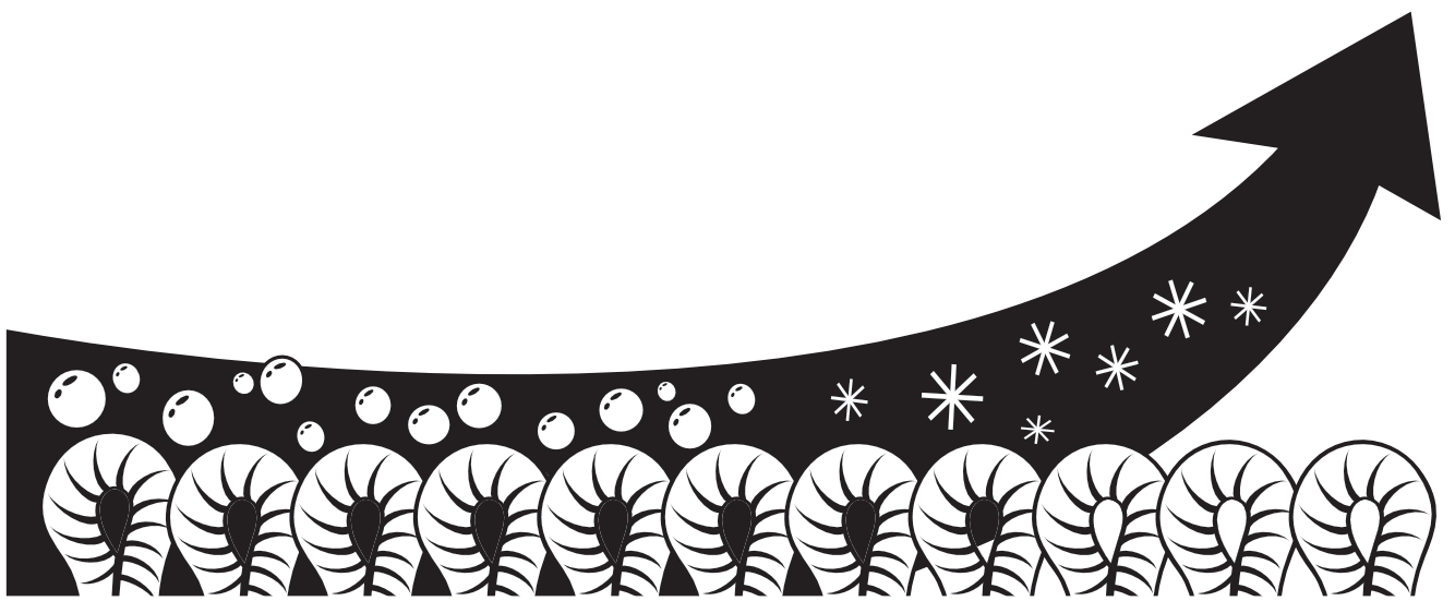

Great post. Whats the difference? How canI tell?
Below is a graphic that may help you visualize it.
  1. A "crystallizing" encap shampoo is introduced to the carpet fiber.
  2. The solution emulsifies the soil.
  3. The soil is now contained in the liquid.
  4. The solution dries.
  5. The dried polymer breaks away from the fiber because it's brittle (and it's attached to flexible fiber).
  6. The normal routine of post-vacuuming works to extract the encapsulated soil from the carpet.
