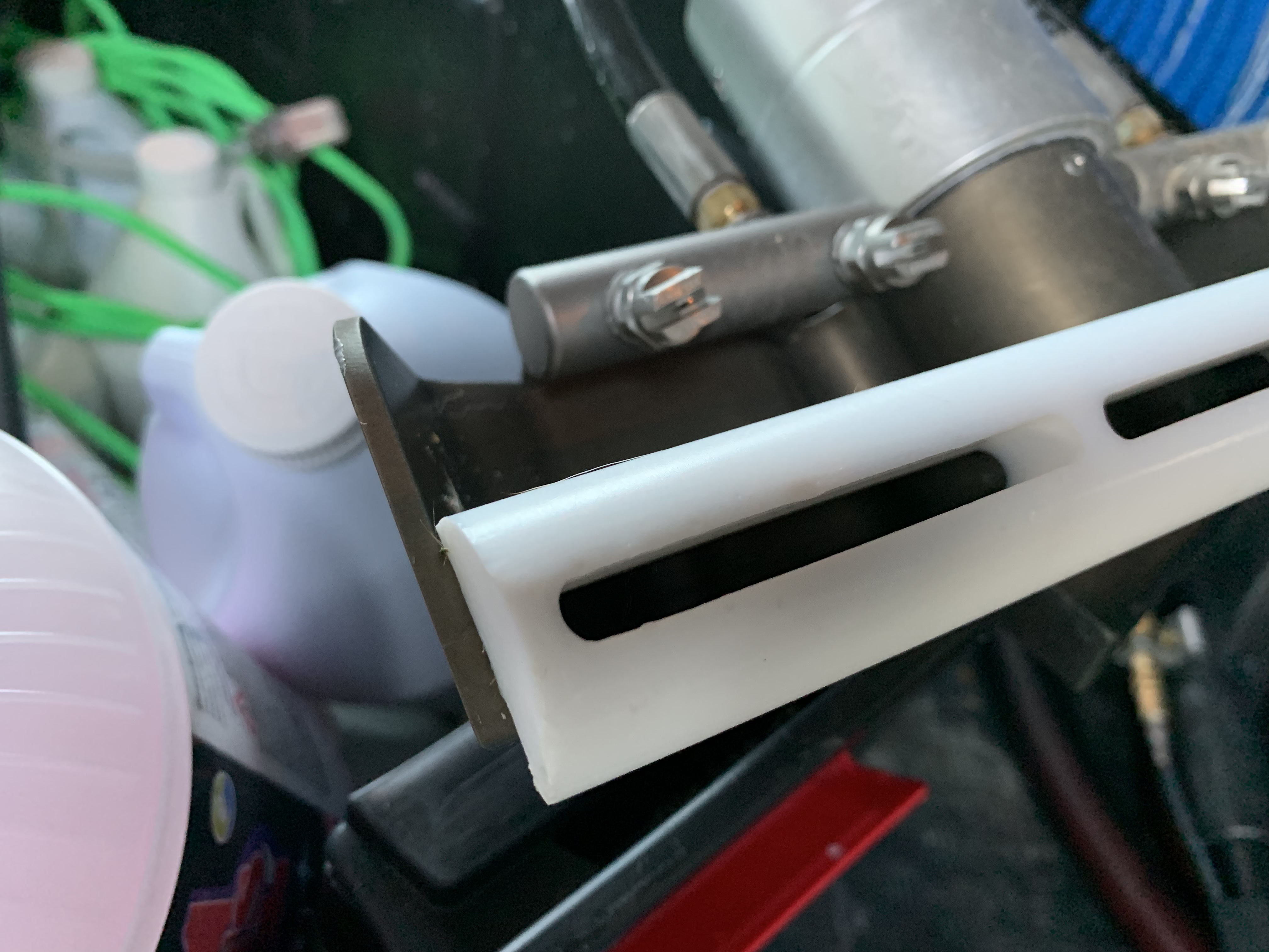

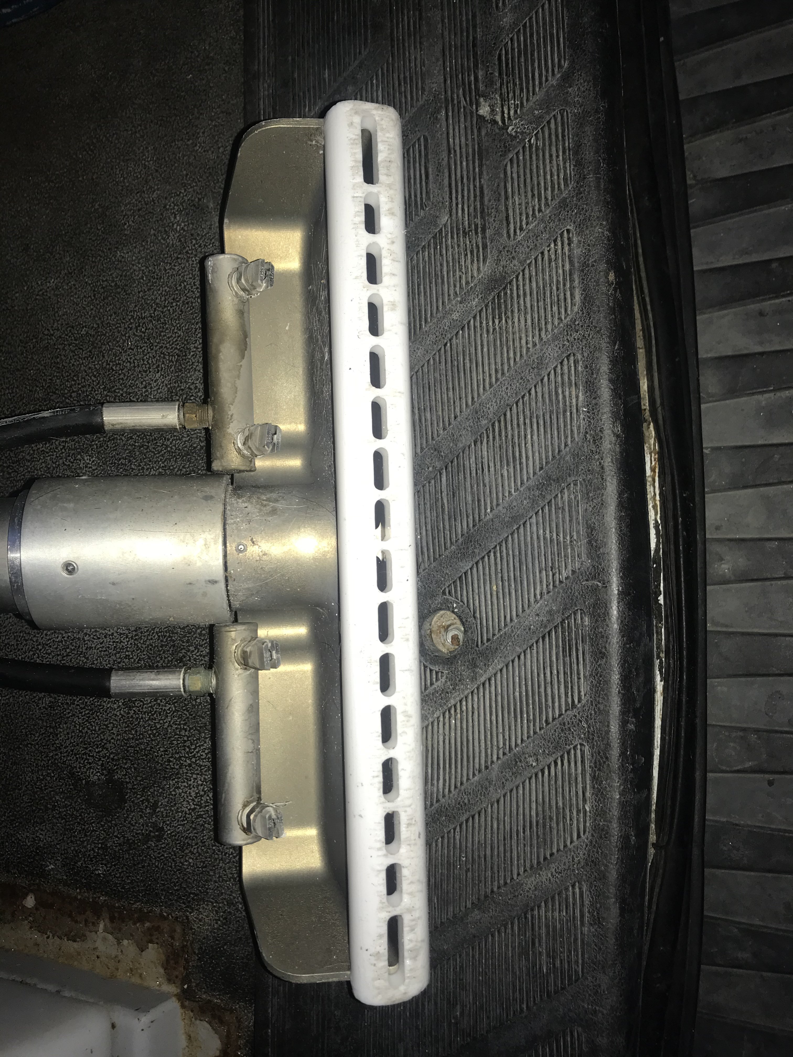

Makes sense. When the Devastator is locked down, all goes silent. Definitely no airflow. At least not on longer yarned carpet.

Greenie told me, many years ago, not to seal the ends of glides because they need a leak there.
How does an intentional leak anywhere upstream of the glide help?
Reactions: Trip Moses
116,356

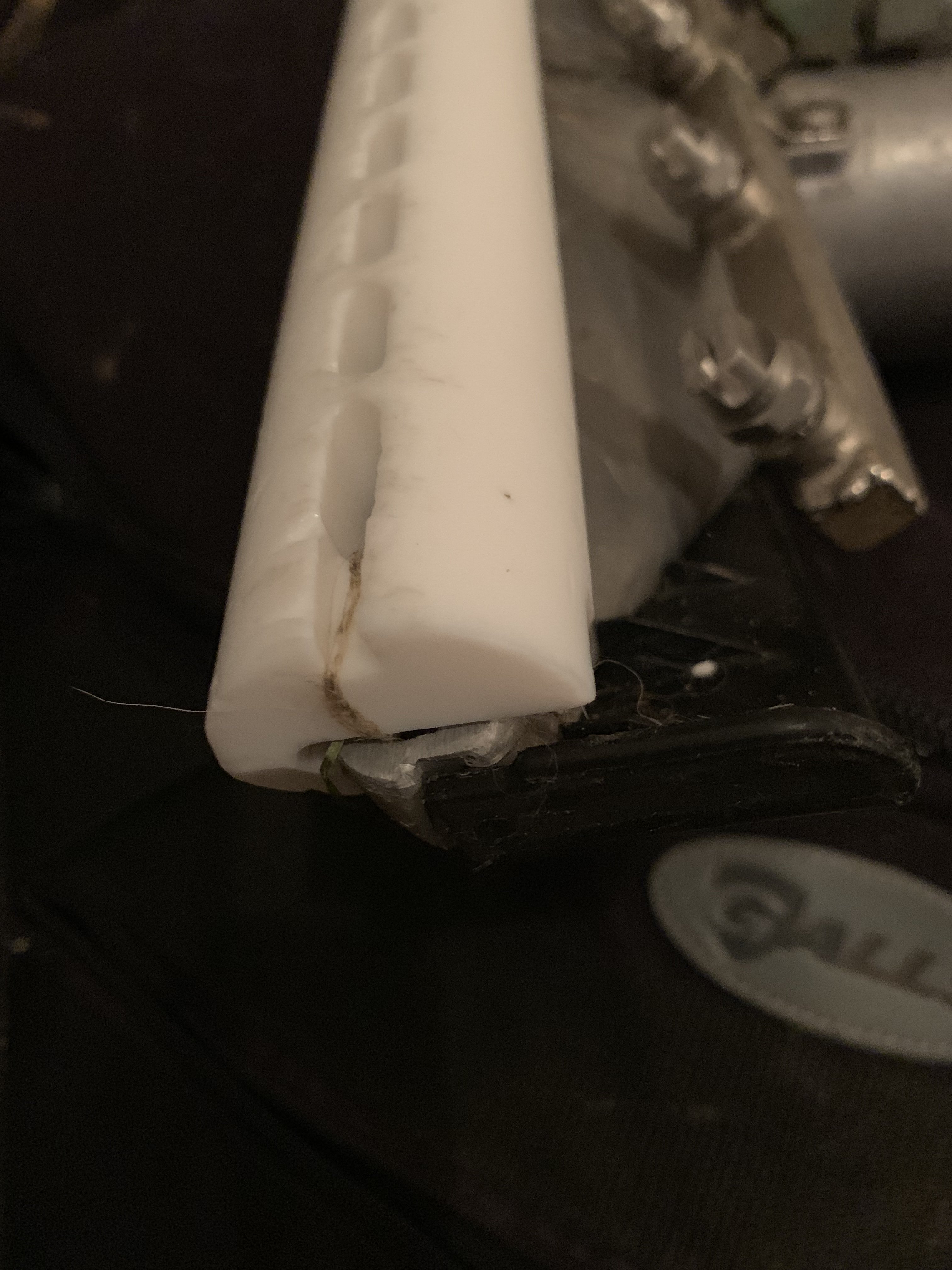

Take a Dremel or box knife and cut a channel on both ends
And try that 8 ft whip hose, that wand has too much suck to go 2" all the way
Or get a bitty mount instead of a big mOunt that has too much performance for such a remarkable wAnd....
Or just choke down your TM to Bane specs......

I tried the whip. Still locks. I’ll carve out some channels - I bet that’ll do it. The wand probably needs to breath.
