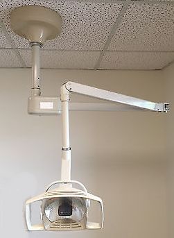

My new one will. Larry, what would be the look and design of your dream room?
It would have hi-power UV lights like a dentist uses, mounted on a movable track.
When necessary, you could push the light up or pull it down to examine the rug closer.

Fancy! More for show? Hand held likely will continue to be fine for me.

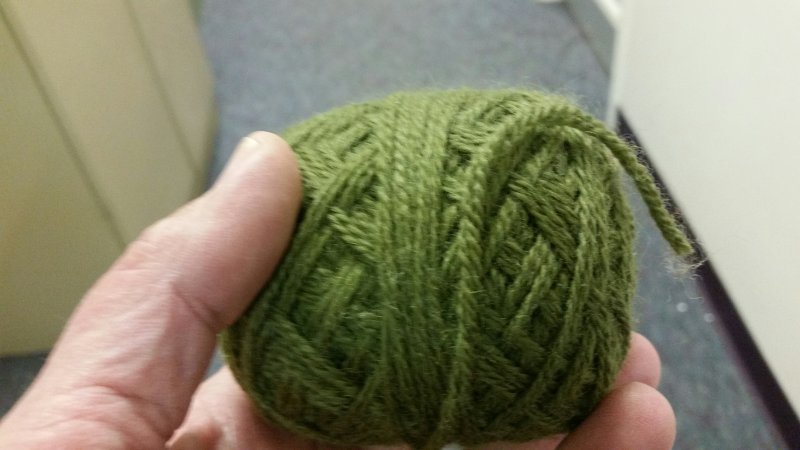

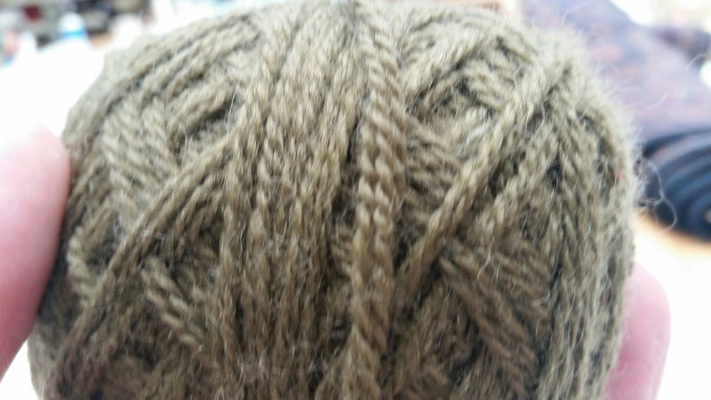

Here's an example of lighting...
Same spool of yarn, same camera (actually my phone) and same settings on the phone. The first picture was taken in our repair room, the 2nd in our office. The funny thing is the camera changed the color too. In the repair area the first picture was brown. In the office it was closer to the 1st picture in color.

What would happen if you used the flash on a low setting? What should happen is the color should be more correct and the image should have better focus. Not sure what camera you are using though...so yes it's lighting. HDR setting to auto and your camera/phone and colors should also get better.

I took the pictures without a flash. I wanted to show the effect that lighting has on perceived color and to add to the conversation about dry room lighting.
Sorry I thought you were showing the difference that a camera sees... the human eye/brain would not be fooled so badly. Old movie studios were essentially walls with removable ceilings for natural light. Lighting is all about LED's now. New lED Lighting mimics the sun.

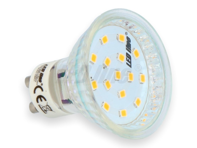

We went to T8s as well Brian; under the local power company guidance. They retrofitted all 40 watt four bulb fixtures with 32 watt two bulb and said we'd get the same light output, the big liars. Doesn't matter in the office, definitely poorer light levels everywhere else.
We work in our dry room when it isn't hot, so I was thinking of getting some big LED panels that could be wall mounted and swung out over the floor to get brighter light, then swung back so the hanging rugs could clear during a wash. I'm getting a few of the LED worklights to try first.
PS: The closer your light gets to 100, the harsher the light and the shadow. Imagine the light used in a Siberian prison torture cell... That's a problem that had to be overcome with LED lighting, it was so harsh it made things seem blue. The elegant kludge was to add some yellow around the bulb to give it a warmer tone.

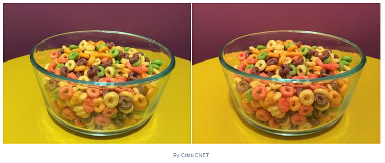

Quality LED's have CRI ratings also . . .
Standard LED's are usually deficient in the Red spectrum.
Here is a photo taken with a Cree LED with a CRI=93 on the right:
