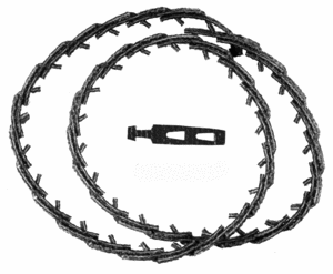

I was in hardware store recently and saw a "link belt". I told the the guy I thought those were temporary kind of like the spare tire in your car thats supposed to be good for 50 miles or so. He disagreed and said they will hold up as well as a regular belt.
Do any of you guys have any experience with this kind of belt?

A while back some guys on the red board were talking about these. They said they had used them with good results. I haven't been able to find out what the horsepower rating on them is. They are called Power-Twist belts made by Fenner Drives.

There's a guy by Waldo who just finished a 59 pto who's going to run those belts.. I'm going to keep an update on how they work out for him. He said he has about 350 bucks into belts for the whole drive system. I've seen them on display at Motion Industries here in town and they look pretty trick. No blower or tensioner adjustments necessary with these. Fenner has some cool products..

I've got those on the shelf right now.
I'm not sure about driving a blower, but they are much stronger than they look, we always just used em for driving the pump cause the blower was direct coupled.
Actually looking back, I would feel comfortable driving a 47 with them, if i had 2 or 3 groove sheave.
They are awesome belts, and when they "blow" it's just ONE link that gives, you can be back in action in 60 seconds with a spare link.
ALso one length of power twist can serve a variety of belt replacements.
You also don't need any tools to replace a belt, they just roll on to a pulley after being sized, there is some technique to it, but it's easy.
After running a brand new belt or belts fora week or so, remove a link and reassemble, this takes the stretch out after they break in.
They are always red, and I'm not sure why we don't see more of them in our industry, except they are more expensive initially.
If you need one, just hollar, I bought a box of 25' awhile back, just know your length.
